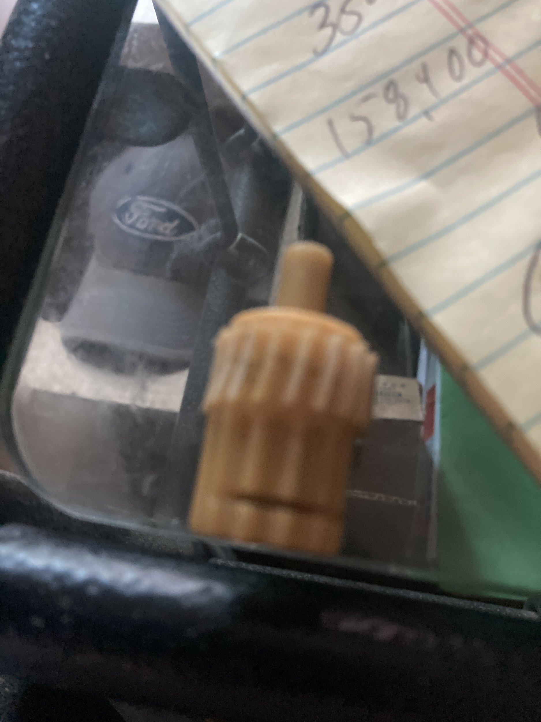

    That may be the problem. This transmission was recently rebuilt before I got the car and I believe they may have put the wrong speedo gear on it, if thats possible. I have attached a picture of both gears and they are slanted different directions. IMG_1812.JPG IMG_1813.JPG

    The gear in the pic is an earlier Fordomatic driven gear not a c6 gear. What side of the transmission doe it come in on? Post a pic of your new gear before install even if you have to PM me to get my attention. I can give you the Ford number for any of the gears from 16-21.

    Driven gear comes in from the left side. I don't have a new gear yet and don't know if it will be any different than what I have. Does the drive gear look like a C6 drive gear? Will a C6 driven gear have a different pitch than what I have?

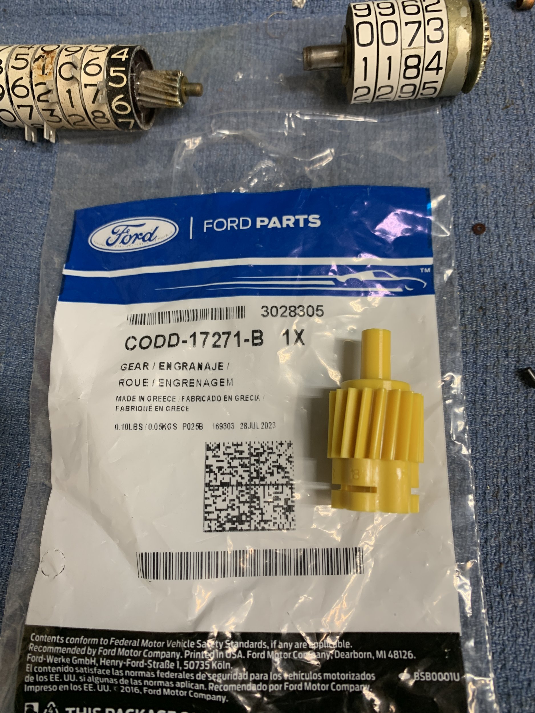

    This is a Ford 18T right hand pitch driven gear. Correct for C4 and C6.
    If you ordered an 18T this is what it should look like.
    You can see the difference in diameter from the Fordomatic 18 T driven gear you had in there.
