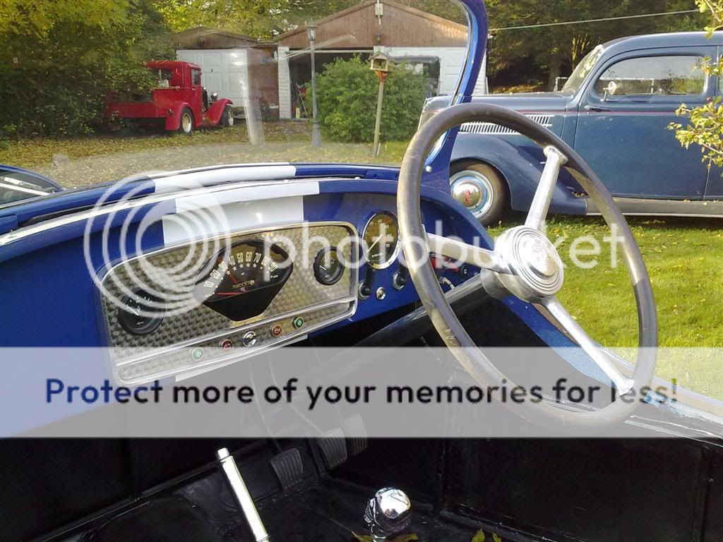

    Is the Speedometer out of a Reliant Regal?
    It looks quite similar, it takes its place nicely, Super Build, Congrats.

    Thanks very much - should be on the road in a few weeks. Speedo is from a 1950's Ford Consul. Dash insert was made in MDF and cast by me a few years ago.
