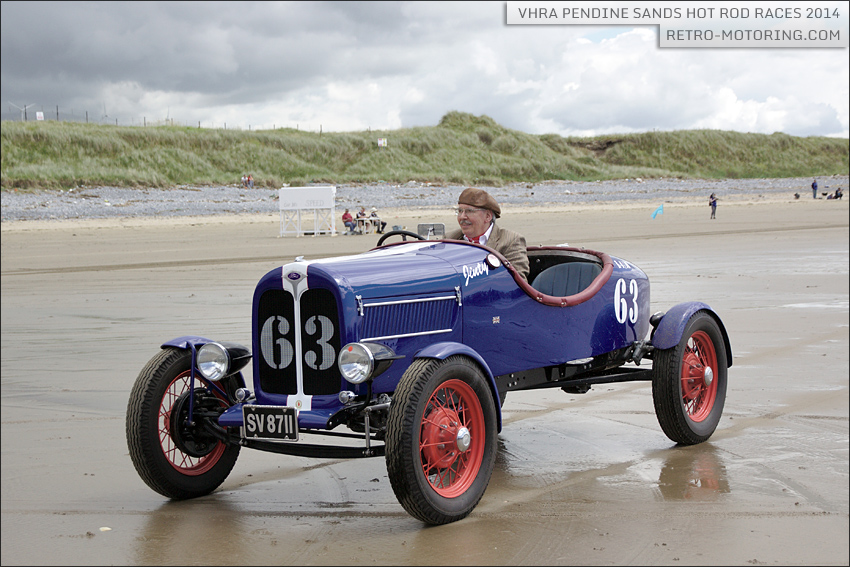

    After a while Archie needed funds for another project so the speedster was acquired by a gent named Neil Bennett – who a****st other things owns a car called the Batten Special which is a serious piece of kit – if you google Neil Bennett 1935 Batten Special there’s lots about it.
    Neil is very tall so some surgery was required to the bodywork so he could fit. He planned to retro fit a Model A four banger in it but that never happened. Neil kept the car for a long while using it mainly for pottering around – although it did have a run at Pendine on the sand.

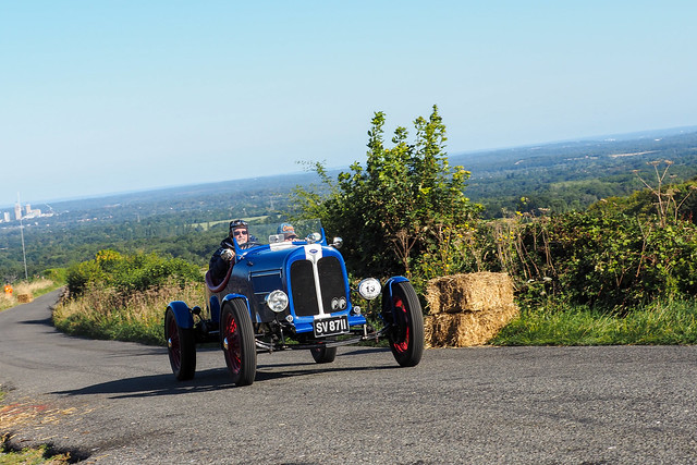

    L4/M 63 Neil Bennett SV8711 - photo by Retro-Motoring

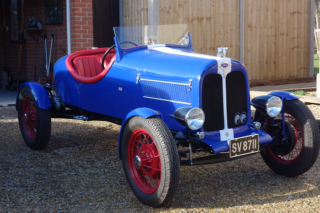

    I acquired the car in 2018 at auction on a bit of a whim and went through the brakes, steering, suspension and alignment. I spent a lot of time getting the castor right replaced the front axle which had been bent . I then turned my attention to the look of the car but I didn’t want to stray too far from Archie’s original vision.
    I had the seats and interior reupholstered, removed the mudguards – but it’s a 5 minute job to put them back on, chopped the screen, and re-did the grille. I also re did the dashboard as the gauges had mostly given up, replaced the fuel tank, refurbed the shocks, new clutch, and lightened the flywheel.
    [​IMG]DSC00172 by andrew atherton, on Flickr
    [​IMG]DSC00171 by andrew atherton, on Flickr
    Car is currently getting steering box refurbed and am waiting for a new front spring from the States but car should be back on the ground and running around again next week.
