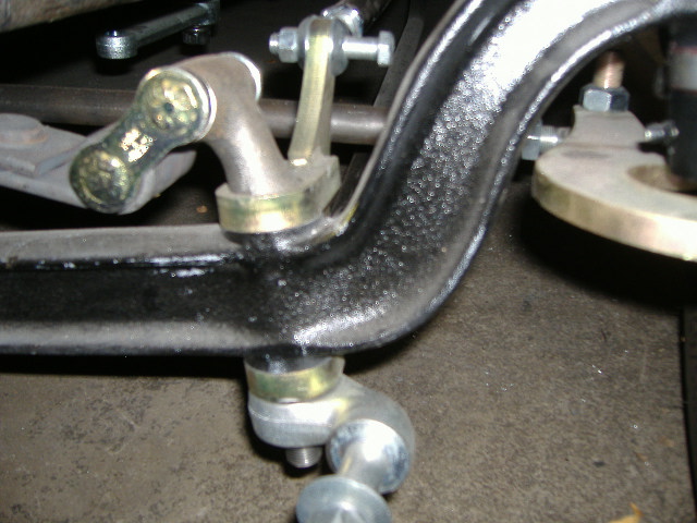

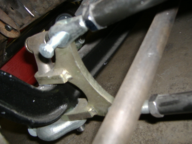

    Damn Larry, I know how you drive that thing, and that pic of your busted 'wings', made MY **** pucker.
  3. Have you contacted Speedway to see what they will do?

    Did you buy them as a polished four bar kit or as individual parts? I am just wondering how you got those instead of the stronger cast ones? John

    As said before I have a set of the polished cast items on the yorkster, and you can see the strength in them cuz of a lot more beef to them. I also have a set of the steel 916-35000 for my 28 sedan and they are built hell for strong. but when I ordered everything I talked to a tech and ordered everything seperate not as a kit form. I always think there is a reason kits are cheaper...John

    Ok before you guys get all wound up think, This bracket failed due to what?
    This is not a weight bearing item, this is a locating part. The load is p***ed thru the tires, to the spindles, to the axle, to the perch pins, to the spring. This bracket is only used to locate the axle front to back. If this is a stress crack it means that something was flexing to create the problem. The first place I would look is to see if the bat wings were the correct size for the axle, the next step is to determine if the perch pins fit tightly in the axle perch boss and then that the perch nuts were drawn up tightening the perch to the bat wing to the axle. If any of this stuff is loose the axle rotates upon braking and would flex that portion of the bracket. Again this is a part that has a rotation point in a bushing or heim end so there is little to no stress placed upon this if those joints function freely.
    I think there is something else that led to this part failure that only would have been masked or taken longer to develop had the part been thicker. My observation is that the perch pin nuts were loose or the axle boss hole was oversize allowing the axle to rotate in the bracket. Over time the axles continual rotation due to heavy braking caused the part to fatigue and break.
