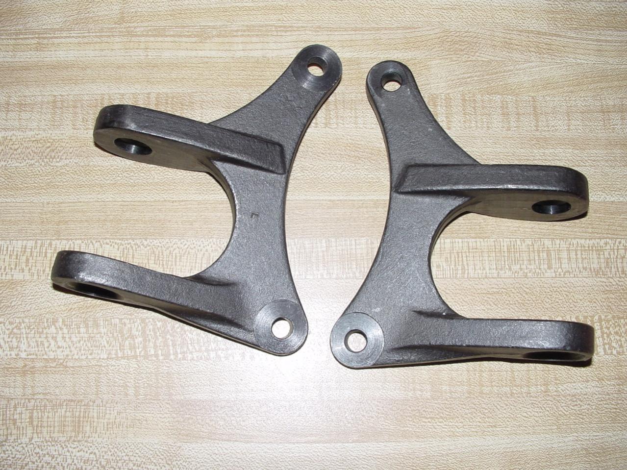

    Not sure who made mine ,,but just what I was looking for,,upright is 3/8 thick and mounting bosses are 1/2 inch,,and they are labeled left and right as there seems to be an angle on them bringing the bottom of the hairpin inward..Neat lil pieces

    theres an angle on the subject Batwings too.
    The only thing i dont like about the ones pictured here(by little wing) is that they use clevis type attachments.(to each his own, im sure theres no problem with this type).I would rather have the larger bushing and bolt going thru both sides of the Batwing//(my prefrence)
    the speedway setup could be improved upon and work well..they just cut a corner., and one that could come back to bite them..or some unsuspecting driver

    I dont think there is a post on the angle..but there is an angle on the on the originally shown batwing too..for it to be possitioned correctly on its side of the vehicle, either it be right or left. ( I thought that is what you were refering to on your last post)
    i went back and looked at the picture you posted, I think we are talking about 2 different things? maybe?

    gotcha,,my whole thing is I did'nt know they were angled,,never used wings and rods before
