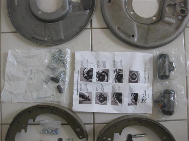

    from nebraska
    I have a Speedway 2" front self-energizing set as pictured which is in fact a Boling Brothers unit. You might inquire as Speedway may offer better pricing &/or shipping, & of course Cornhusker (Teflon) here on the HAMB as well.

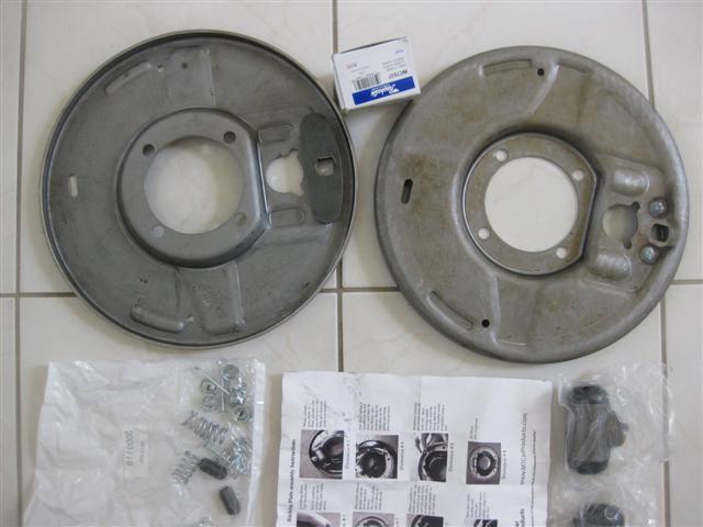

    Budget36
    By looking at the pics posted, I ***ume the brakes aren’t compatible with original backing plates?
    I ask because my ‘46-8 backing plates have a decent old chrome on them.
  12. Mr48chev
    Joined: Dec 28, 2007
    Posts: 36,043
    Mr48chev
    Completely different style of brakes. Nothing interchanges.
    Budget36 likes this.

    from DSM, IA
    The self-energizing "guts" will not fit a OE backing plate. The top half where the wheel cylinder and the lower halve where the adjuster are located are shaped differently - albeit similar in appearance.
