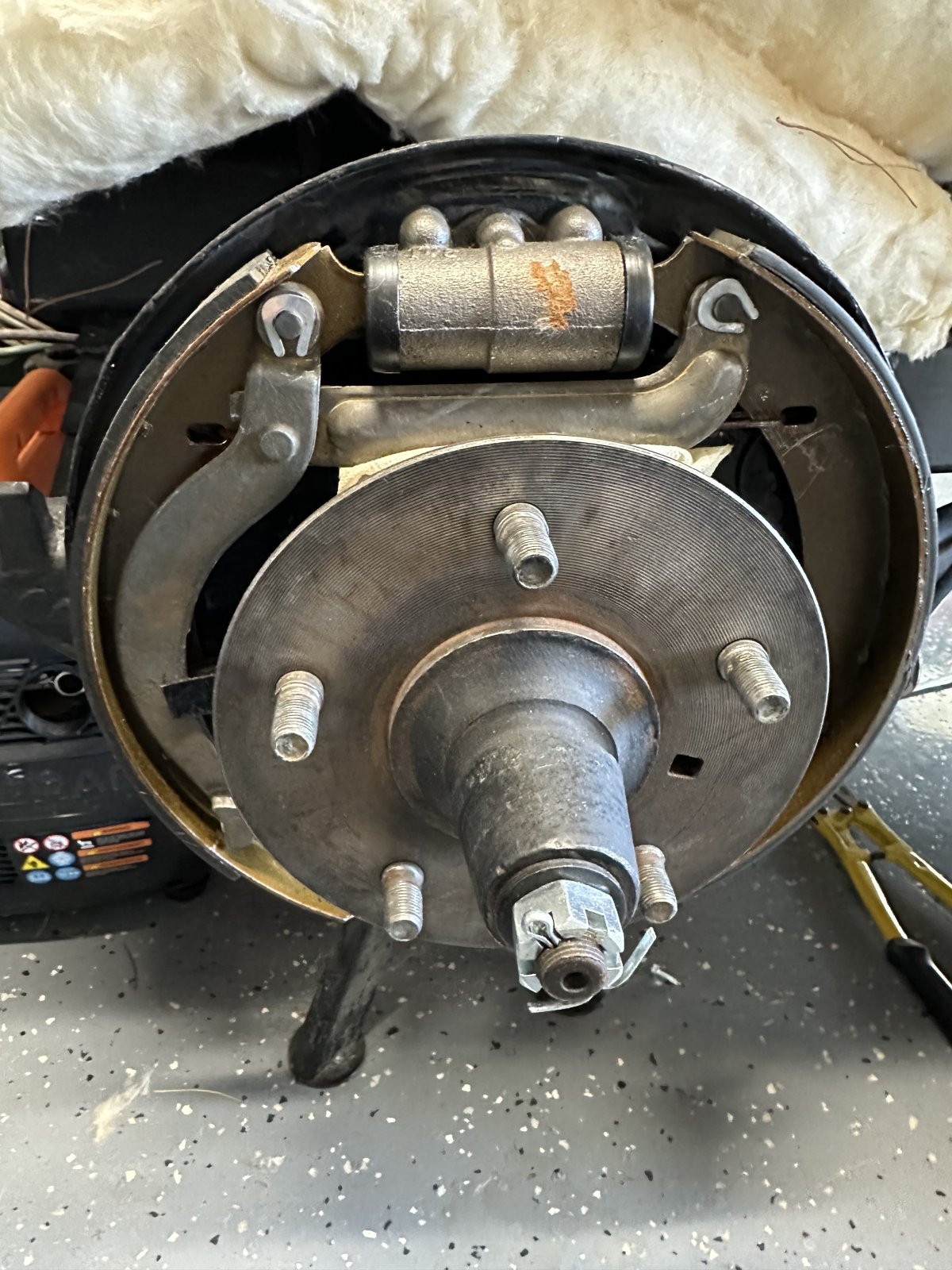

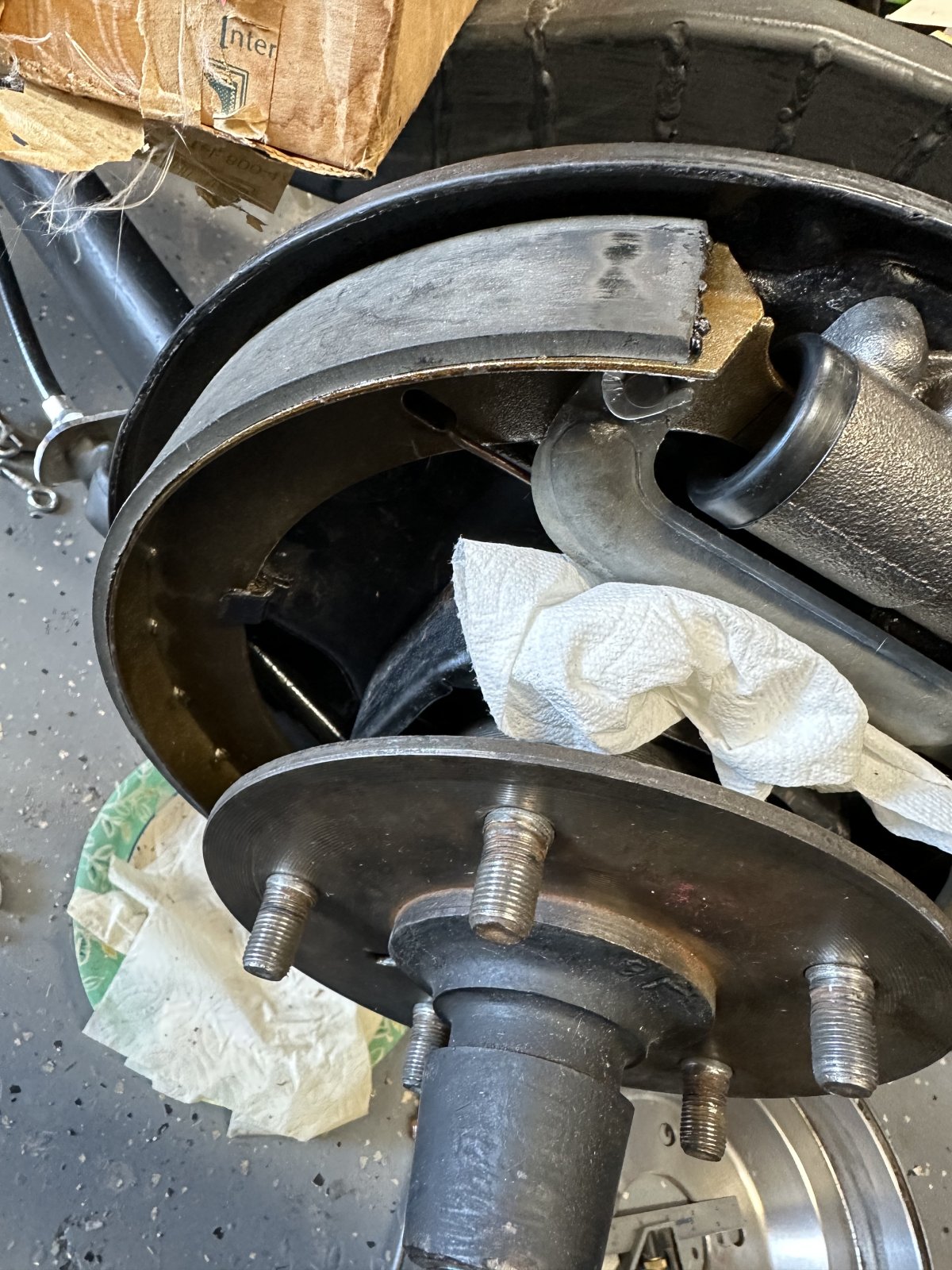

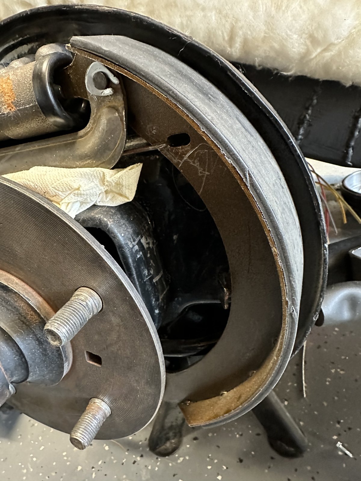

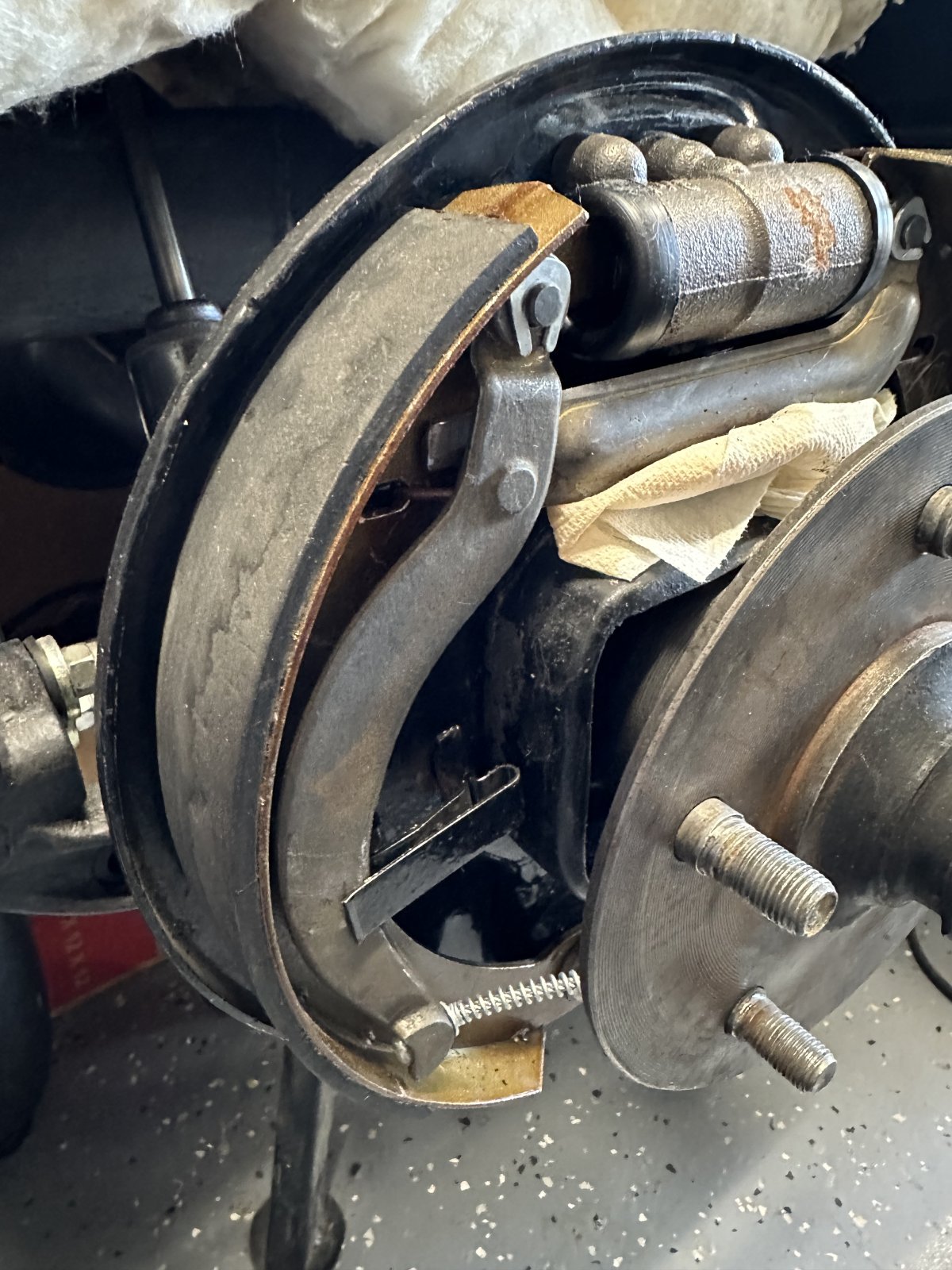

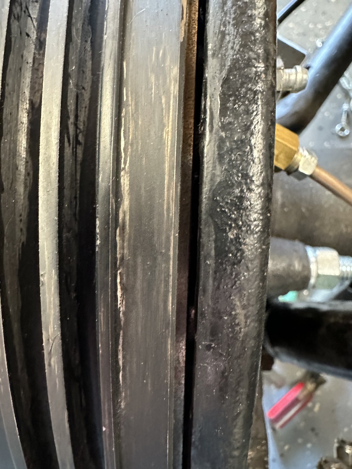

  8. 29ron
    Joined: Feb 18, 2009
    Posts: 260
    29ron
    87B31B01-B659-478B-A9F7-39A6CAF10D87.jpeg D65293D8-CEEB-432B-9EAB-BA7328A3B13E.jpeg

    Here are some pics. The shoes stick out about 1 1/2” and the drums are 2” deep. It looks like it’s hitting the pads at the top. I already had the drums turned 2 times. They slide on easy.
  10. Dan Hay
    Joined: Mar 16, 2007
    Posts: 6,473
    Dan Hay

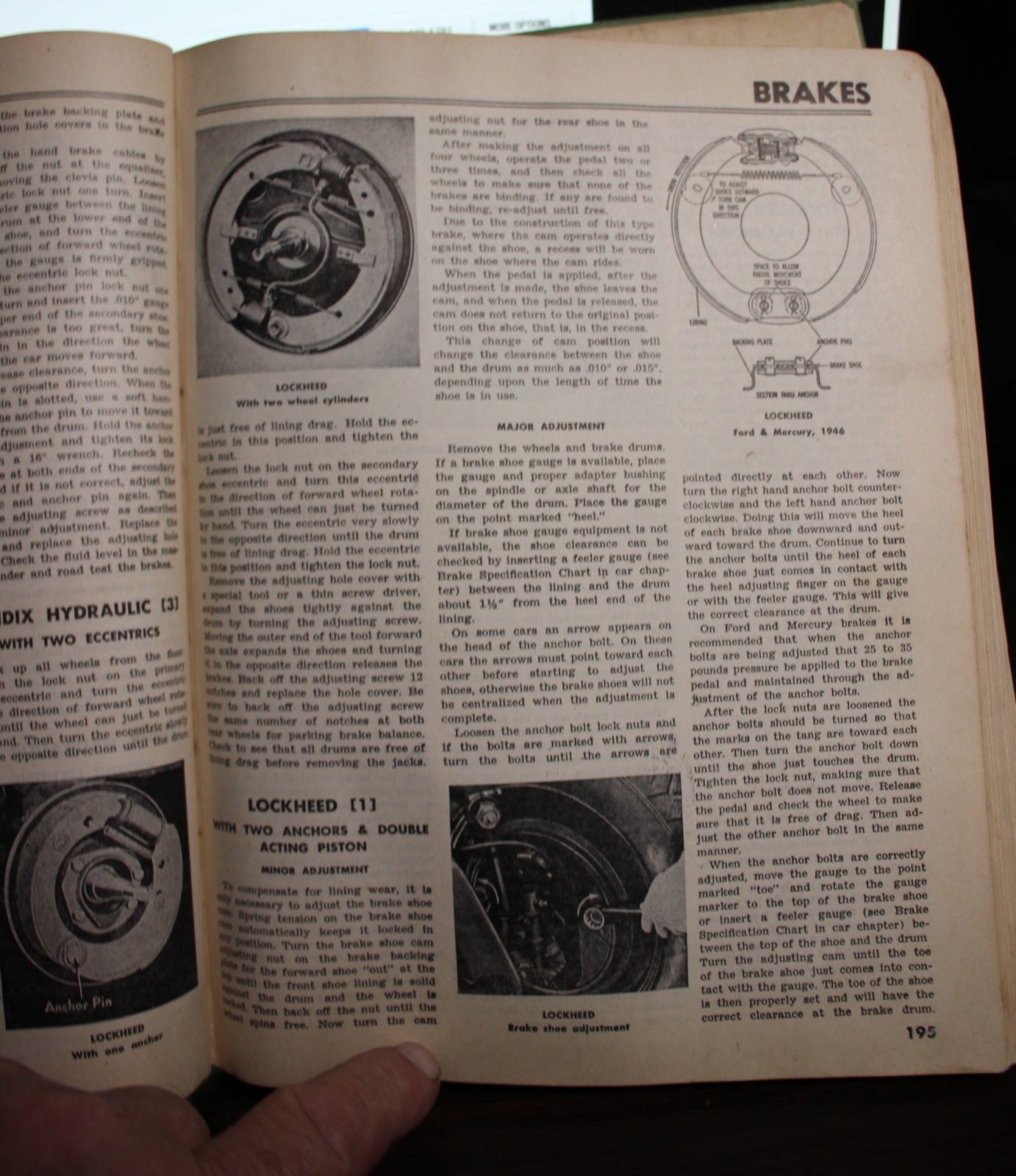

    Looking at yours and looking at a tired loaded 40 backing plate I have it looks like your shoes are riding a bit high on the backing plate.
    I took a photo of the pages in my 1946 Motor manual that tell how to adjust them but one page may not be too readable. 40 brakes too high (2).jpg IMG_7608 (3).jpg IMG_7610 (2).JPG IMG_7623 (2).JPG View attachment 5632127

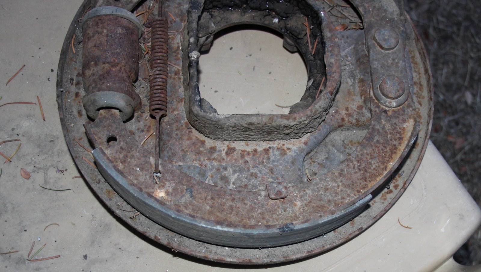

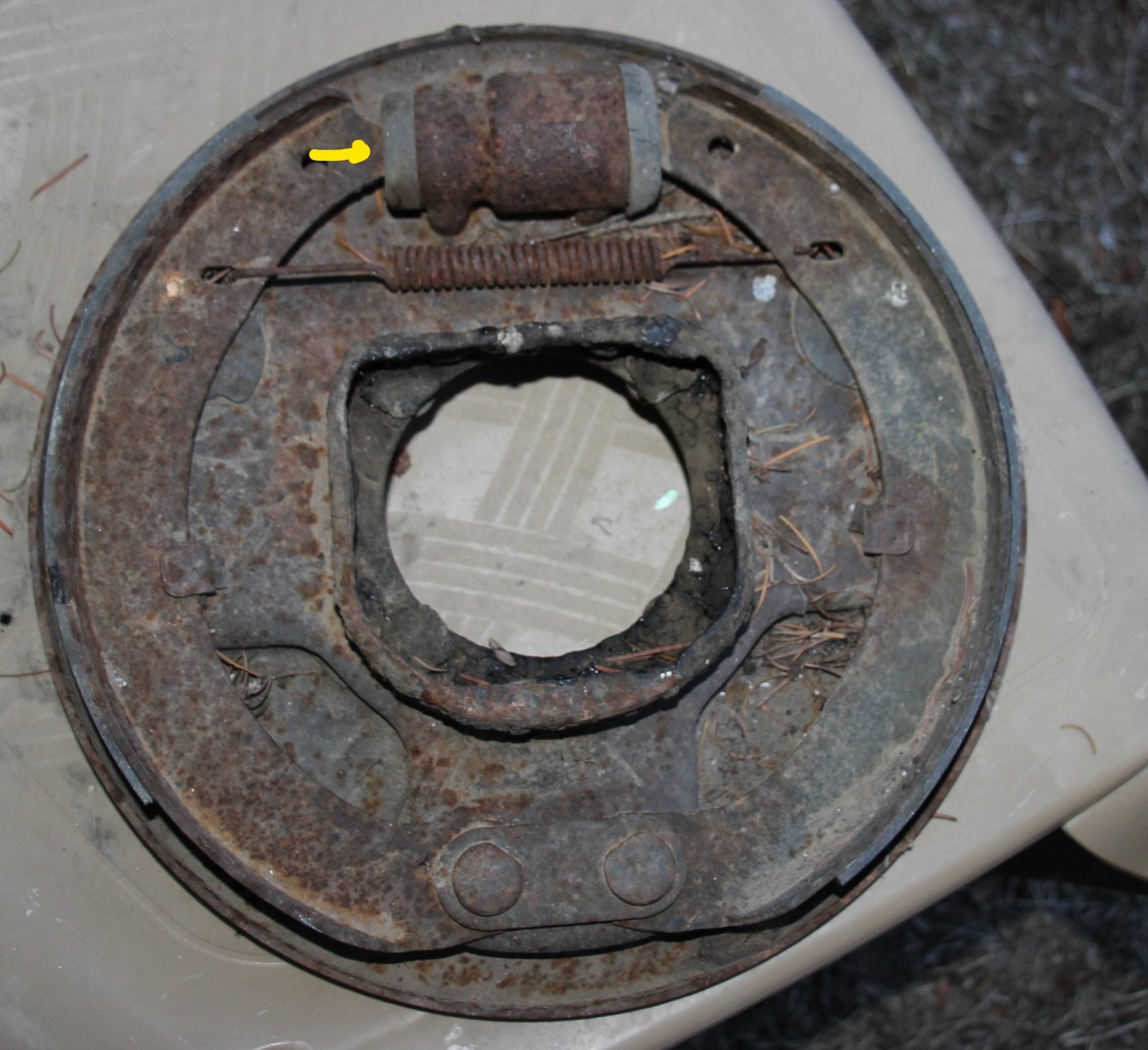

    My rear Speedway drums were hitting the backing plates. Turns out the backing plates were the issue.

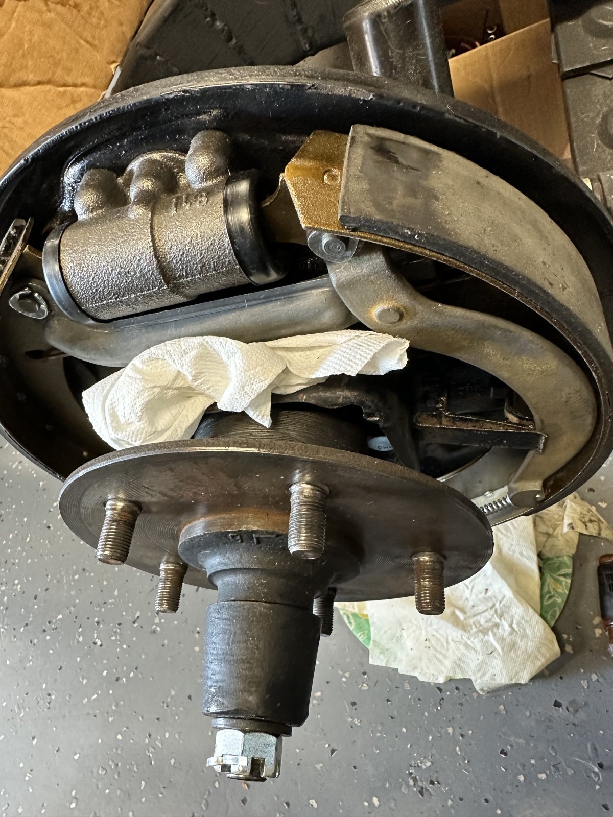

    I have the backing plates like the ones pictured. I’m not sure what they are off of.

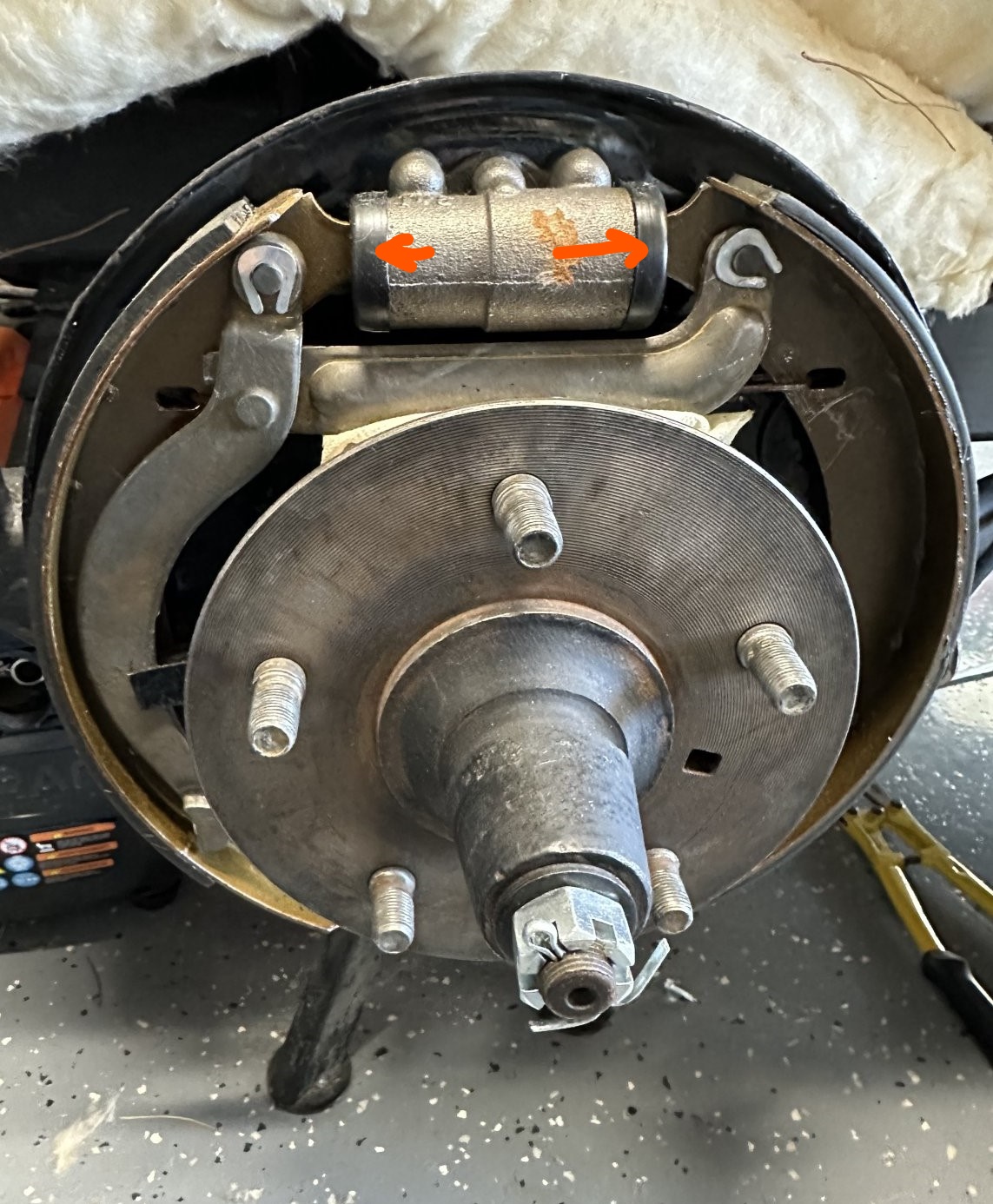

  22. 29ron
    Posts: 260
    29ron
    Thanks everyone for the response. I have the older style backing plates. I’m not sure what they were off of as this was all pieced together. From what I can tell it’s not rubbing on the back plate but it is rubbing on the tops of the shoes on both sides.

  24. 29ron
    Posts: 260
    29ron
    I have the lower adjusters and the upper ones set as you suggested. The shoes are all of the way in. It appears that the shoes are riding high.

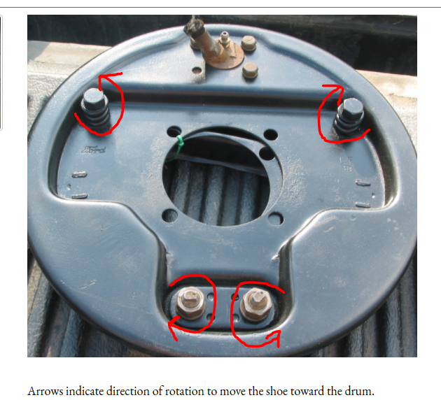

    you have 39-41 Ford brakes. for crying out loud do not cut your drums again, the eccentics raise and lower the shoes. It is a somewhat complicated process . here is how you do it
    ************* ADJUSTING BRAKES **************
    ADJUSTING ANCHORS ON ’39-‘41 FORD/MERC BRAKES: These are Ford Lockheed
    (not Bendix) brakes and use special br*** washers in conjunction with
    eccentric anchor bolts to position the shoe. The top of the shoes are
    controlled by eccentric cams. The anchor bolts at the bottom of the
    backing plate control the shoe position by rotating eccentric washers at
    the bottom of the shoes. Before starting to adjust, verify all anchor
    bolts turn freely.
    The ’39-‘4 use anchor bolts which have locating marks (either a dot or an arrow
    for position reference) indented on the elongated ¼” head of the bottom adjusting
    bolt. These anchor bolts extend through the backing plates from the drum side
    and are adjusted externally after loosening their large external lock nuts.
    After adjusting the shoes, the adjustor lock nuts are tightened without
    permitting rotation of the anchor pin adjusters.
    (1) Always rotate the wheel in the same direction the wheel turns as when the
    car moves forward.
    (2) Begin by backing all the way off, the two 11/16” eccentric adjusters at the
    top of the backing plate until the wheel turns freely. Then slightly loosening
    both bottom anchor bolt lock nuts (3/4”) on the back of on backing plate. Turn
    all of the two elongated locator marks (either an arrow or a dot) on the 1/4"
    adjusters so they face each other.
    (3) Further adjustments are made by turning the anchor bolt adjusters in a
    SPECIFIC direction.....
    (a) Driver’s side. The front shoe anchor ¼” adjuster bolts (with
    the dot or arrow) on the both the front and rear wheels are rotated
    counter-clockwise when looking at the back of the backing plate. The rear
    shoe anchor ¼” adjuster bolts (with the dot or arrow) on both the front
    and rear wheels are rotated clockwise. This is VERY important.
    (b) P***enger side. The front shoe anchor ¼” adjuster bolts (with
    the dot or arrow) on both the front and rear wheels are rotated clockwise
    when looking at the back of the backing plate. The rear shoe anchor ¼”
    adjuster bolts (with the dot or arrow) on both the front and rear wheels
    are rotated counter-clockwise. This is VERY important.
    (4) Now turn one of the upper adjusting 11/16" eccentric cams until the wheel
    cannot be turned. Adjust its 1/4" anchor bolt in the correct direction until the
    wheel just does turn. This lowers the shoe and moves the toe of the shoe away
    from the drum, which will result in fuller shoe contact.
    (5) Repeat step (4) over and over on the same shoe until turning the anchor bolt
    will not free-up the wheel.
    (6) Back off the upper anchor pin very slightly until the wheel will just barely
    turn. Tighten the anchor pin lock nut (3/4”) and then adjust to the other shoe
    on that wheel.
    (7) Thereafter, it’s common to never needing to adjust anything other than the
    top eccentric cam.
    TIP: If you’re installing new shoes, which have been arc-ground to fit the
    drum, you normally will not have to go through the preceding exercise. Turn the
    dots/arrows until they’re facing towards each other and tighten the ¾” anchor pin
    nuts. This correctly positions the brake shoes and you don’t have to go through
    the anchor pin adjusting..... just adjust the upper 11/16" cam adjusters.
    ADJUSTING ’42-’48 BRAKES: The anchor pins are different than the ‘39-
    ’41 Lockheed brakes, but do not have any reference marks on the backside
    of the anchor bolts. And they adjust differently. Instead they have one
    flat side ground on their large round shallow bolt heads. The flat sides
    are turned so they face each other. This is usually al the adjustment
    needed due to the semi-floating design of the anchors. Tighten the large
    nuts (which are on the inside of the brake drum)and put on the brake drum.
    Adjust the upper eccentric cams and you’re through.
    sko_ford, dmar836 and Tim like this.
