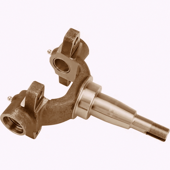

    Hey all, I'm asking around because I asked Speedway Motors and I'm still unsure. I'm looking at using their '49 to '54 Chevy spindles and their advertising says the geometry has been changed to complement radial tires. Yet I'm not sure how... change in camber? Also, not sure if this would cause premature or uneven wear on the bias-plies I plan on using.
    Speedway 1949-1954 Chevy Car Modified Spindles w/ King Pins

    They are made to be uses with their T bucket Tube axle. won't fit a Stock 49/54 Chevy if you are trying to replace a bad spindle. I'm thinking that they won't work with anything except their house brand tube axles that are made to be uses with them.

    The spindles that he is asking about are new forged spindles from Speedway that have had some changes from the original Chev design but if you squint a bit the still look like 54 Chevy car spindles.
    Remembering that somewhere along the line Total Performance (T buckets) had a hard time sourcing 49/54 Chevy car spindles from wrecking yards on a reliable basis and started having them made. Then comes the fight with putting disk brakes on the stock design spindles and either Total Performance or later Speedway made some changes so the disk brake hubs slid right on with no mods. Meaning Ball bearings for stock brakes won't fit. King pin inclination was changed because it worked better with the tires most T bucket guys wanted to run. As I said in my previous post most likely they only work well with their in house brands of tube axles.

    Digging though my ancient Speedway's catalogue it mentions their 49-54 Chevy car modified spindles are "not for 49-54 Chevy cars" (?). Looking at the spindle chart it mentions that for the "Total Performance style spindle", the axle boss length and pin size is different than stock spindles used on 49-54 Chevy cars. On the front-axle page, only the "Total Performance" retro fit front-axle uses Speedway's 49-54 Chevy-style spindle. It doesn't mention if the kingpin inclination was changed at the spindle or at the axle boss or both.

    Ask "Ron Pope Motorsports" , he builds axles & furnishes speedway spindles . If they're " radial friendly" , they may have increased negative camber ? I'm betting its more marketing hype than any significant geometric change .

    Speedway has been selling axles & spindles for quite some time , in the past , they sold brake kits that fit their modified 49-54 chev spindles ,OR stock chev 49-54 spindles that the user / builder would then have to modify . Those modifications did not include any meaningful " geometry" changes other than a slight ,MOL insignificant change , in scrub radius . And FWIW , speedway sold out of & no longer has available , any of the TP acquired inventory , including spindles & axles , or any replacement compatible parts .

    Early Ford KPI is 8* and I think the ‘49-‘54 Chevy spindles are 4*, Total said they improved the spindles for the motorcycle style wheels popular on their T-Buckets. I take that to mean that TP changed the KPI to give a better scrub radius with the ‘cycle wheels.
    Speedway then modified that statement to say “….changed to work with current radial tire construction.”
    That spindle takes an Econoline .742 king pin and although Speedway’s catalog says it will mount common GM and Ford disc brake kits I would verify that statement with them- the only kits I see listed in their catalog (mine is a 2021 edition) are priced from $680 to $765.
    Either my reading comprehension is f;&#ked up or they need a better copy writer. The only brake kits I see listed is the 835-140150 and their ‘151 and ‘152 offerings.
    Apparently even their tech guys don’t know what works with what, but one thing is certain, you will be locked into Speedway’s front axle as @Mr48chev said, and maybe
    Speedway’s (with Wilwood components) brake kit if you buy those spindles.
    Edit- As long as you would be buying spindles anyway buy early Ford style, whether original or repro and save yourself some headaches.

    Once again, digging through my ancient Speedway catalogue, "if " (and it is a big if) the "49-54 Chevy car modified spindles" listed in the spindle section are the same as the "Total Performance spindles" mentioned in the spindle chart, the changes to the spindle would be:
    Being machined to fit a disk brake kit (can't use stock hubs or bearings), a longer axle boss length and a smaller spindle pin diameter. I believe this is why the "49-54 Chevy car modified spindle" won't fit a stock 49-54 Chevy.
