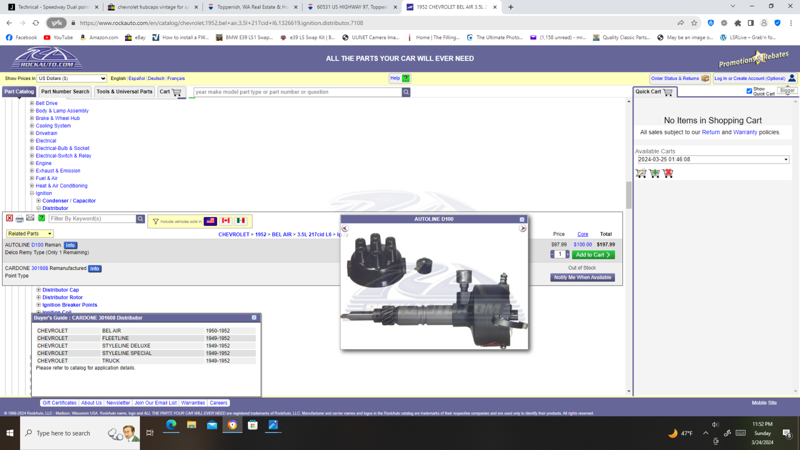

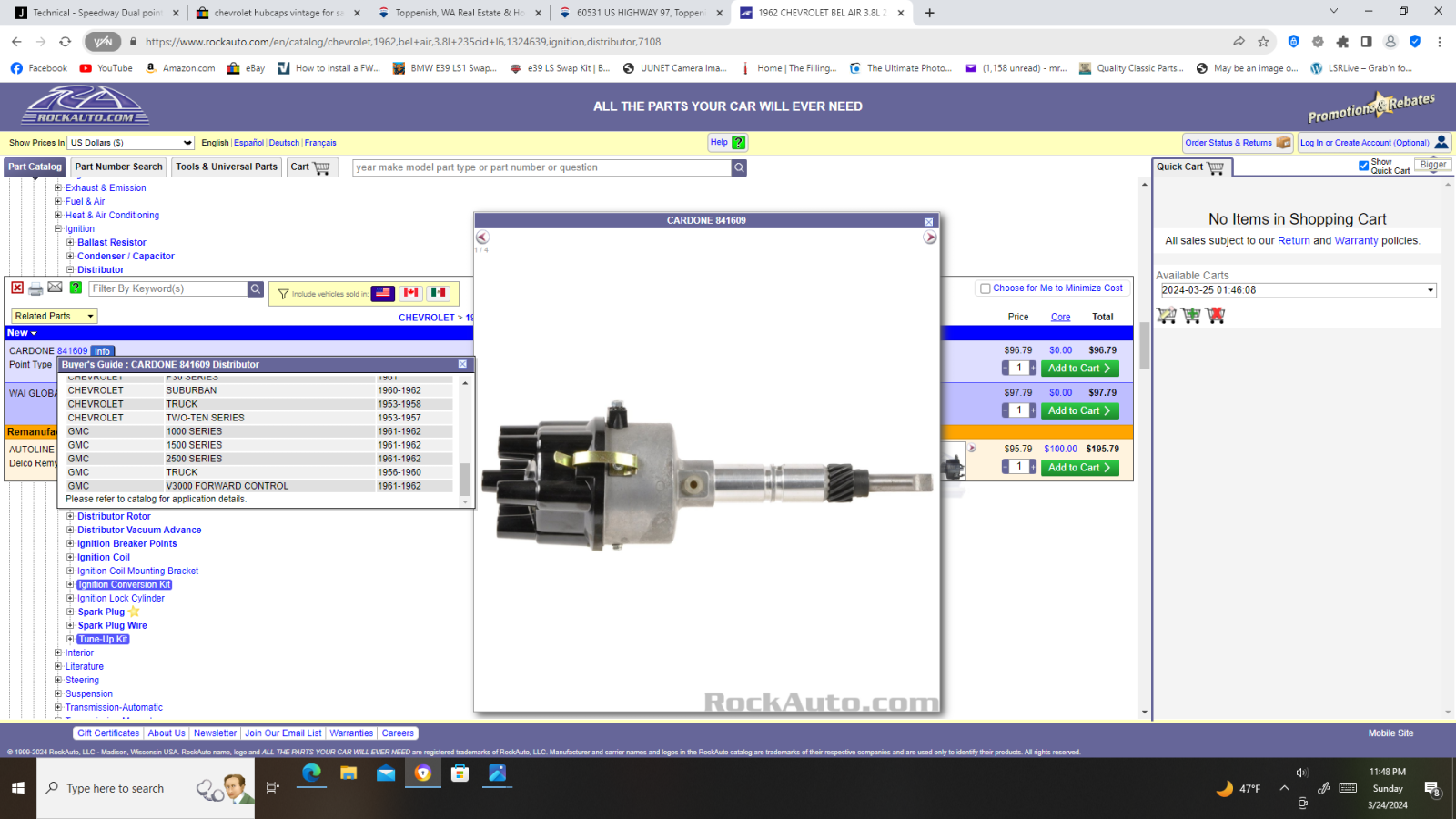

    Rock Auto shows their rebuilt distributor for 235 as fitting 53 through 62.
    37/52 and actually some 53 would be 216 or dipper oiled 235.

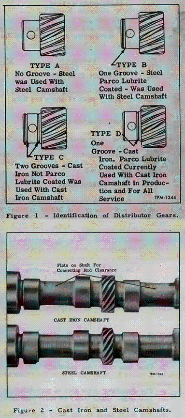

    Chevy 216/235/261 distributor gears.
