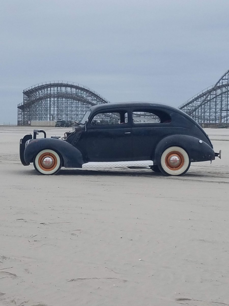

    We had a great time at TROG this year. Got to hang out with a bunch of friends, got to make some new ones and see a ton of great cars. Everything was going awesome till we decided to take some pictures with the roller coaster in the back ground, My buddy Steve and I pulled our cars out to good spot to take the photos. Took the photos and then it was off to get something to eat and a beer. as we were driving back to the exit the, the car bouncing along in the sand, I heard a thump, then stopped moving. No grinding sounds, no catastrophic failure explosion. We couldn't fix it there anyway so Steve took me back to the hotel to get my truck and trailer and we pulled it up on the trailer and decided to look at it later, and just went and got some grub. Later I pulled the hub cap off the p*** side rear wheel thinking maybe I sheared an axle key. whe I popped the cap off a big chunk of metal fell out onto the trailer. To my astonishment, the frreaking hub had broken apart, woodruff key pointing up.

    from Woburn, MA
    Man, I'm sorry to hear that!
    I got to see your car on the beach though and it looked GREAT.
    I took a picture.
