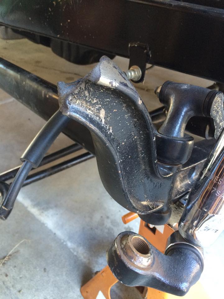

    There are numerous photos on here that would refute that - just saying
  17. Jason was not being honest with you. Well maybe he was, perhaps he meant that they never broke one. :rolleyes:

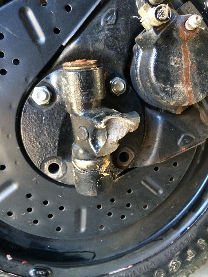

    OH REALLY?
  20. hotrodA
    Joined: Sep 12, 2002
    Posts: 7,795
    hotrodA
    YIKES!!
    That ain't good.

    Wow, that's some terrible stuff there!! I hope everyone was okay!

    Maybe they are just forging the shape on a cast axle? I don't know much about this, but that pic does not look forged. Why so porous?
  25. I think the pic was or is a cast Super Bell.

    Yes the picture is a broken SuperBell axle.

    i'd like to know a bit more about the axle Russco posted....it looks like it twisted first before breaking?
  29. As I recall Super Bell had a bad run of axles. Seems like we discussed that a year or two back.
    A cast axle can work well for everyday driving as long as it is a good casting. if it is a poor casting, it will be lucky to work on a roller.
