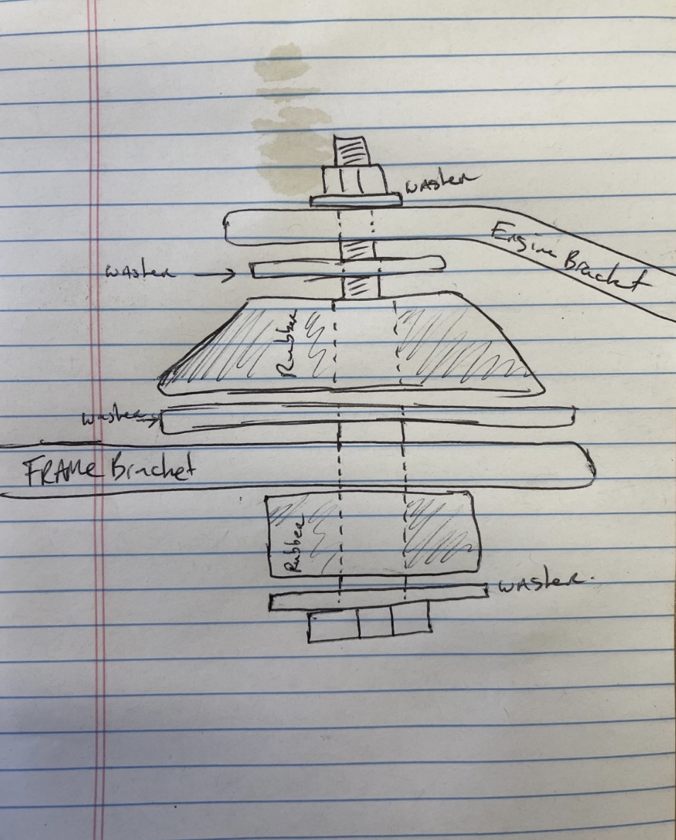

    Sorry not sure where to post this, anyone using the speedway front mount bracket that uses the rubber biscuits? They want the lower rubber bushing shoulder to sit in a 1” hole which centers the mount. Ive seen a post where the kept tearing away being as its only like a 1/8 high shoulder. I was thinking about just drilling a 7/16 hole that the mount bolt fits through and the bolt would then do the centering and weld a smaller washer inside the large washer that sits under the upper bushing so it centers on the bolts as well. So frame bracket would still be sandwiched by upper and lower rubbers but would be centered by the metal bolt. I think I may get very slightly more vibes this way which Im fine with but is the an unforeseen issue Im not thinking of?
    Also has anyone run the bracket “backwards”, with mounts on the rearward side on bracket?
    Thanks for any help!

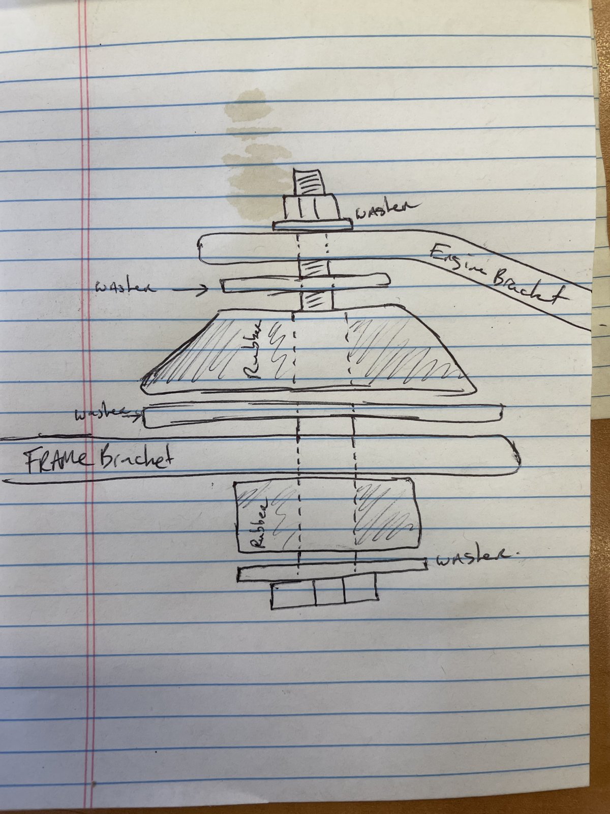

    Being in Canada getting these parts is expensive and takes forever so Id like to use what I have. This is what id end up with. Its only a 300hp application and i have no holes in frame bracket yet so can drill a 7/16 so through bolt is a close fit for centering. This is what id end up with, probably not quite as much dampening but damn close I imagine

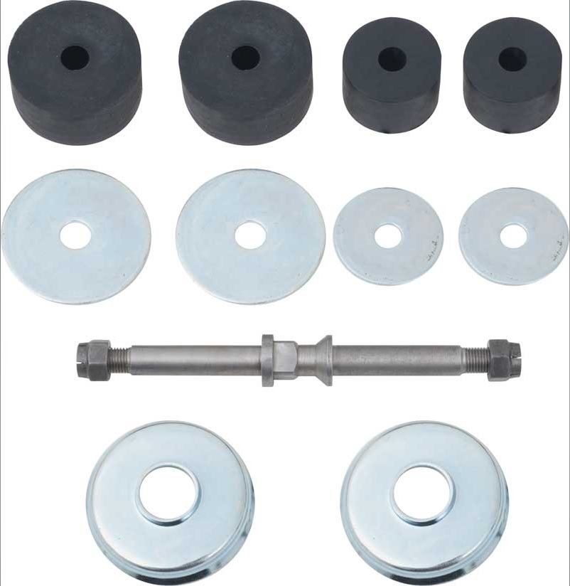

    this is another approach, if you can find some used washers from a 55-57 chevy car or 55-59 truck. The rubber parts used to be readily available in the normal parts stores. Maybe they aren't any more, though.
    https://www.oerparts.com/product/tf700110.html

    Gold star drawing. I’m hanging this on the frig for everyone to see. IMG_2487.jpeg

    Im sure whatever way I decide to run this it will be fine and Im just over thinking it. I think Im gonna go with the approach of using the bolt to center it in the frame (7/16 hole) as it looks like that is what the chevy mounts pictured did (can tell by rubber hole vs bolt holes size)z

    The chevy mount has a large hole in the frame, and the steel washer has a flange that fits in the large hole The outside of the rubber biscuit is centered by the outer flange on the washer.
    You can do what you're planning, it will work good and last a long time, but it's not how motor mounts are made on production cars.

    Don’t let the through bolt be rubbing on the frame’s hole. It will transmit vibration and eventually rub a groove in the bolt or the mount.
    Ford had it right by isolating the bolt via ridged washers holding the rubber biscuits.
