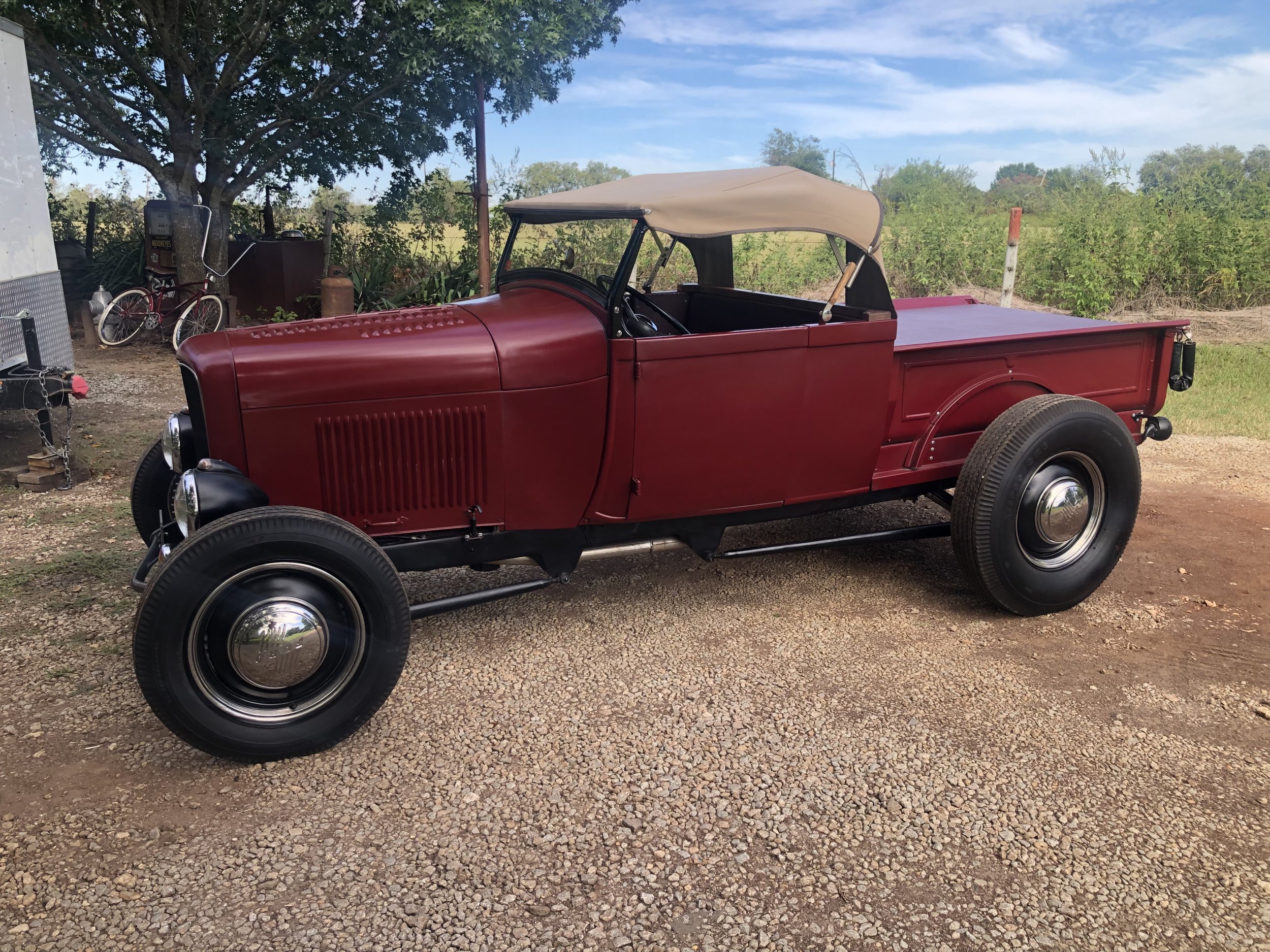

    I'm putting one on my roadster now. It comes with thumb screws to pinch into the top posts. I replaced them with knurled knobs from a '36, and I opened up the hole in the back of the windshield post so they actually thread into the post so there's no way it can lift up. I did a lot of cutting and welding on mine to get it to fit my 3" chop and get the profile I want. I also added a rear bow like a "bop top." It's at the trim shop now with a bunch of vintage photos so he trims it the way they used to be done, so I don't have any final product photos for you yet.

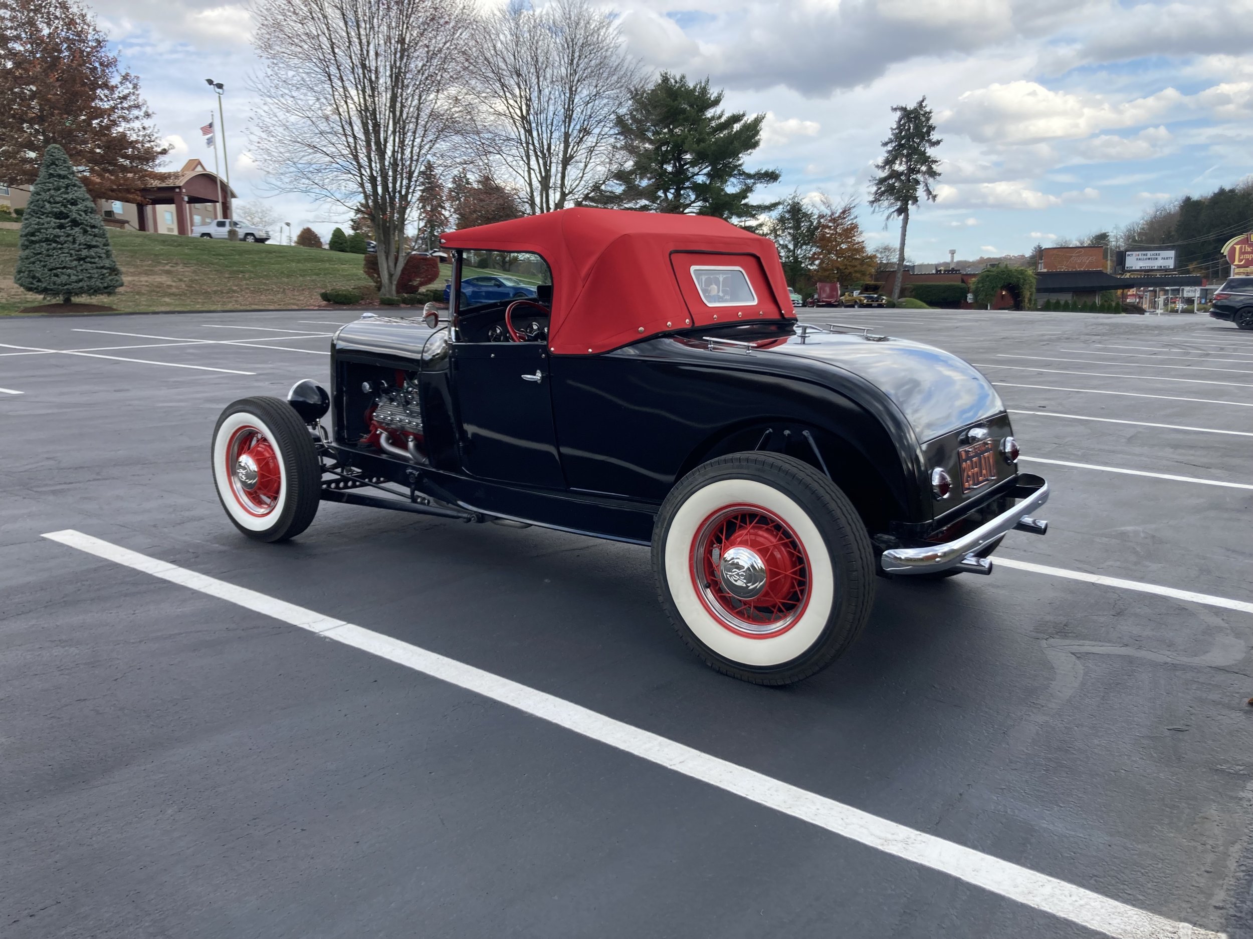

  5. Automotive Stud
    Joined: Sep 26, 2004
    Posts: 4,399
    Automotive Stud

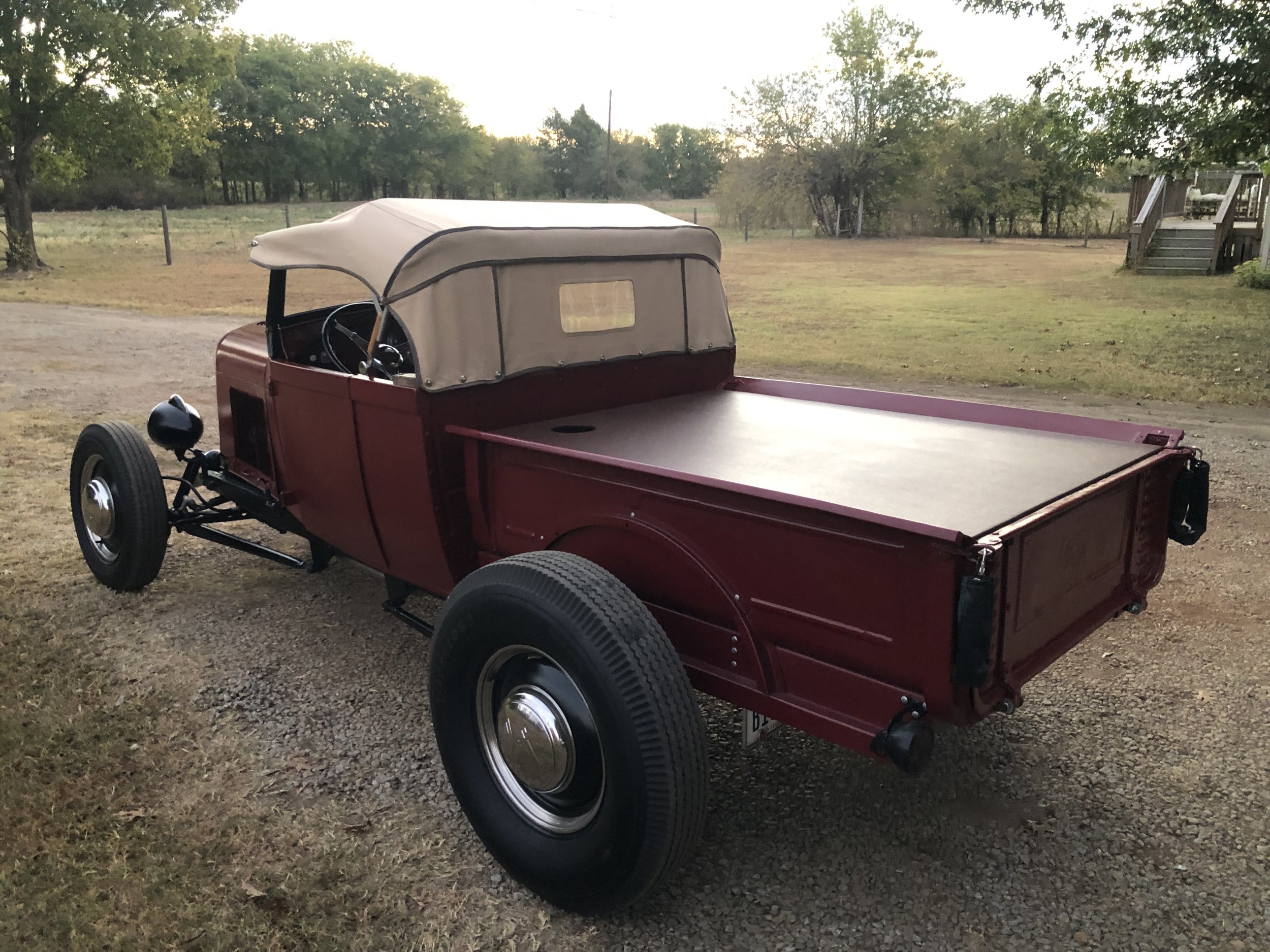

    I did finish mine. I'm not crazy about how it came out, but I think it was more my upholstery guy than the top frame. I've got another guy lined up and we're going to take another stab at covering it again. I don't like the shape of the side window and it's too droopy between the bows even though it's drawn tight. 20190730_201901.jpg

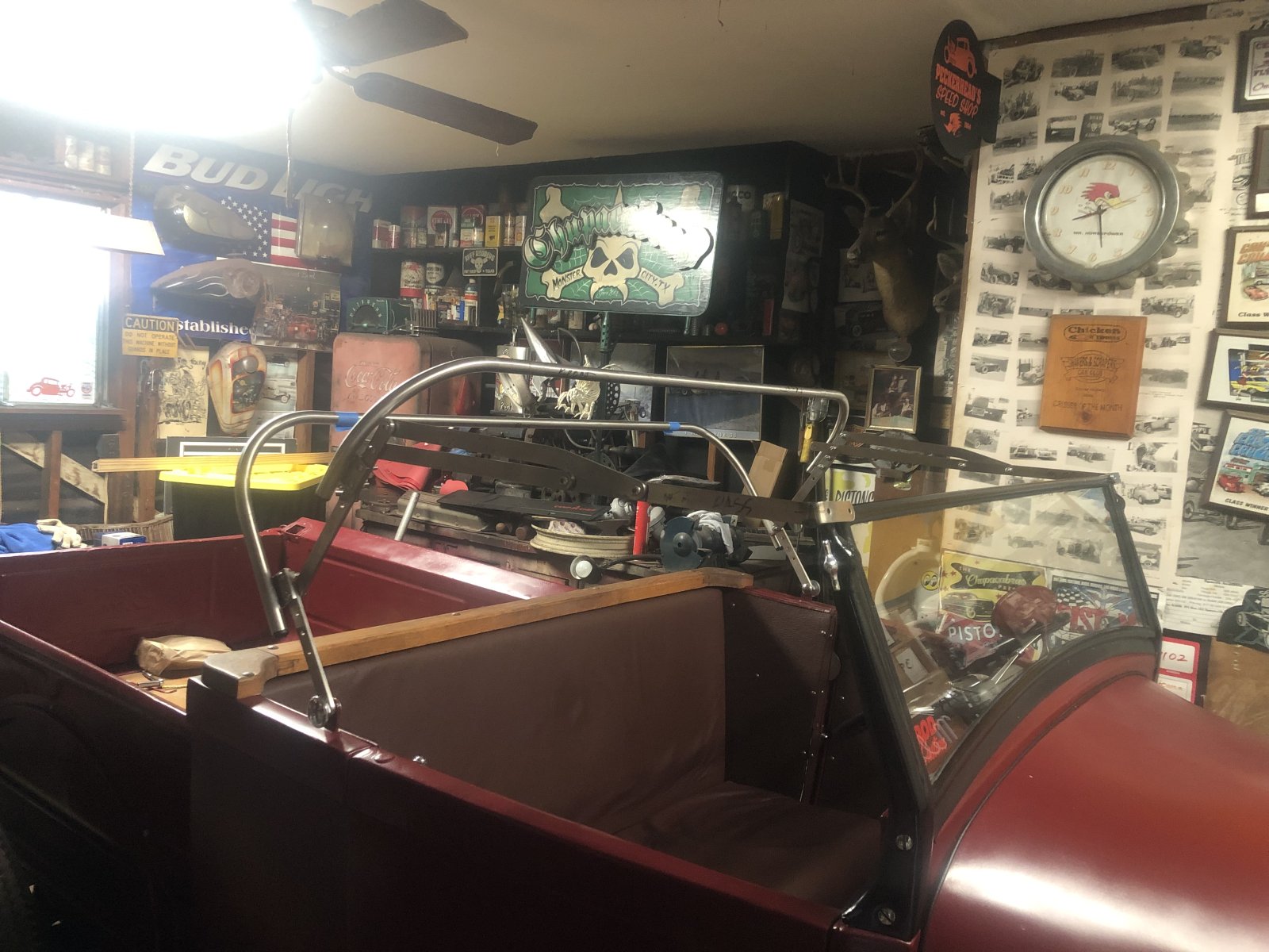

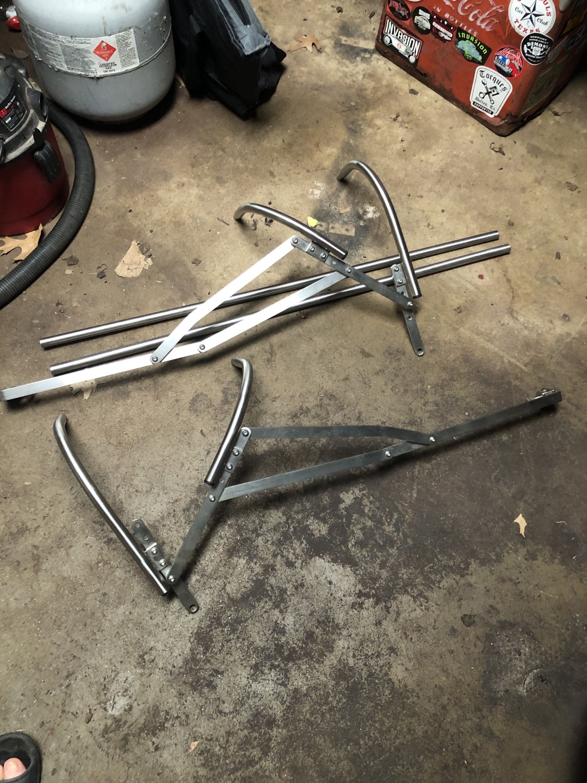

    I bought these stainless steel kit at the Lone Star Roundup Swap Meet in Austin Tx for $250 . I’m going to have to do the same thing on mine, 3” Chop and leaned back stanchions. What rear window are you going to have? image.jpg IMG_1376.jpeg

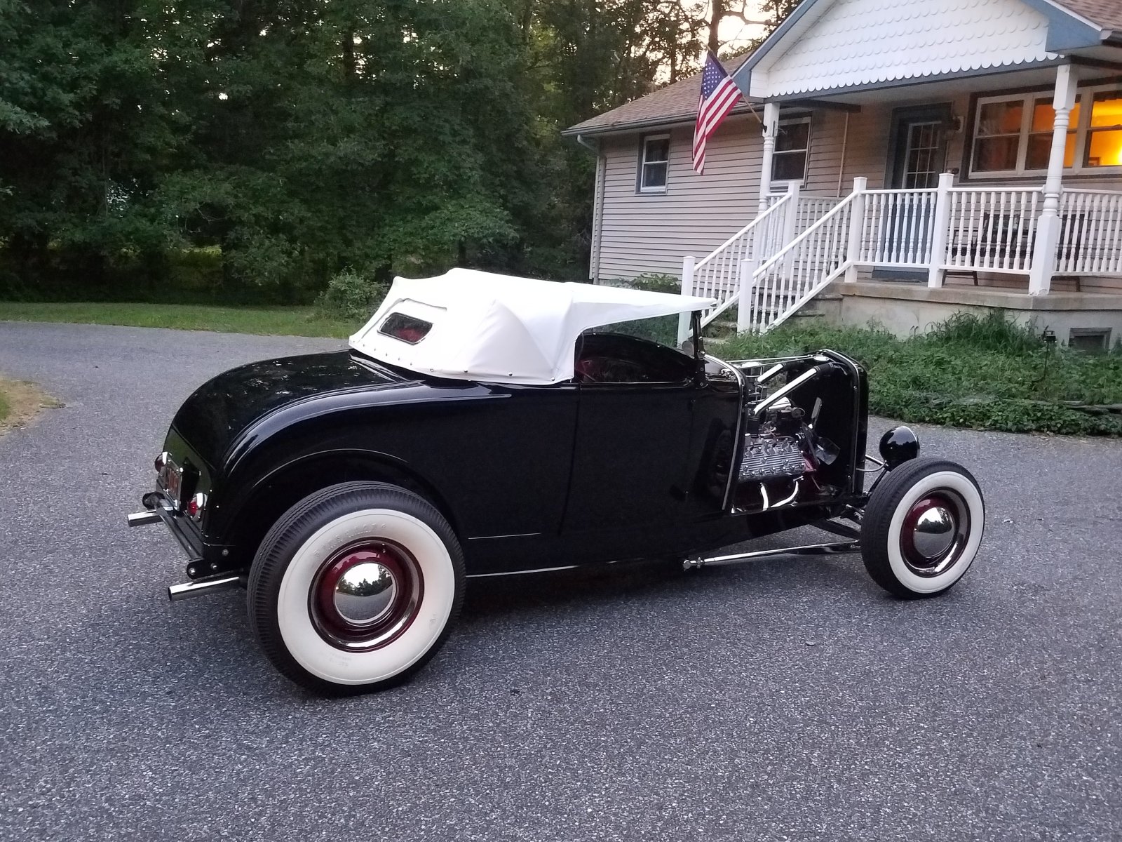

  12. CSPIDY
    Joined: Nov 15, 2020
    Posts: 1,119
    CSPIDY
    I’m hoping to run the original back window from the original top that came with the car

    Mine is still the same as the last picture I posted. I'd still like to reupholster it but I haven't done it yet.

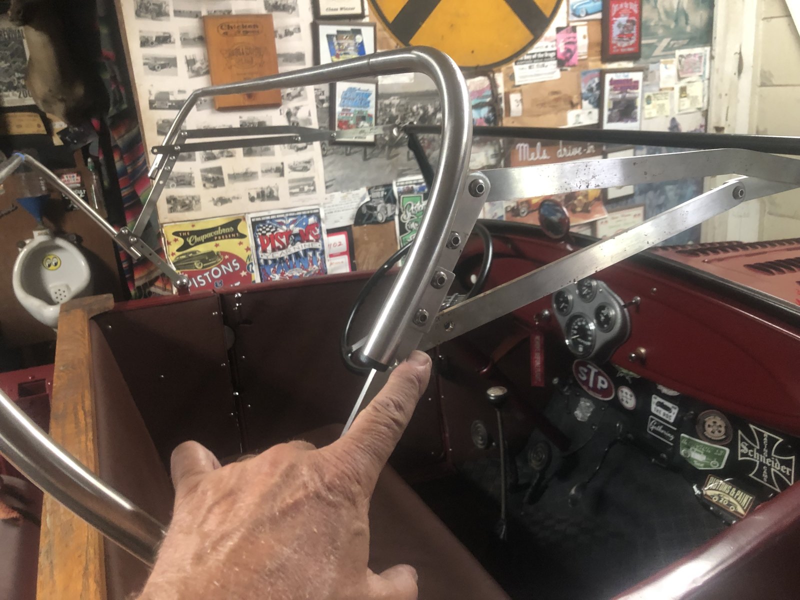

    73983404715__2663B34C-19FF-4D29-AEDD-9965E81312CF.jpeg IMG_2614.jpeg The 2nd pic shows how most people do this bottom bar. It’s too low to get in and out, is it ok to do like the top picture?
    Malcolm and CSPIDY like this.
  17. pprather
    Joined: Jan 10, 2007
    Posts: 9,243
    pprather
    Just be careful, does the loss of triangulation affect the strength or stability?
    The look is fine

    I would say see if it still folds in that arrangement and then grow it and shake the **** out of it and see if it moves any more than the other way. I would guess it’s about the same.

    Thanks, Im not planning on ever folding it. It will either be ON or OFF.

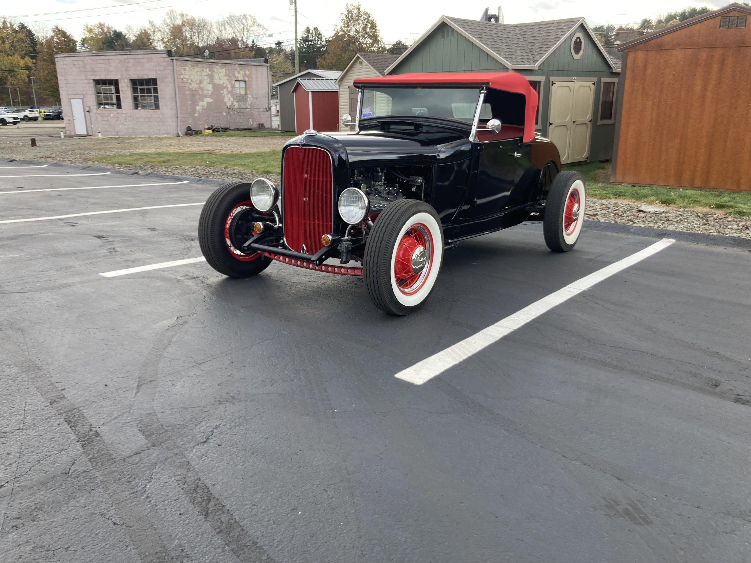

  27. Automotive Stud
    Posts: 4,399
    Automotive Stud
    Sure what do you think?
  28. ALLDONE
    Joined: May 16, 2023
    Posts: 4,041
    ALLDONE
    there's a basic formula for these tops, and how to make them eyeball friendly first, the back hoop has to be taller than the wind shield header... and the center hoop needs to be taller than the rear hoop.. just a little... next the rear hoop needs to slightly tilt in ,... too much and you loose head room and drive around with your chin in you chest cause your head it's the top.. tilted out and it looks like a T bucket top...
    this is the tough part... making it fold down behind the seat... and not sticking out on the deck lids... those that know, know thats why the 27 ford had the stake pockets moved back so the top woould lay down...... a lot of preference and discussion goes on between the owner and builder....and a good builder will tell you what happens when you do what you want before they are done
    so on to the canvas... you have to sew the darts in... and you cant stretch canvas on the bias... or it duck bills and sags,, looks to me like they took a standard top... and trimmed it to fit the lowered frame???? so now the side window isn't level with the window seal...
    so on this car if you look at the snap where the two hoops meet,... you can see that it is pulling on the bias and ****ing the dip in the top..
    these cars are very hard to do right... till you do a few... then you know the no no's and the hell yeah's
    MindTraveler64 and warbird1 like this.
