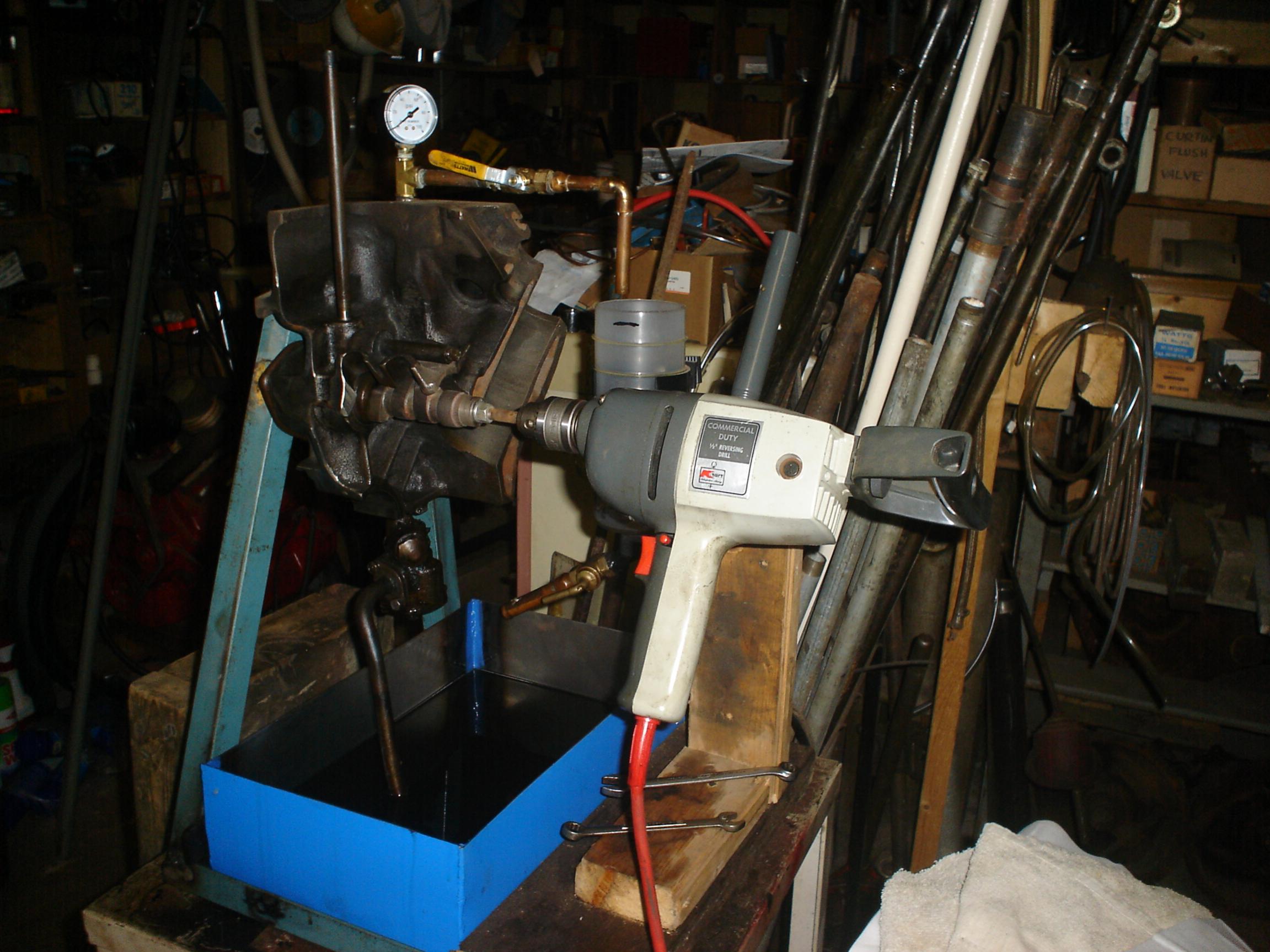

    I don't own or work at a test lab, but I did build my own oil pump tester. Cut the rear section out of an old block and rigged it so I could power it with a drill. Works really well. Most of the old pumps I've tested work just fine. I don't think think they are a high wear item, but I stilll want to know before I put one in an engine.

    I have a setup to test oil pumps and almost invariably the old stock pump is right up to the task. I wouldn't trust the one you have in the engine.
