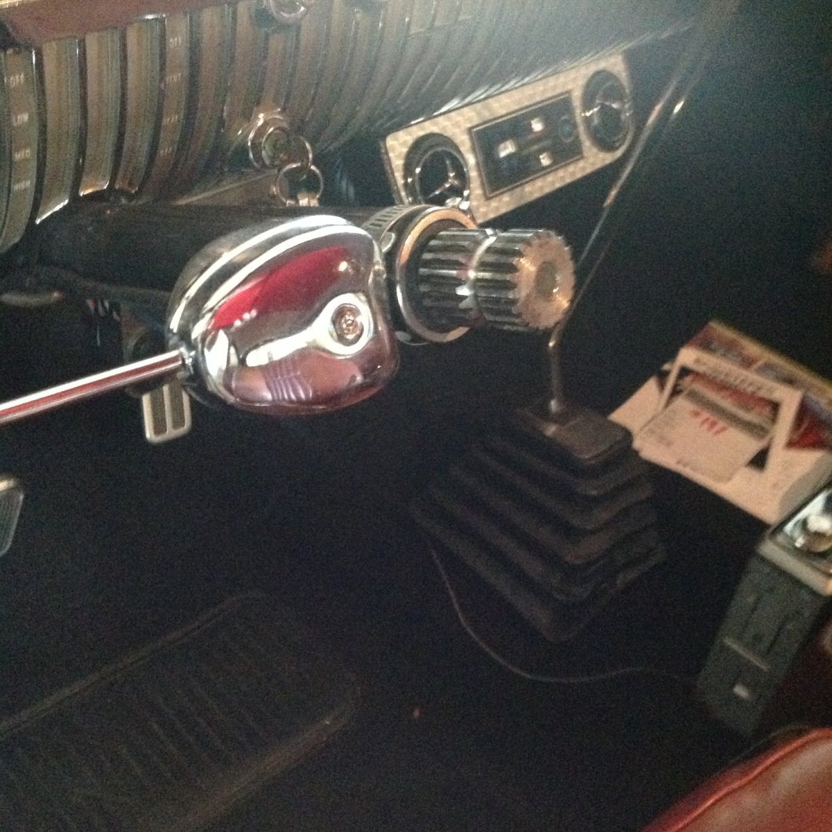

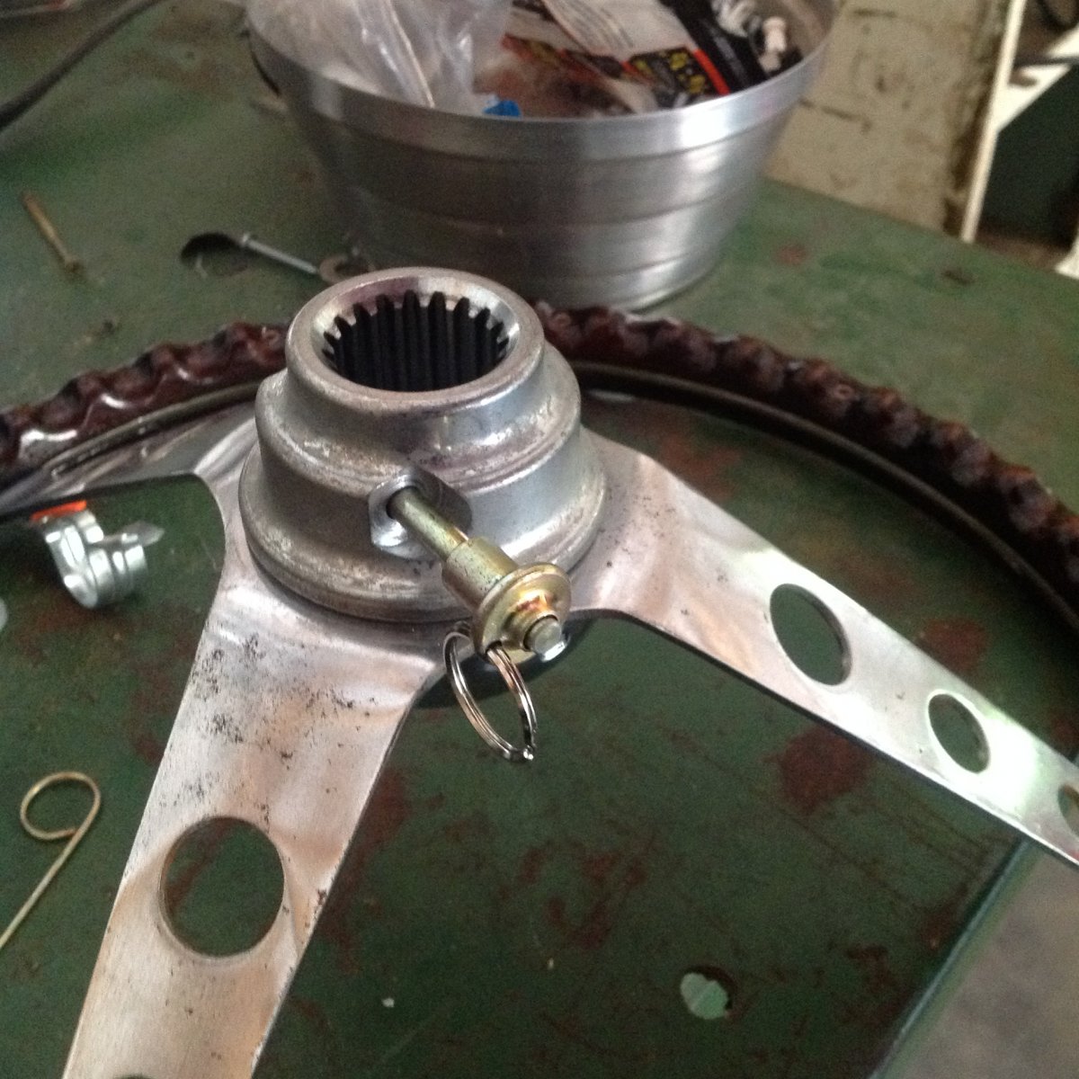

    I need some advice, please. I will be getting the 3 hole Limeworks 16 inch Forty steering wheel for my Merc. I have the Speedway Nostalgia column, which I don't care for, but I'm running with what I got (hey, I'm cheap). I hate the slack in the hub and is not pretty on the eyes, Should I get a hub that welds on to the shaft? Is there a cover that I can buy that goes over the 3 hole hub to clean up the appearance or is this something I would need to fab myself? If so I will weld the quick disconnect hub I have now.

    basically I wanted to do away with the quick release hub without replacing the column and also make a taper from the back of the steering wheel to the column so it looks cleaner. I'll try and post some photos later. I didn't think it was necessary as I'm sure someone on here has done this already.

    I have that same column. I had the same problem. I solved it by making a saw cut in the coupler in between the holes for the pin. Put a 1/4" bolt in place of the pin and tighten it up. This makes a clamp out of the coupler and tightens the wheel up on the shaft. It is no longer quick release but it's tight.

    I also had the Speedway column with the disconnect and also bought the quick release hub that you pull up a center ring from the backside. Looked the same, same # of male/female grooves but was just a hair off from fitting, Got out my hand file and in 15 minutes or less (your times may vary) I got it to slip on and lock. Now if I yank up hard on the wheel, it has a 16th or so slop up and down, but you don't know it when driving.

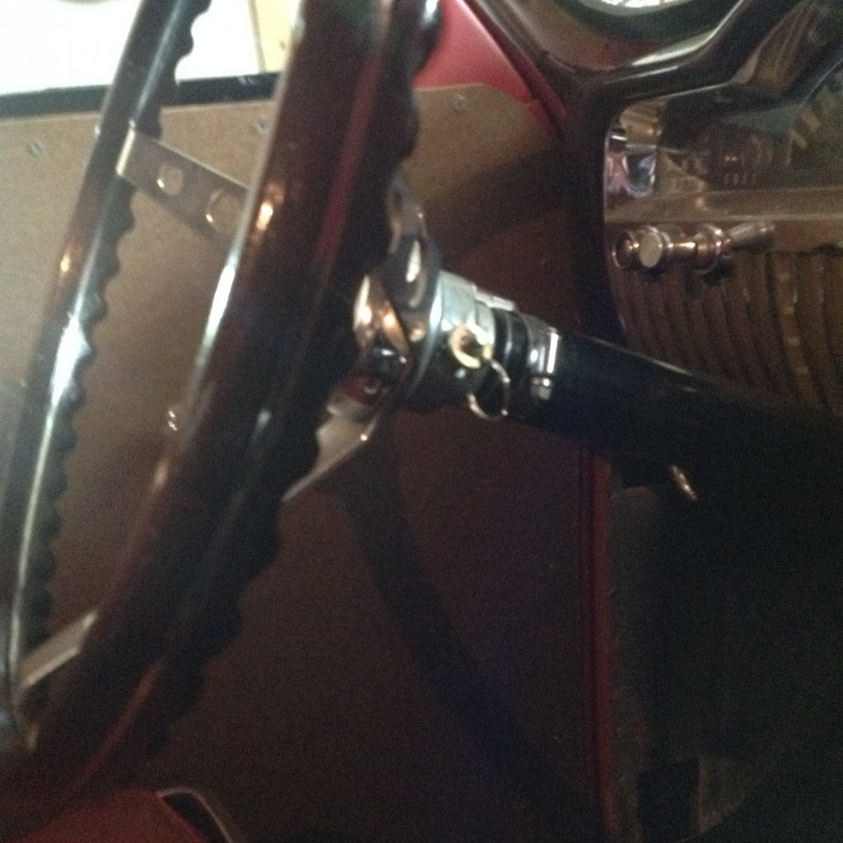

    also bolted one on .cut a hole in a stainless martini shaker lid from wall mart jb welded it to the column looked a lot like a 40 bell

    Richards stuff used to sell a 40 wheel that bolted to a 3 hole adapter have one on the wifes 100_0541.JPG truck i'm not sure it wasn't just a vintiqe wheel with 3 holes drilled in it
