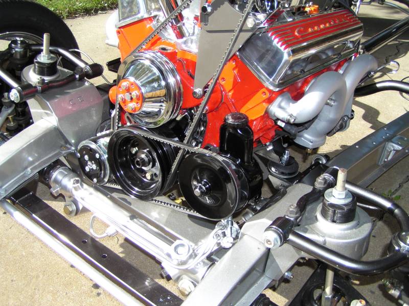

    I have a pair on my 37 Chevy coupe. they tuck in quite a bit but not as much as block huggers.
      101.3 KB
      415

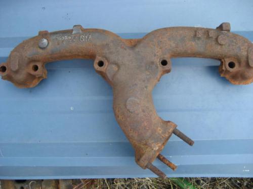

  8. What about truck rams horns ? The ones that turn slightly towards the rear rather than dumping straight down. Or are you trying to get away from stock type manifolds ?
  9. billygoat67
    Joined: Jul 13, 2007
    Posts: 341
    billygoat67
    nhbamndit is right, i have a set in my attic and the dr side does dump out back alittle and curves twards the rear. might fit better. they are off a 70 chevy pu i believe.

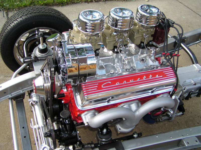

  11. Like this...
  12. billygoat67

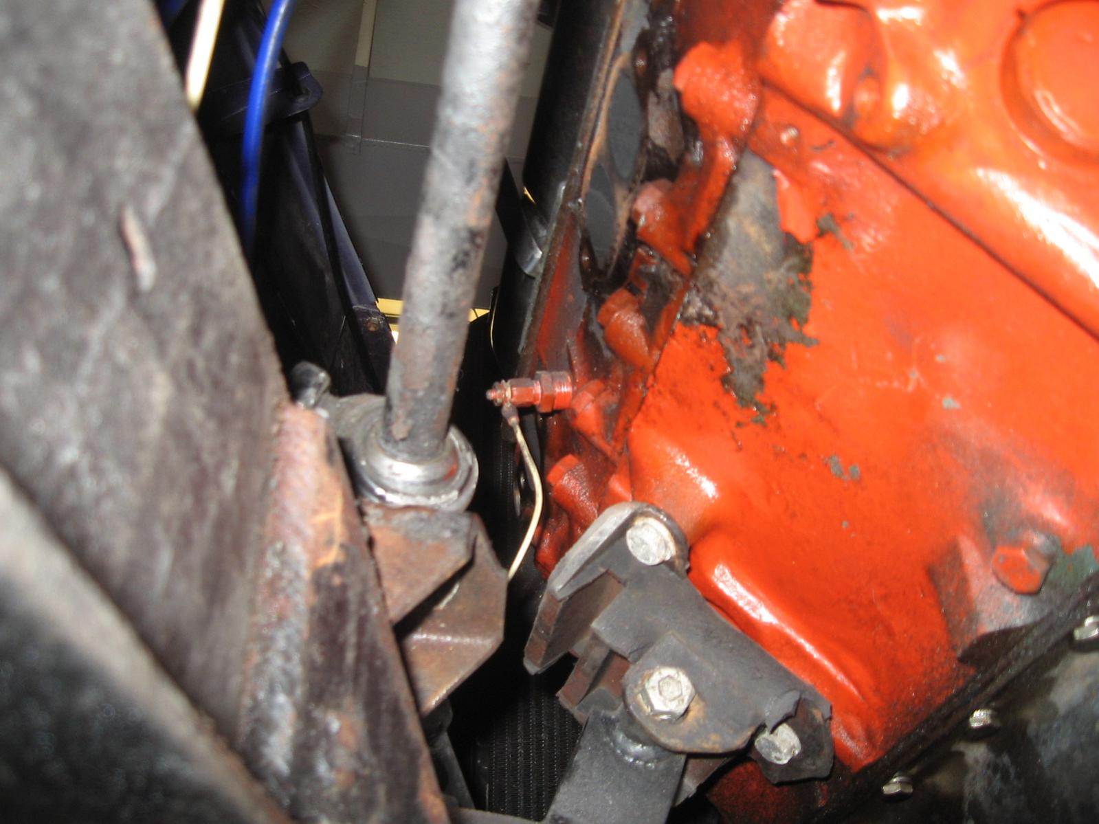

    I had heard that truck headers would fit because they exit to the rear Great photo by the way. Here is a pic from the bottom. I hope you guy's can see it.

    Man, that is a sweet set up. You are cranking

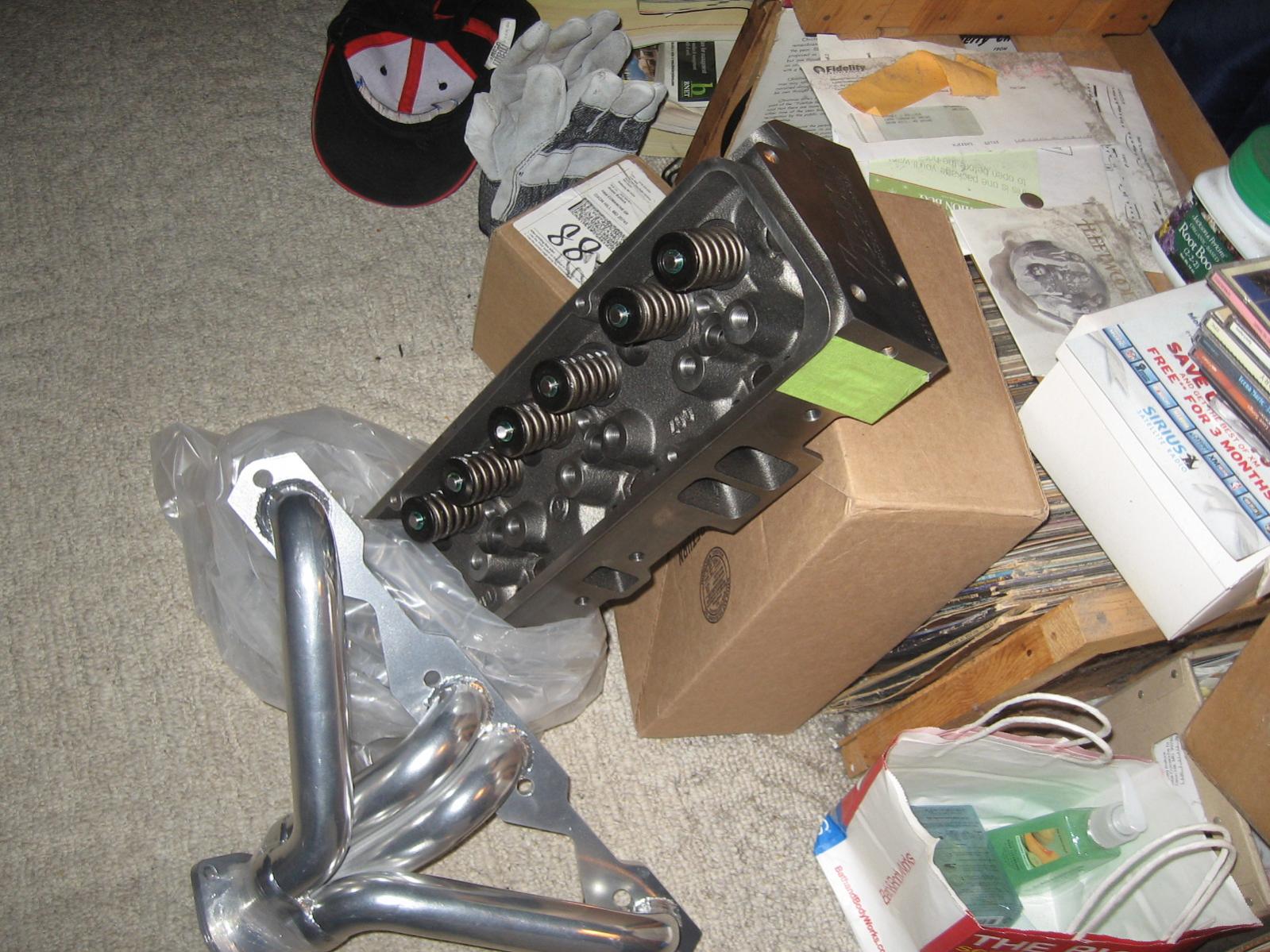

    I went with these headers, They fit and make a great sound. They look good also. The car makes alot of compression now and the horse power gain is huge. I also replaced the heads with the cast iron summit head with roller rockers. Great comination
