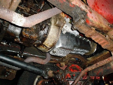

  15. 3 points , first if your gonna do 8 grand shifts a motor restarint strap or chain is mandatory ,I run one c the pic
    second I use poly biscuts ala 55-7 chevy and poly trans mount -less give
