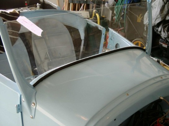

  4. They look like some ****era/Mr Gasket knock offs from the 90s BUT with a little tweaking they could be made to look nice. I took some stock posts and mounted the gl*** the same way. Bottom rubber is a T piece as well. The glue has not been cleaned up here.
    Gofannon likes this.

    That looks really nice! I think my biggest qualm with them is just as you stated: they look a little modern/cheap... so far I've only seen one car that they look pretty darn good on, but I can't really figure out what they did to them to make them work so well. Maybe part of it us just the style of car you usually see them on... 1927_ford_roadster_20220816_110058-20606.jpg

  7. I think by sofenting the edges and the tops you could do a lot to make em look less fabricated. But, if you notice, where I boxed mine they are still a sharp edge. You could graft on a pivot and top pin carved out of aluminum to look more stock like mine.
