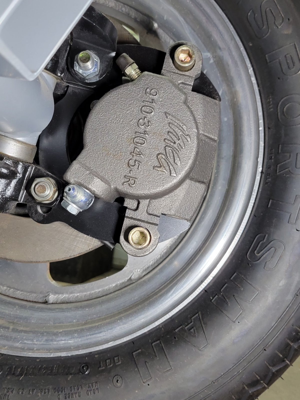

  7. I have the same, I swear I ordered the bigger brakes but I guess I didn't check the correct box.
    I just ran out and snapped these photos, it's just a flat bracket but the holes are close to the edge.
    20230215_172244.jpg 20230215_172400.jpg 20230215_172438.jpg 20230215_172639.jpg 20230215_172651.jpg 20230215_172717.jpg 20230215_172901.jpg

    Hi, ended up using the GM 11” rotors and keeping the metric calipers , just had to fabricate up some caliper mounts. Really helped my stopping power. Thanks for the input
