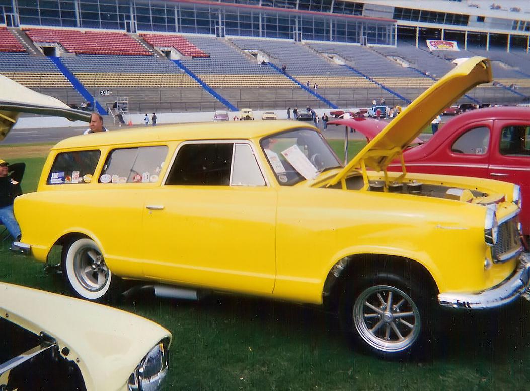

    im thinking i will make my 58 rambler american into a gasser its tubbed with a full frame now i just wanted a ball park # from the bottom of the frame to the ground so i can put it on jack stands and check out how it would look its a sbc with 165 15 on it now i dont have a kit yet i want to see how it would look before getting out the tourches and the credit card

    not mine.....

    we do a lot of them, with a straight axle not dropped and on new frame rails on a tri 5 chevy with a 26 inch tire and a big block is around 14 inches at the bottom of the rocker in front of the door. with a 4 inch drop it ends up about 11 or so inches...
