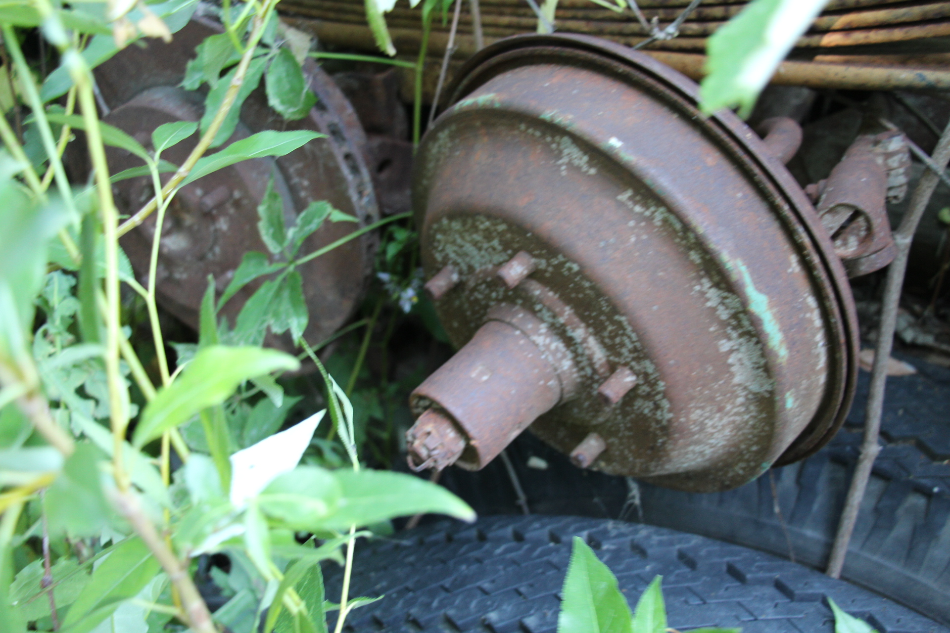

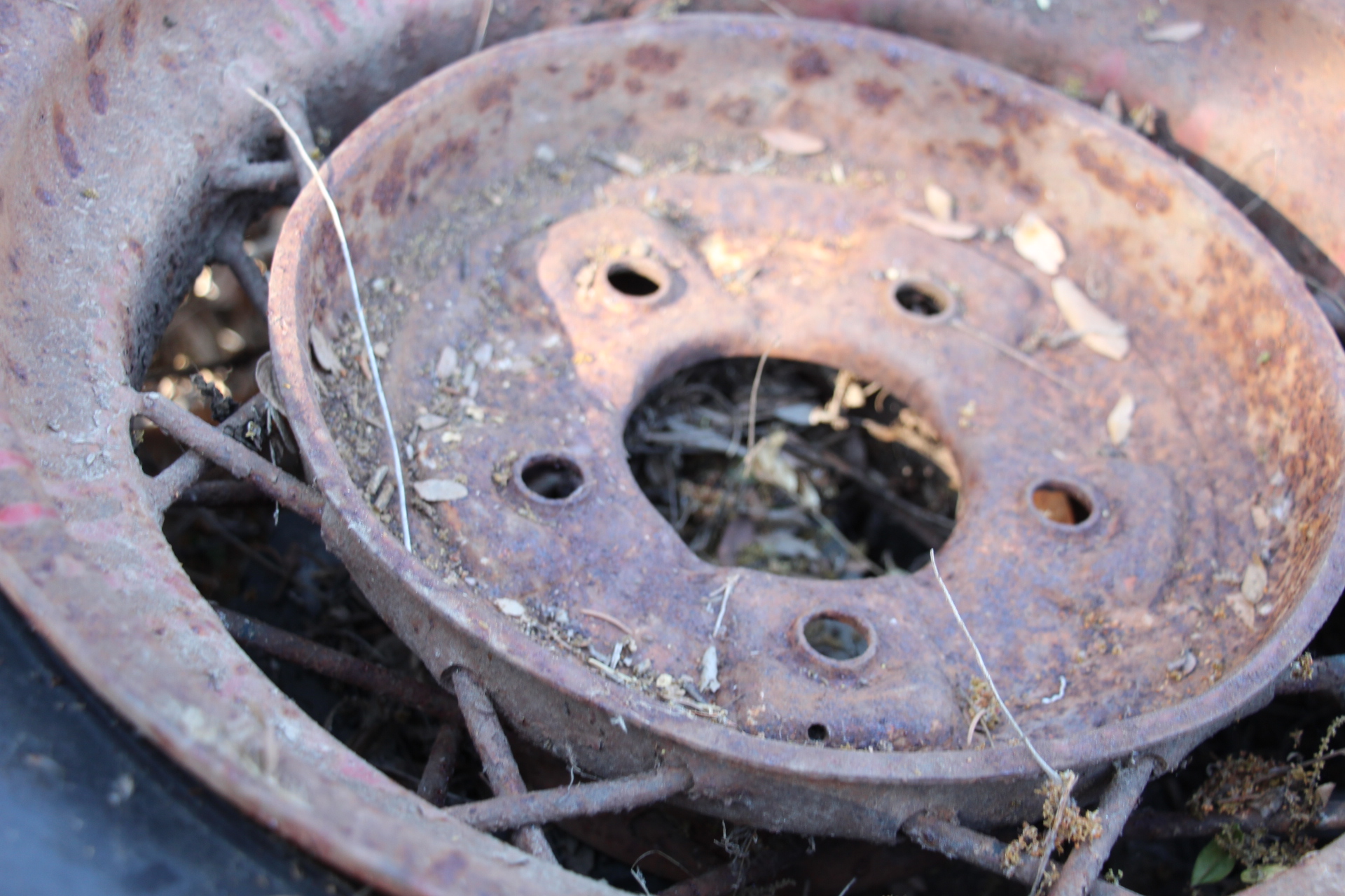

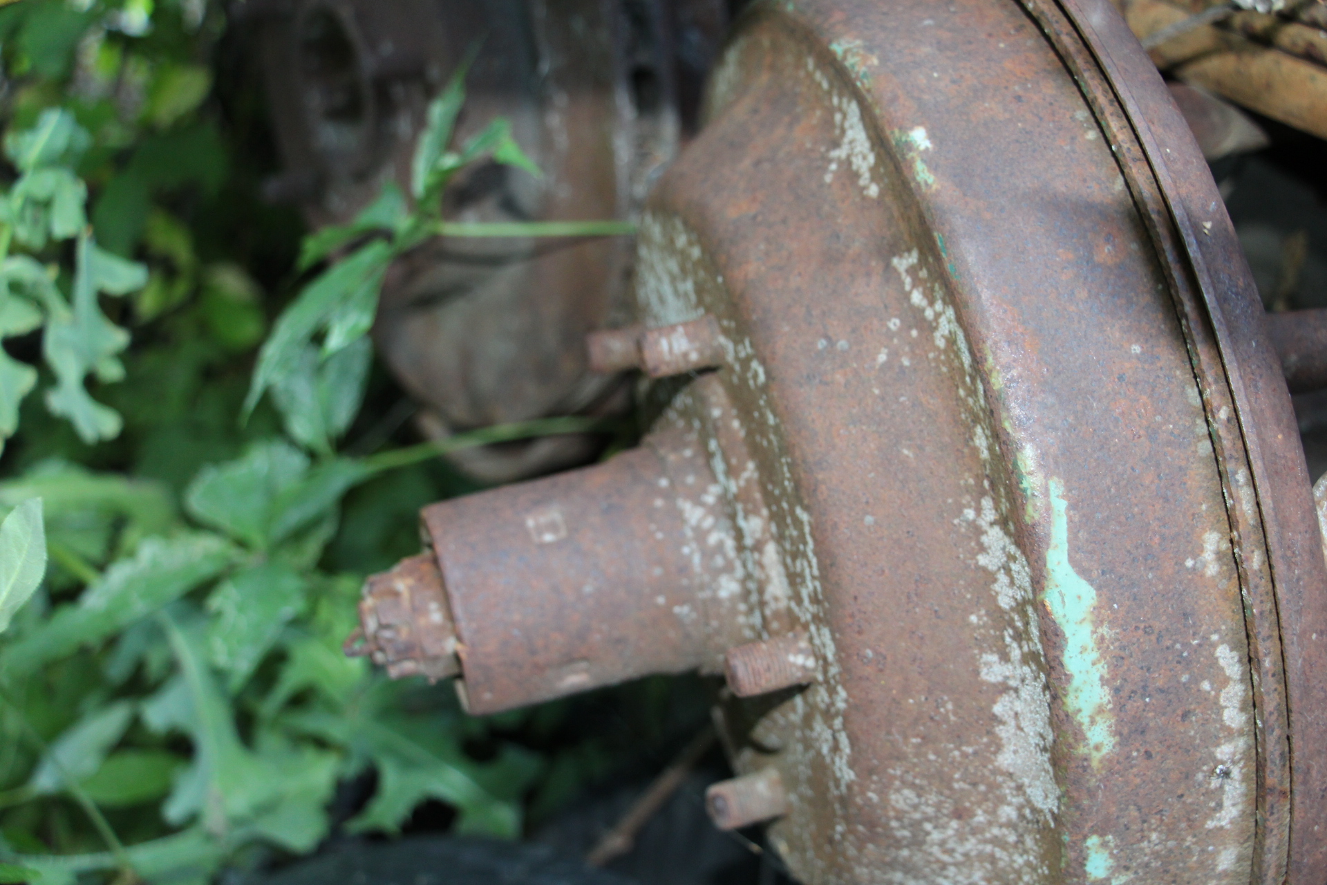

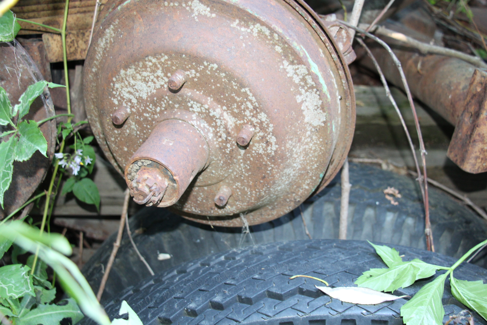

    As John said in post 4 without them you damage the center of the wheel around the lug bolt holes. BRB I'll go take a photo to show what he said.
  6. Mr48chev
    Joined: Dec 28, 2007
    Posts: 36,223
    Mr48chev
    Model A hub showing the step and a 35 Wire showing no support inside the rather frail seats for the lug nuts. IMG_0490.JPG IMG_0493.JPG IMG_0492.JPG IMG_0495.JPG
