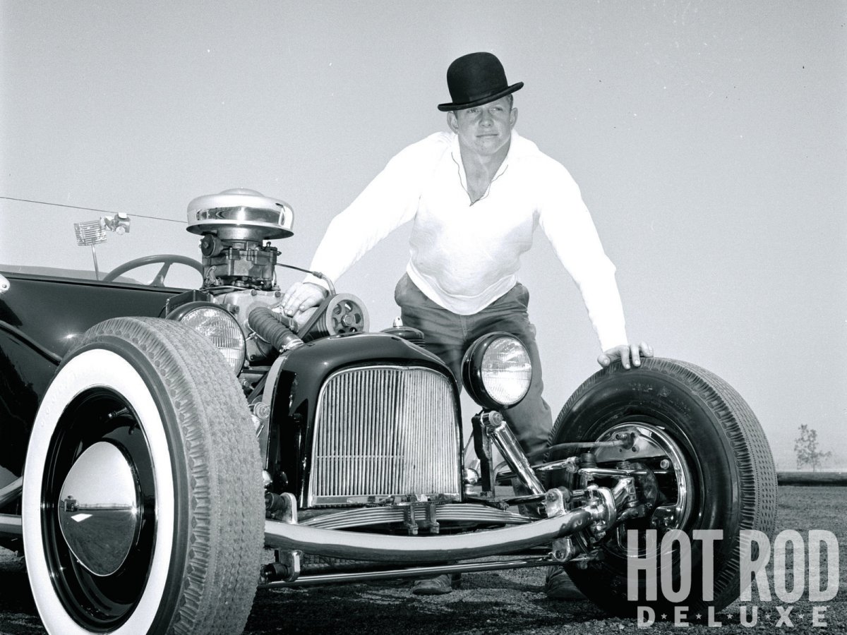

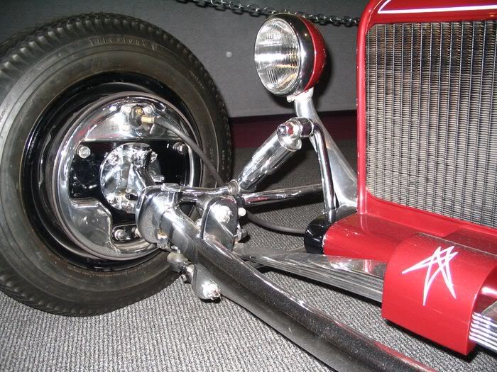

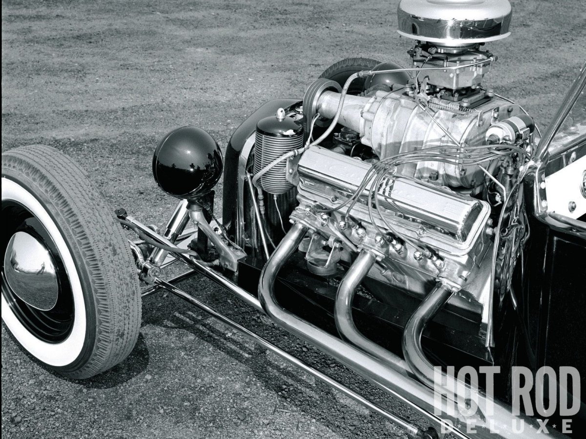

    Here're some of Ivo's, Grabowski's, and Von Franco's clone. NHRA06145.jpg NHRA061331-1.jpg Norm-Grabowski-T-bucket (1).jpg FRANCO.jpg norm-grabowski-t-bucket-engine-side (1).jpg SANY0005.jpg
