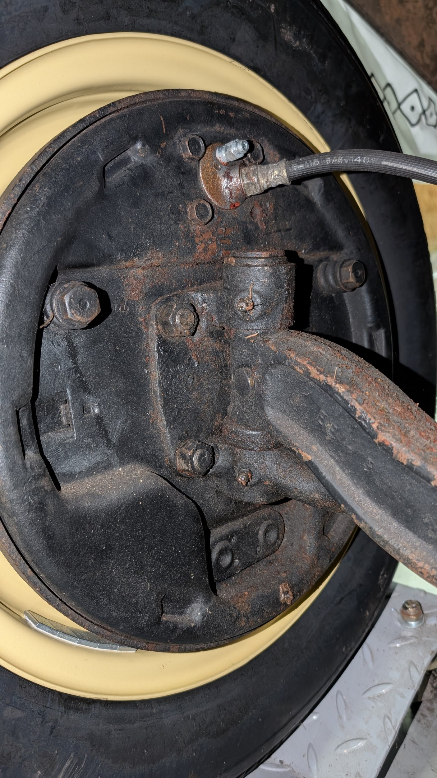

    I'm trying to ID the spindles on my '32. A previous owner converted the car to juice brakes. I'm going to take another look at them in my barn after work tonight.
    Braking performance is...... less than desirable let's say. The brakes are kinda weak. I'm trying to figure out what I have so I can develop a plan to address it.

    Need some light on the subject, can't see the spindle back at all

    Yuppers, you can't see a damned thing in that dark room.

    Your spindles are ‘42-‘48 Ford, you can tell by the tall boss on the top where the king pin p***es through.
    ‘37-‘41 k/p’s are 5 3/8” long, the later ones are a 1/2” longer.
  5. Fordors is correct. Be sure they're adjusted correctly. :cool:

    Brake backing plates are '46-'48 also.

    Yes they are. They lack the lower adjusters than were on the earlier backing plates. Your shoes are adjusted by the large hex nuts at the top of the backing plate.

  12. Those wheel cylinders look like they may be leaking. I can't tell if it's just crud build up around them or bubbled up paint from contact with brake fluid. If brake fluid gets on the linings then the shoes will be really grabby, that happened on my Model A, it would pull hard to the left when trying to stop.

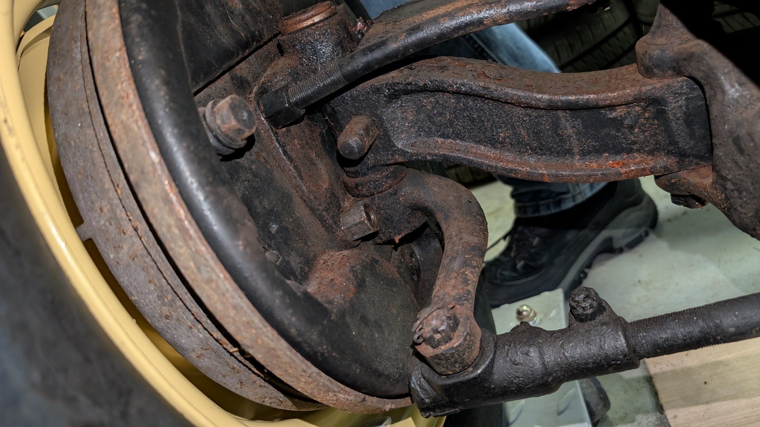

    I was able to get into my barn and get a couple better pictures of my spindles.
    Here's the pics. Driver and p***enger sides ahead and behind the axle.
    Can these spindles be used with a 4" drop axle? I'm thinking only if the steering arms are bent accordingly.

    That is a heavy 32 axle
  18. nobby
    Joined: Jan 8, 2006
    Posts: 1,392
    nobby
    IF you are running a stock unsplit wishbone
    your perch pins are at 36.5 inches
    you have a 2'' perch boss
    at the moment your axle width to the king pins is 50.5 inches
    IF you go and buy new forged axle that is at 36.5'' perch distance with a 2'' perch boss = =because you wish to run
    the wishbone unsplit from where you are now - -IF a 32 heavy axle is the same dimensions as a 36
    you will come inboard 1 1/4'' each side at each king pin.
    FROM WHERE YOU ARE NOW
    the drop will be 2 3/4''
    not 4
    its 4 inches of drop from the straight over model A axle.
    IF the steering arms are in the same location as model 78 37-40 spindles then
    you will need to drop the steering arms 2'' = =not 2 3/4
    so, even though you could have your heavy 32 axle dropped 2 3/4'' and narrowed to 48 inches 1 1/4 each side
    you will still need to narrow the tie rod 2.5 inches
    and your cata-pult input steering link will also - -looking at it need to be looked at
    before you start and knowing you will be coming over 1 1/4'' each side - -how far away at the moment is the tyre from the drag link - -on the stock spindle stops

    Sure those spindles can be used with a dropped axle. I highly recommend dropping the original axle rather than buying a new one. And I also highly recommend heating and dropping the original arms instead of cutting them off and bolting on new arms.
