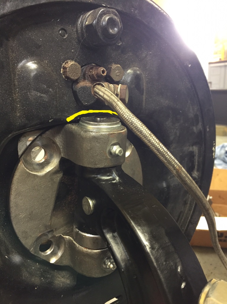

    So I put a new drop axle on and the kingpin size is .81 the old kingpin are about .93. No problem so I just get new spindles. So now the brake backing plates will not go on the spindle. My question is there a bushing or a adaptor that will let me use my old spindles?
    Or are there some new spindles that will clear the backing plates on my old drums?
    Pic of new spindle with backing plate
    Pic of old spindle with backing plate

    Would you be so kind as to post a picture of the "business side" of the backing plate?
  11. F&J
    Joined: Apr 5, 2007
    Posts: 13,291
    F&J
    .Grinding the spindle can't work if I see this correctly. If you grind, then the top of the new kingpin and boss will not clear the backing plate....and even if you cut a notch in the plate for the kingpin top, it would then be hitting the wheel cylinder body.
    spindle.jpg .
    And the repro spindles you show that already have a notch, probably won't work either and still hit the wheel cylinder.
    I would have bushings made to use the old parts.

    Those are '39-'40 Lincoln backing plates IIRC and naturally they fit the Lincoln spindles you previously had, but I don’t think they will work with early Ford spindles, and for sure not with the ‘37-‘41 style you bought.
    ‘32-‘36 spindles do have the same bolt pattern but the thrust bearing goes on top of the spindle on those and there is no clearance at the backing plate for it. Even if they did work you would still need to modify a set of ‘32-‘36 king pins by cutting off the brake actuator cup from the top of the k/p’s and welding on a strong washer, like a 1/4” thick to support the front of the car. The span between the yokes on the Linc’ spindles places the thrust bearing under the axle, but the ’32-‘36 Ford spindles have it on top of the spindle.
    I wish there was better news but I think the deep recessed ‘39-‘40 Lincoln backing plates might require the Lincoln spindles.
