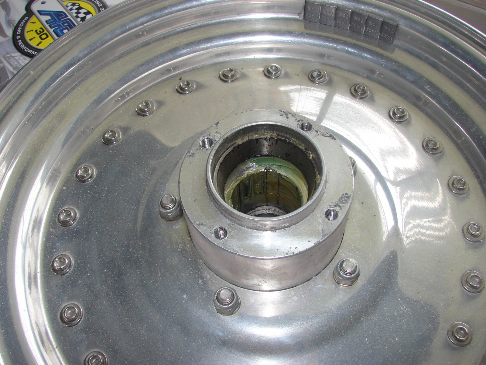

    I bought these Centerline wheels on ebay, intending to use them on early ford spindles on my SDRA dragster. Unfortunately, they came without any internals. I need to find out about seals, bearings, caps whatever's needed, to return them from garage art to race car components! Thanks for your help DSC07645.jpg DSC07646.jpg

    It looks like there is a inner race in the hub maybe you could knock it out and look for a number on it.

    take them over to Applied Industrial Tech. They are local to you...3301 Waco St. They can get ya rollin'.
    Take along the measurements of the spindles, or if you can, take the spindles and wheels. They can measure them up and find what you need. I have used their service many, many times here in Rochester NY.

    You may have to do some machine work depending on what spindle the wheels were originally intended for. I can't remember Centerline making a wheel to suit early Ford spindles. Most common were for Anglia and Mustang 11 and also for the Lamb strut package. In those cases you may need to machine the race register to be able to install bearings big enough for the early Ford spindle. The part number on the box is for a bolt on GM (small) bolt pattern bolt on wheel so it is not much help.
