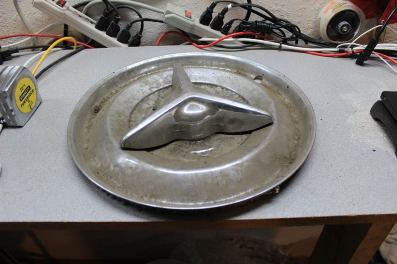

    image.jpeg Do you guys think a set like these would shine up? They're a barn find.

    That looks like an original 56 Olds wheel cover. Much better than the repros. It should be made of stainless steel, will clean up nicely and look really cool. Do you have a set of four?

    Yeah I'm looking at a set of 4 online. They all look like that. Aren't they chrome on top of stainless?

    no, just stainless. I don't believe original Oldsmobile starfire hubcaps will fit on your wheels though, they ( the chevy wheels) don't have enough offset, and the cap will hit the center of your wheels and not snap on the rims. I'd see if I could find on to try, before you buy...........

    No. Stainless will polish like chrome. Chrome is applied to steel, stainless steel is steel.

    The ones I am looking at in the pic are returnable so I think I might just go ahead and get them and if they don't fit I can just return them. If they truly can shine up really nice like you guys say I might have a decent deal on my hands. They're going for $400. Still pretty pricy but the other '56 Olds spinners I see online are going for $650.

    Those are one of the better spinners made. Good luck with them.

    Ask the seller to see if a magnet will stick to them. If it does, they're chrome plated steel. If not, they are stainless. If they are original Oldsmobile caps, they should be stainless. However, there were replacement caps made back then, (in the 1950's), that were cheaper chrome plated steel ones.
    Do you have any other pics of them?

    I believe those caps may be re-pops. But done way back when. Look at how the center goes out and not in. E z i is right about off set and most originals would not work on some wheels. I had same problem with my 50 Ford but found some similar to these that stuck out the same way. Although mine were chrome and I had to stay on top of them or they would rust. My 2 cents.
