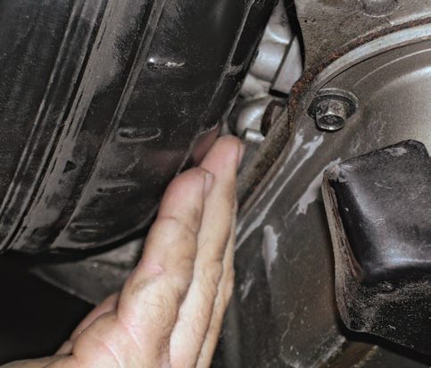

  20. gimpyshotrods
    Joined: May 20, 2009
    Posts: 24,569
    gimpyshotrods
    Different transmission, but you get the idea:
    That gap fairly large. That is what it should look like before it is pulled forward to the flexplate.
    Washers there are only appropriate if you have a motor plate, or block protector, or both.
    Falcon likes this.
