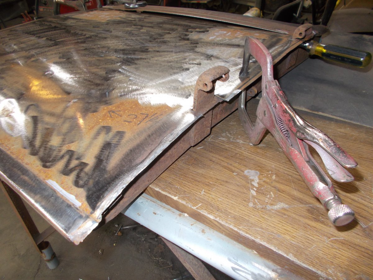

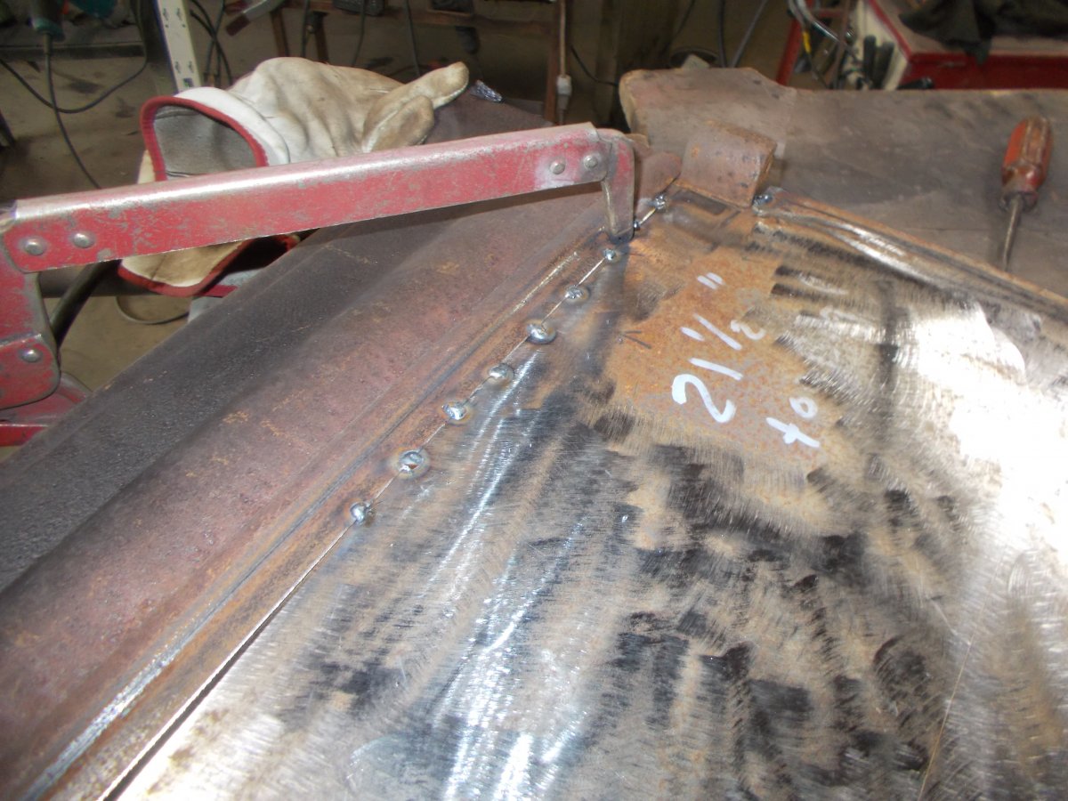

    i came up with this out of lazy and common sense,
    when splicing panels, door patches etc.
    cut too big...
    fine tune the ends or pillars...
    measure carefully, mark well and often...
    when final fit is got, kleco or tack weld the inside and out...
    slap a metal cutting blade in your HD sabre saw...
    use a wizzer to cut a starting slot for the saw...
    use a good face shield as the chips will be hot...
    will cut both panels at the same time...
    remove the klecos or grind off the tacks...
    check final fit, tack, remeasure everything, and go...
    does not work as well with curves... may be me ? DSCN5707.JPG View attachment 4940909 DSCN5828.JPG DSCN5829.JPG DSCN5830.JPG DSCN5837.JPG

    the small air powered saws work even better for this i use a 24 tooth blade and go slow

    Not a new method at all, but glad you figured it out.

    I like to make one panel have a night clean edge, then lay the other over it and scribe a line with a scratch awl. Making a nice tight cut to the exact line doesn't take more skill than it does patience. Sometimes it's best to cut the extra off, leaving a quarter inch on, and then use a nice sharp set of hand shears to trim right on the line. Again, patience is key to a tight fit.
    Sometimes when I weld I won't even need to use wire, just fuse the panels together if the joint is tight.
  6. Cleaning your metal better would make it even easier. All that rust is not good for the welds.

    I saw something a while back.....don't remember where. The guy put one panel behind the other and then tilted the thin cutoff wheel about 45 degrees instead of 90 degrees to the panels. When he cut through, the 45 degree angle, the panels fit each other with a slicght overlap/****. Might be worth trying on some s**** metal to see if it works as well as it did in the video.

    The square edge of the panels is a must! When **** welding, the gap between the panels needs to be kept to a minimum... preferably none. As the welds cool, they will cause shrinkage, the square edge and and tight fit will prevent the panels from excessive shrinking. A gentle tap with a smooth hammer and dolly will stretch the weld back into shape and relieve the stress on the panels. I have been doing panel work for 20 years, and rarely fight weld distortion

    I like to use Clecos with an offset barb with the offset equal to the metal thickness. I score the barbs on the backside before welding and break them off after tack welding the panels. A little hammer-n-dolly work and voila - a perfect **** weld.
