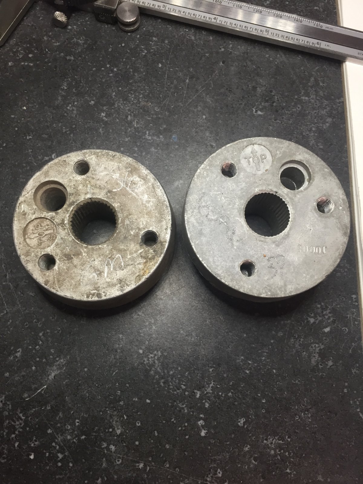

    Ok, I have a drawer full of these adapters, One was marked ford on the back (by me with a sharpie) don't know what year. So I counted the splines and got 39 on the ford one and 36 on a Gm one. they both measured .685 with a caliper strait across with the caliper in the "innie" part of the splines

    Thanks Moriarity, that's exactly what I wanted to know. So I wonder if the T-Bird guys were just forcing the GM spline onto the Ford column? Or do they make two different wheels and the Ford ones just have poorly made splines. Who knows.
