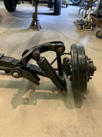

  9. The Flemke was a solid axle with a "split" buggy spring
    upload_2019-4-13_19-35-27.png upload_2019-4-13_19-36-48.png upload_2019-4-13_19-37-56.png
    thintin, s55mercury66 and gnichols like this.

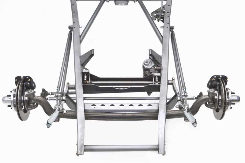

  16. Rusty O'Toole
    Joined: Sep 17, 2006
    Posts: 9,756
    Rusty O'Toole
    Rusty, you got it right! Problem is, I can't wrap my head around how to get a solid axle to work with torsion bars. Seems like I would need an additional a-arm or pivot point.
    Here's how Frank Kurtis did it on his legendary race cars and sports cars. Notice the trailing arms, crossed torsion bars and reaction point links.
    Coils would be easier, torsion bars cleaner looking. It might be better in your case to have the torsion bars parallel to the frame with control arms parallel to the axle.
    Ned Ludd, dana barlow and Boryca like this.

  23. It was done so you can run two different spring rates with a buggy spring. Notice how the right side springs have more leaves.
    Also, the spring rates could be changed more easily side to side then with a single buggy spring.
    Boryca likes this.

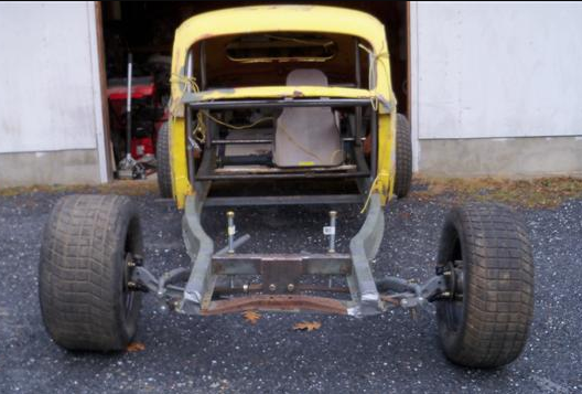

    I seem to recall a split dropped I beam axle advertised in Street Rodder, 2-3 decades ago. Similar to the Fat Man setup but it was Stainless IIRC. Anyone recall it?
  25. 34Phil
    Joined: Sep 12, 2016
    Posts: 807
    34Phil
    I do, IIRC it was IFS with the axle being lower A arm and spring the top. Don't remember details

    The only vw-ish thing on Frank Kurtis's front suspension, are the trailing links, which are actually just backwards from "normal" 4-bars. Still a solid axle, in this case a true "straight axle". What it gets you is the axle arc "cup" is facing forward rather than backwards on normal 4-bars. So you get to pay attention to the arc-swing of the draglink (steering box better be in front of the axle, draglink better be parallel & same length as radius rods), & see how it affects toe-in, camber, castor,& bumpsteer under "loads". :) . Another similar setup to the 'Indy-Pendent' uses 1 solid torsion bar in place of the 2, like a FED &/or acvwVolksRod(Kent Fuller, Tom Medley, Andy Brizio, etc) just heavier-duty. Lots of ways to skin the cat...
