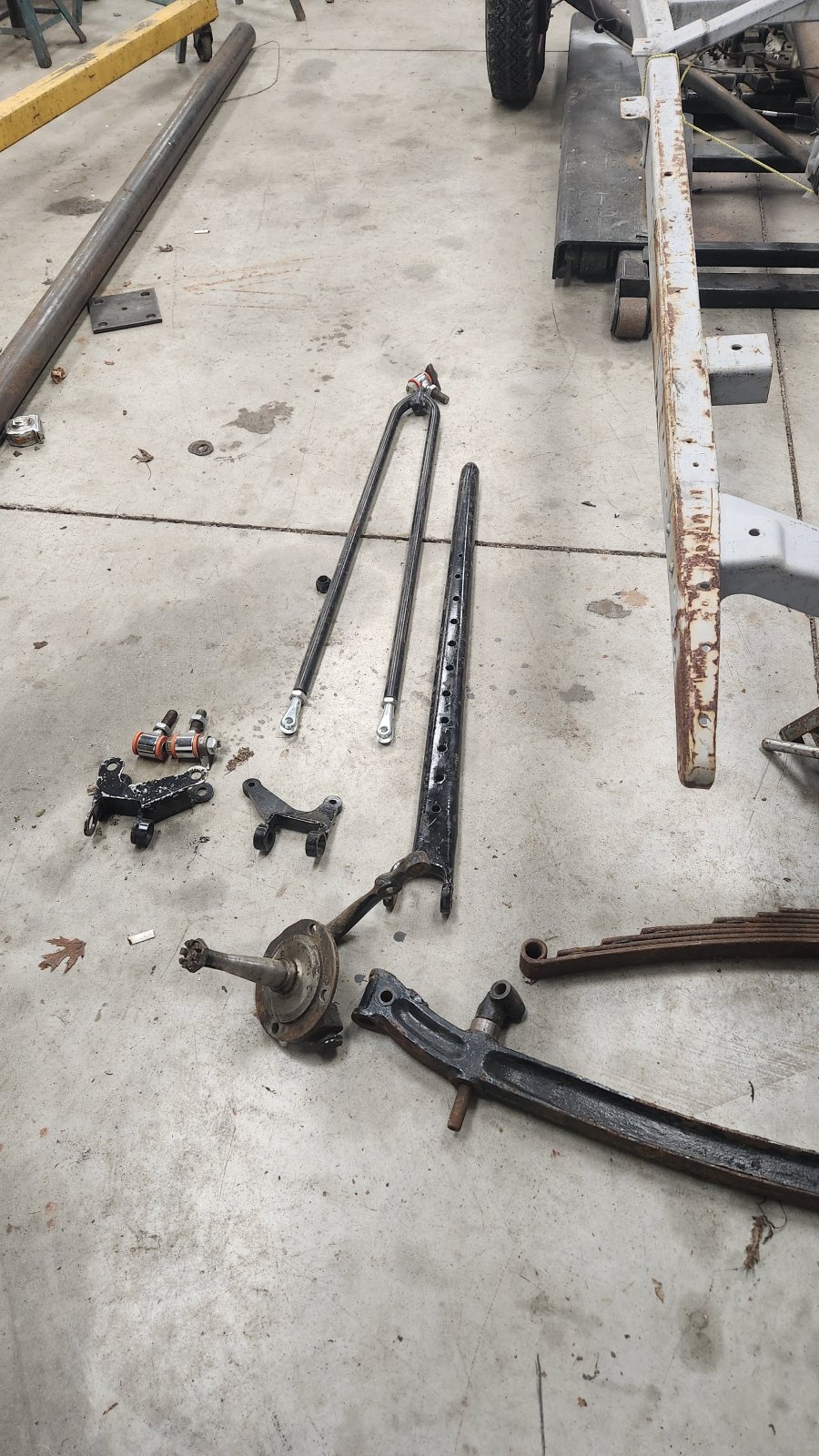

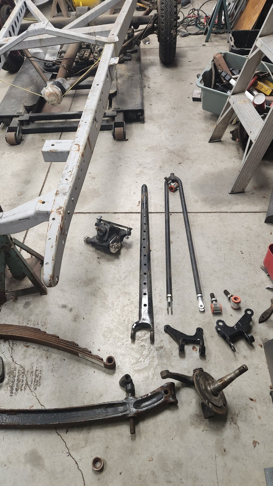

  1. Putting together an A frame and wanted to split the wishbone or run hairpins was going to use a 37 axle but it has been suggested the hairpins or wishbone may interfere with turn radius. 20230108_100153.jpg 20230108_100205.jpg 20230108_100200.jpg

    A model A axle or 32-36 axle would be the best choice.

    Yeah, you will want something with more distance between the spring perches and the king pins.
    With either hairpins, or split bones, that axle will lead to steering issues, even if you put the mounts inboard on the frame.
    Model A, or '32-'36.

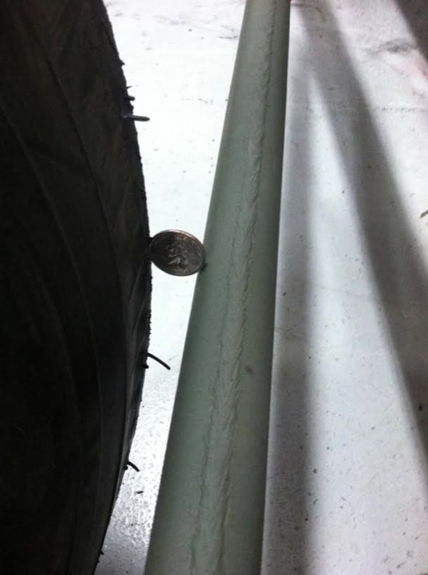

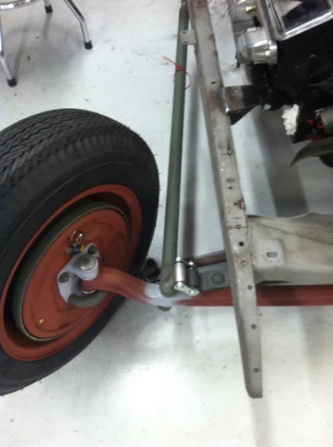

    Here is a dropped A axle, split '37-'40 bones pretty tight at full lock.
    Looks like A bones in your picture which can make a difference.
