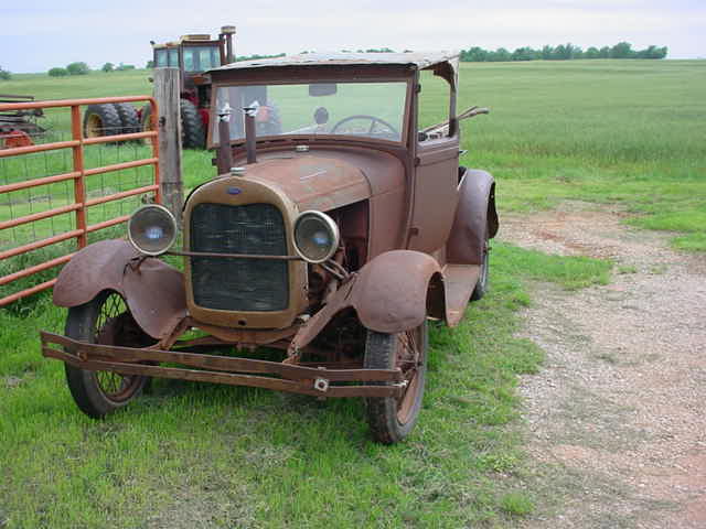

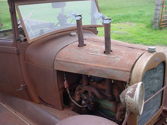

  16. shihtzu11
    Joined: Aug 2, 2009
    Posts: 45
    shihtzu11
    from dacoma OK
    NEVER--SEE PICTURE!!!:eek::eek: YEAH, IT RUNS PRETTY GOOD!!
