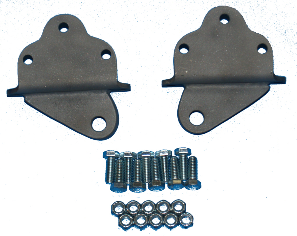

    wb3.jpg wb3.jpg We make these bolt on wishbone frame mounts that can be bolted to the X-member. These are also available with the bungs and tie rod ends.
  10. @Weedburner 40 , is there a taper in that hole for the tie rod pin? Looks like a easy way to get the bones mounted.

    Algoma56, yes, the tab is tapered for the Early Ford tierod end. The taper is from both sides so that the tierod ing can come in from either side.
