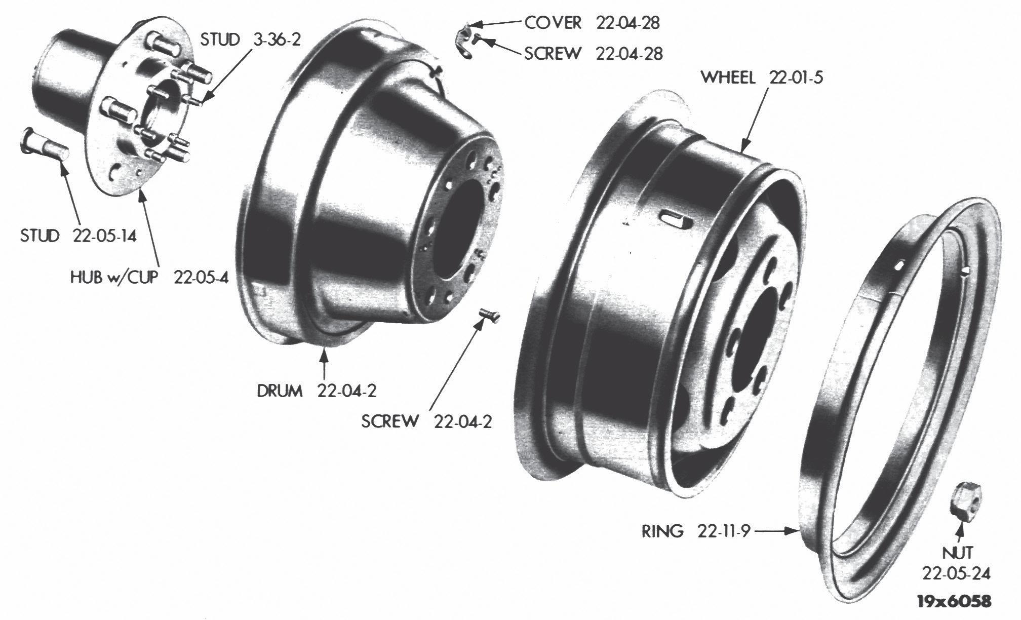

  1. I've got a set of pristine '51 Dodge Powerwagon split ring rims, and I understand these things are dangerous. But as anyone who has owned a WM300 Powerwagon knows, these vehicles aren't easy to find different wheels for considering their unique bolt pattern. So here is my plan: I would like to weld the split ring to the rim and weld a beadlock to the ring. The only thing that would make this work is that my Powerwagon uses tubes in the tires. I've included a picture of the Powerwagon split ring wheel below. What are yall's thoughts?

    If the picture is the style rims you have those are NOT the ones call widow makers. Those split in the center on on the edge. During my days as a semi truck collector I changed dozzens of those split rims ,no big deal if you know what you are doing. Lots of big loaders etc. still use multi piece rims. But as said the ring has to be removeable to change tires.

    Agree with John, they are safe, if they are in good shape.
    That type is very safe, because once the tire outer bead is shoved up against the lock ring wheel flange, the ring can't spread out enough to slip over the groove that holds the ring on.

    Many of the trucks from the 40s and up had the same bolt pattern. IH, Dodge, Ford and Studebaker had the five bolt pattern. Ford had the two piece Widow Makers, I looked at the picture posted again and realized it had the outer snap ring, the Ford rims were made up two solid pieces that separated in the middle. They had a notch that you lined up and twisted 180° to lock. This design was flawed from the beginning.

    Your rims are called "split ring", not "split rim", and are perfectly safe to use if undamaged and handled properly. They are not the deadly split rim "widow maker" type, technically termed "Firestone RH-5°". Your Power Wagon wheels are Budd products, probably the 16" x 6.5", Budd part #66730, and use a Goodyear "LTS" outer rim design. I have these same wheels on my 1948 Power Wagon (B1PW126). Lock ring wheels were used on all the old flat fender Power Wagons except for those with the "combat rims" as described above. You are correct that the bolt pattern is unique to military spec vehicles. They have a 5 lug x 6 7/8" bolt circle. I've heard of these also used on WWII era IHCs and even on some post war military spec Marmon-Herrington Fords. While no one piece tubeless wheels are commonly available with this bolt pattern, but I've read that there was a special run of them that are now extremely rare. As said above, a custom wheel company could pull your centers and remount them in new tubeless rims. I'll post below a cross section diagram of the Goodyear "LTS" and pictures of the "LTS" stampings on ring and rim. The above posting is correct that mix matching rim and ring designs can be deadly.

    Here's an old FTE thread where I linked two OSHA web sites that give good info on safely servicing truck wheels, and on the dangers of mix matching rim/ring designs. To be absolutely sure you have wheels like I posted pics of you'll want to scrape around on the ring to find the markings. Also, on the back/concave side of the wheel itself Budd generally stamped their part number on the rim lip. Normally it's opposite the valve stem. If you find a different part number or ring design marking come back and I'll see if I can look it up for you. I've got a pretty good library of old wheel catalogs. Stu
