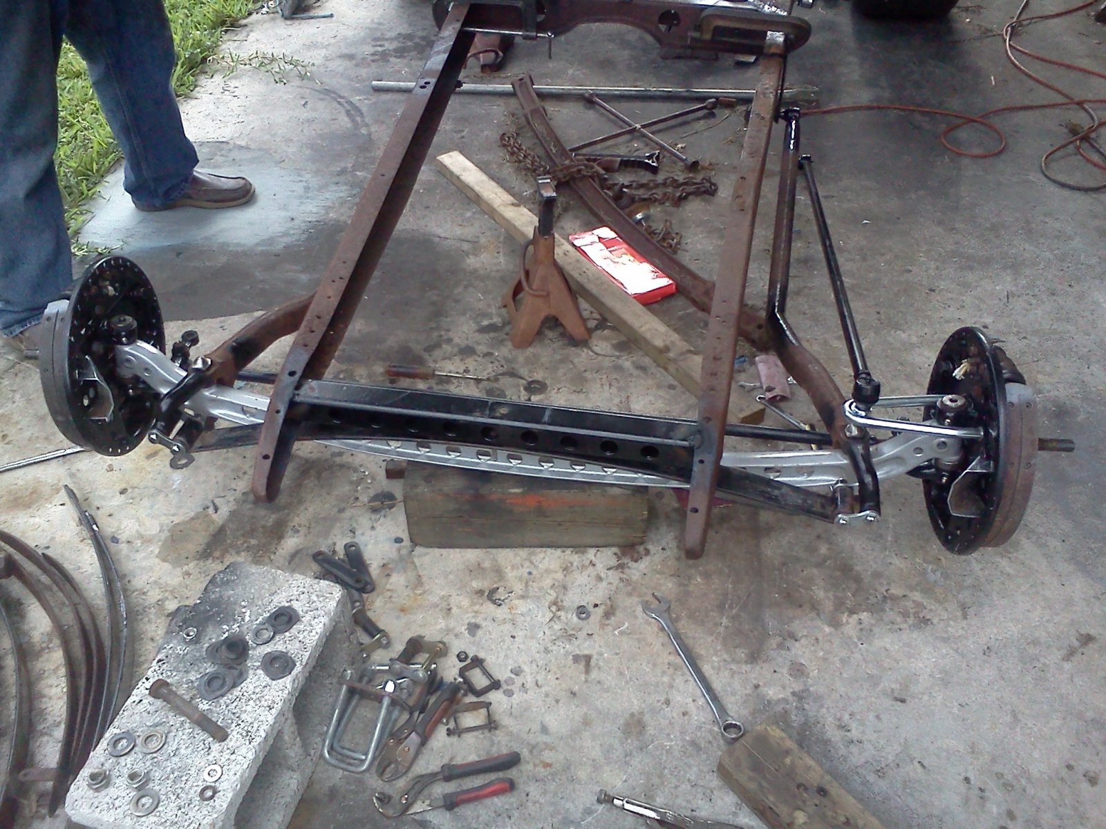

    120502-IMG050.jpg I don't know why only one of your's is bent ? except if they didn't start out together or was left over build parts that never got finished =both should be matched.!
    For split bones;;,often they are bent by builder=So tire on a hard turn dose not rub bone when hard over in a turn.
    It's OK too be bent{ Both} for that,it's not a prob. As long as there is no cracks in bend/ Some cut "V" an reweld,an that's good too. Other wise,no way can car,with slip bone turn all the way right or left.
    A pick too help;;Note how back 1/2 of bone is even with frame,an bend is just back of were tire would rub other wise. In these,they are 1948 spring forword bones,so bend n spilt also line up spring shackles out front.
    Pic from rod restore after long storage,so lot of rust still needs work of full brake down an restore,slow as you go.[
    ATTACH=full]5949543[/ATTACH]
