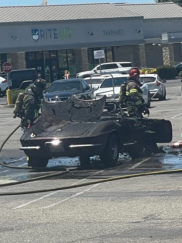

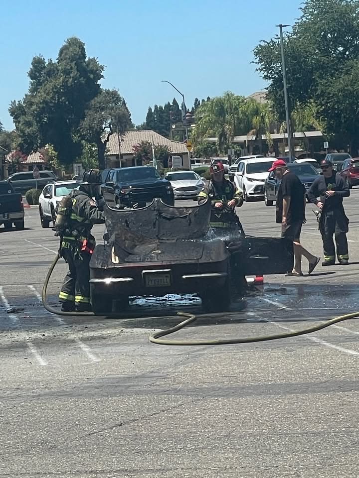

  21. my worst nightmare, i hope everything turns out okay. I always keep a fire extinguisher under my seat just in case the ethanol finally decides to eat away the fuel line. right now all it's good for is rolling under the brake pedal
