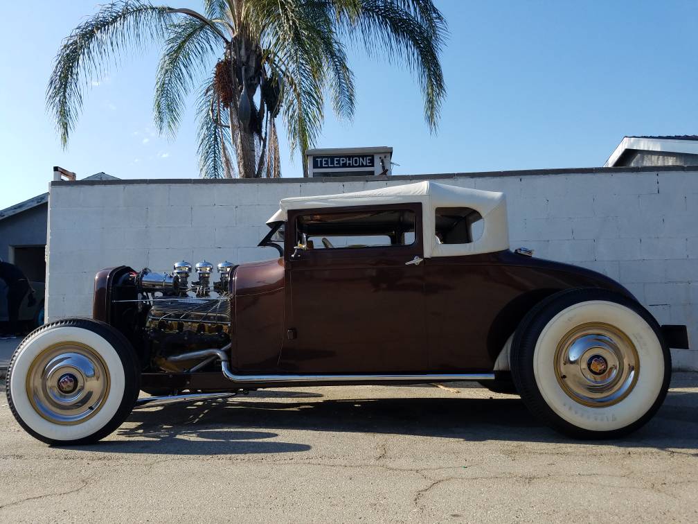

    Personally, I'd keep it as a Sports Coupe, chopped. I've seen several and I think they look cool, with their own unique thing goin' on.
    Maybe not everyone's cup of tea, but I dig it:
    Tman, alchemy, Pist-n-Broke and 6 others like this.

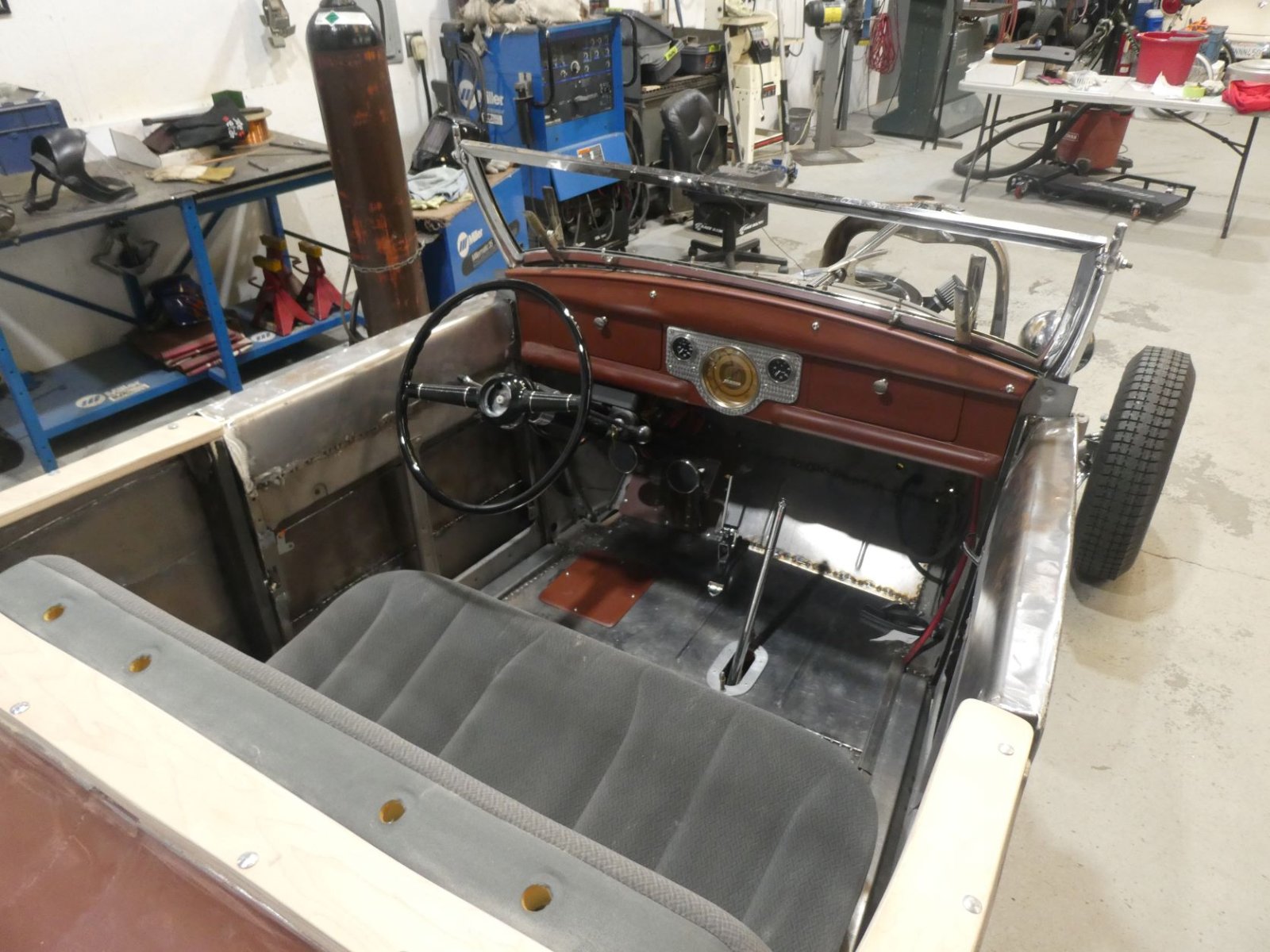

    Here is my project. I used a 34 chopped windshield and recontoured the cowl to match. The doors are cut at the body-line with a rolled top. The dash is from a 40 pickup under the Model A top. I really like the cut-down sport coupe with its long doors to get a fat old fart in easily.
    pprather, Tman and Blues4U like this.
