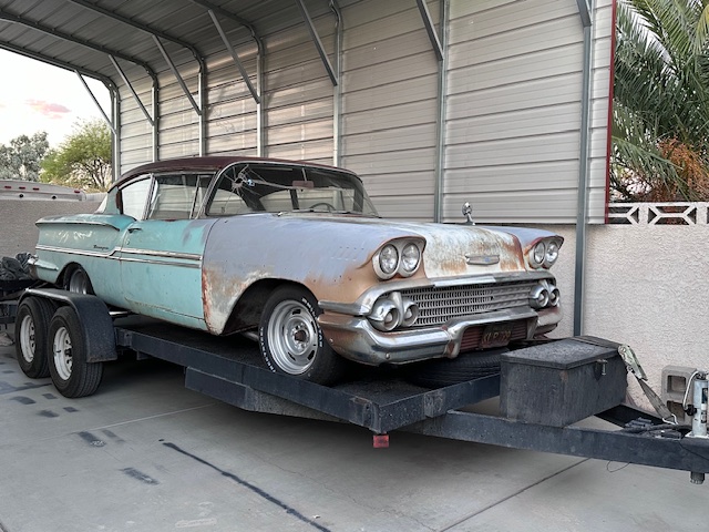

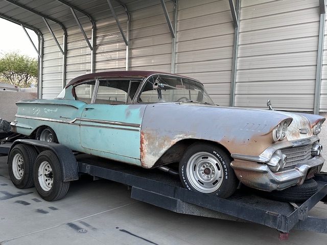

    I remember some 40-50 years ago using a spray on rinse off rust/ metal cleaner that worked....metal would look new....forgot what it was though... is it the same stuff used to clean aluminum??? anyway, figured there has to be something out that actually works like the sales videos.....
    this 58 has the whole roof rusted.... I wanna wash the rust off, **** brick it and paint it..not gonna use any sanders or grinders or sand blasters of any sort, I'll just **** brick it so it stays smooth and only removes the rust,...
    as always, thanks for any and all replies... I'm gonna **** brick the whole car, and my bet is there's rust on top of the fenders under the primer... IMG_3547[9100].jpg IMG_3548[9101].jpg
