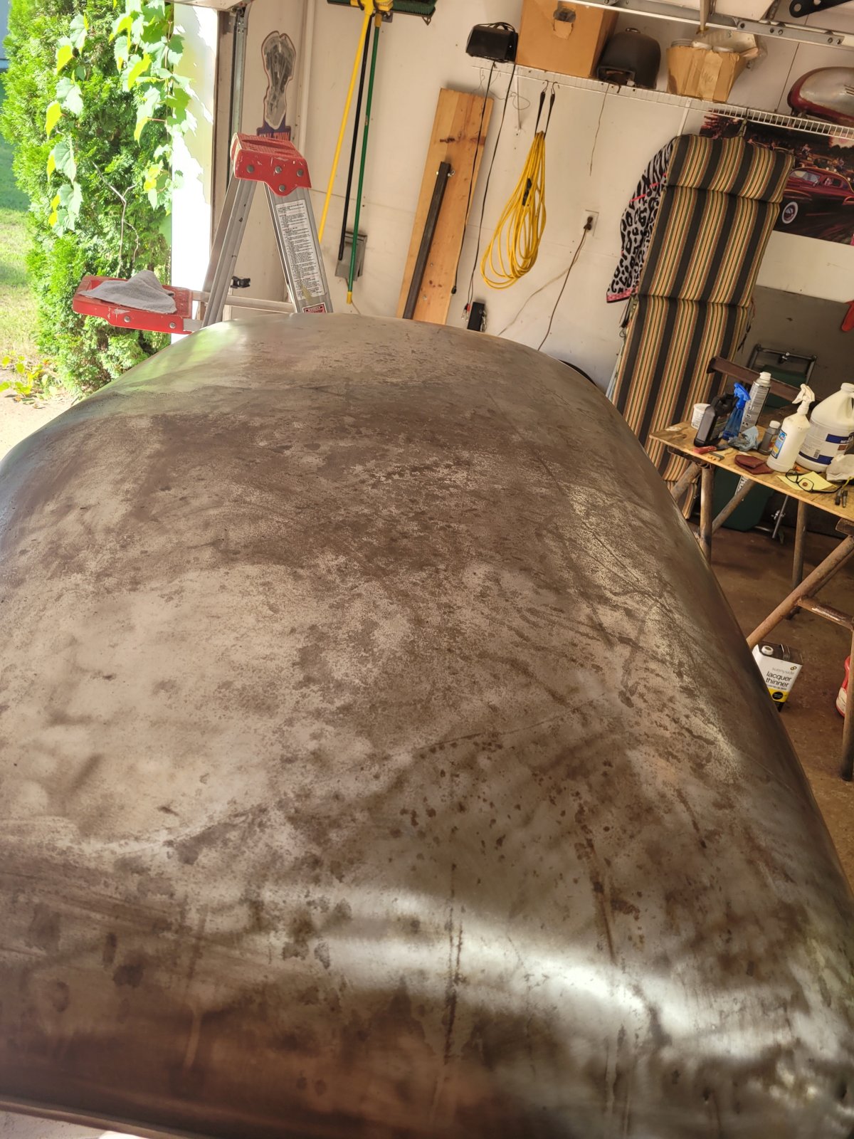

    so here's what I'm up against....I don't wanna damage the metal any worse than it is... .I wanna rust wash it then **** brick it... IMG_3554[9107].jpg IMG_3555[9106].jpg IMG_3556[9105].jpg IMG_3557[9104].jpg

    still waiting on the stuff to do this car,...but been messing with it...haven found a spec of bondo yet, and shes super straight....so far i've got it to nice clean new looking metal...

    so I figred out what happen here... when I first started, I sent my wife to the store to get me some ez off to clean every thing...while she was gone looking around in my shed I see two old can of ez off.. I thought wonder if this stuff is still good,,, it's like 30 years old.. maybe ever more.. so I sprayed some on the side of the 58...it didn't sit that long and I was pressure washing the wheel wells... so I hit the side of the cars with the washer... blasted right down to bare metal, as you can see in the pic... thought ****, this i'll be easy... i'll just ez off and pressure wash all the paint off.. ith the first blast it left the fac. primer... so I grabbed the sec. can... sprayed it on.... primer gone.. so now... out of the old stuff... have the rockers and under the side molding to do.. wife brings me 10 cans... went through that and nothing happened... got 10 more cans... left it on over night... nothing..

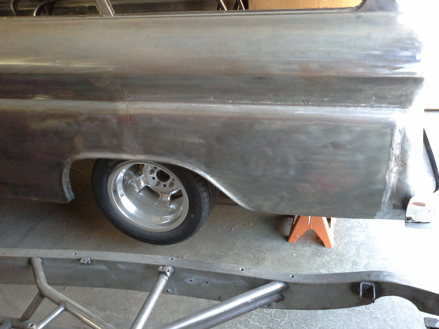

    Stripped the paint and surface rust with a stripping disk. Rust dissolver gel for the embedded rust. before and after.
