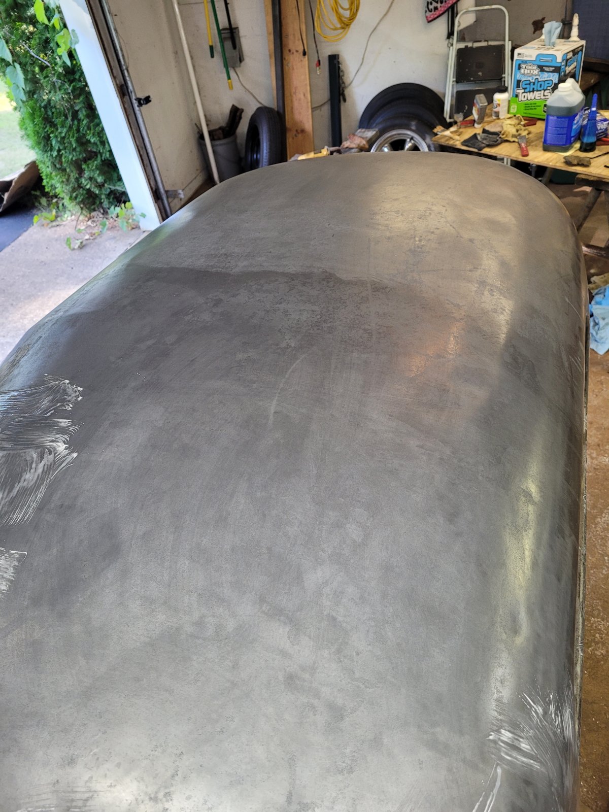

    I'd put it on thick and leave it on overnight. when it dried I'd brush more on. Then s****e it with a putty knife next day. Took a couple tries. I think 8oz of navel jelly gel was the same price as 32oz of rustoleum gel. Messed around with citric acid and towels before, which worked ok but made a huge mess.

    Oh and saran wrap over the top kept the stuff from running and drying out.

    The problem is not the product, but your application methodology. It has to be submerged or have continuous flow via a pump - (that's why I mentioned a Home Depot pond pump, in my post above). You cannot let it dry, or it's a fail. the stuff literally works wonders.
    still have some more on the roof to do, but the rest is seal'd up... also my new tires and wheels are getting dropped off tonight...

    Be careful if you are doing this on a car that has thinner sheet metal (like a 60's muscle car). The generated heat can warp panels.
