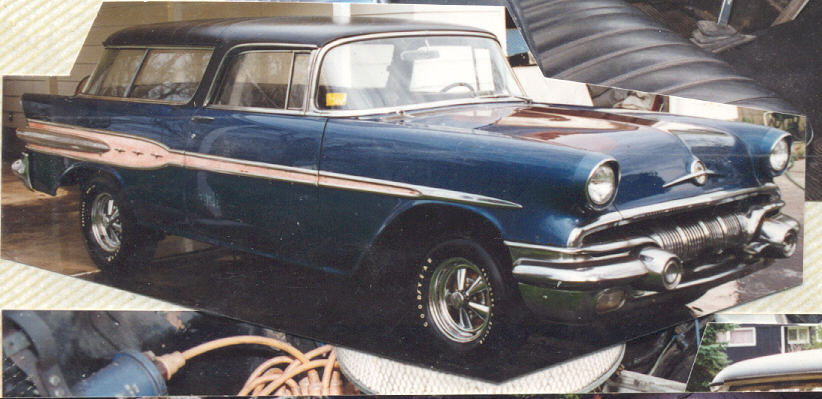

  17. 57Safari.jpg Here is a picture of my 1957 Pontiac Safari that the former owner added a spray on vinyl top to in 1970.They used a product called,"Body Schutz"(sp?) that was used to repair undercoating on Mercedes-Benz cars.No tape used bexause of the cross ribbing in the roof.It has held up remarkably well.I was going to try and remove it but have decided to leave the exterior as found.The reason it looks shiny is it had just been washed.Oh yes;it also has red cobwebbing over the white inside the insert.Used to have red tinted windows via window spray but that is mostly gone now.

  18. Rusty O'Toole
    Joined: Sep 17, 2006
    Posts: 9,756
    Rusty O'Toole
    Body Schutz is the stone guard I mentioned. The vinyl top was an earlier product, in the 80s we used schutz or stone guard as a substitute.
