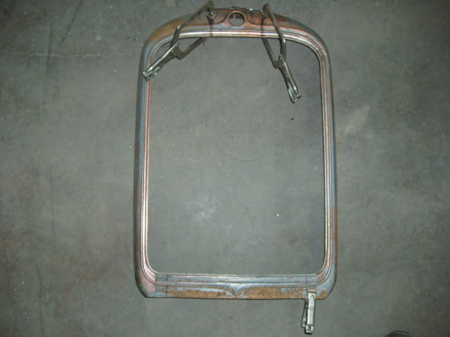

    I want to chrome paint the art deco opening on this grille shell I have for my 32 Ford roadster. It would take many many coats of acid copper to fill the pits for regular chrome. Brand name please if you have had success with a spray can of chrome paint. DF1FD90B-74D3-4B89-9E86-D6E34DD4FE7D(1).jpeg

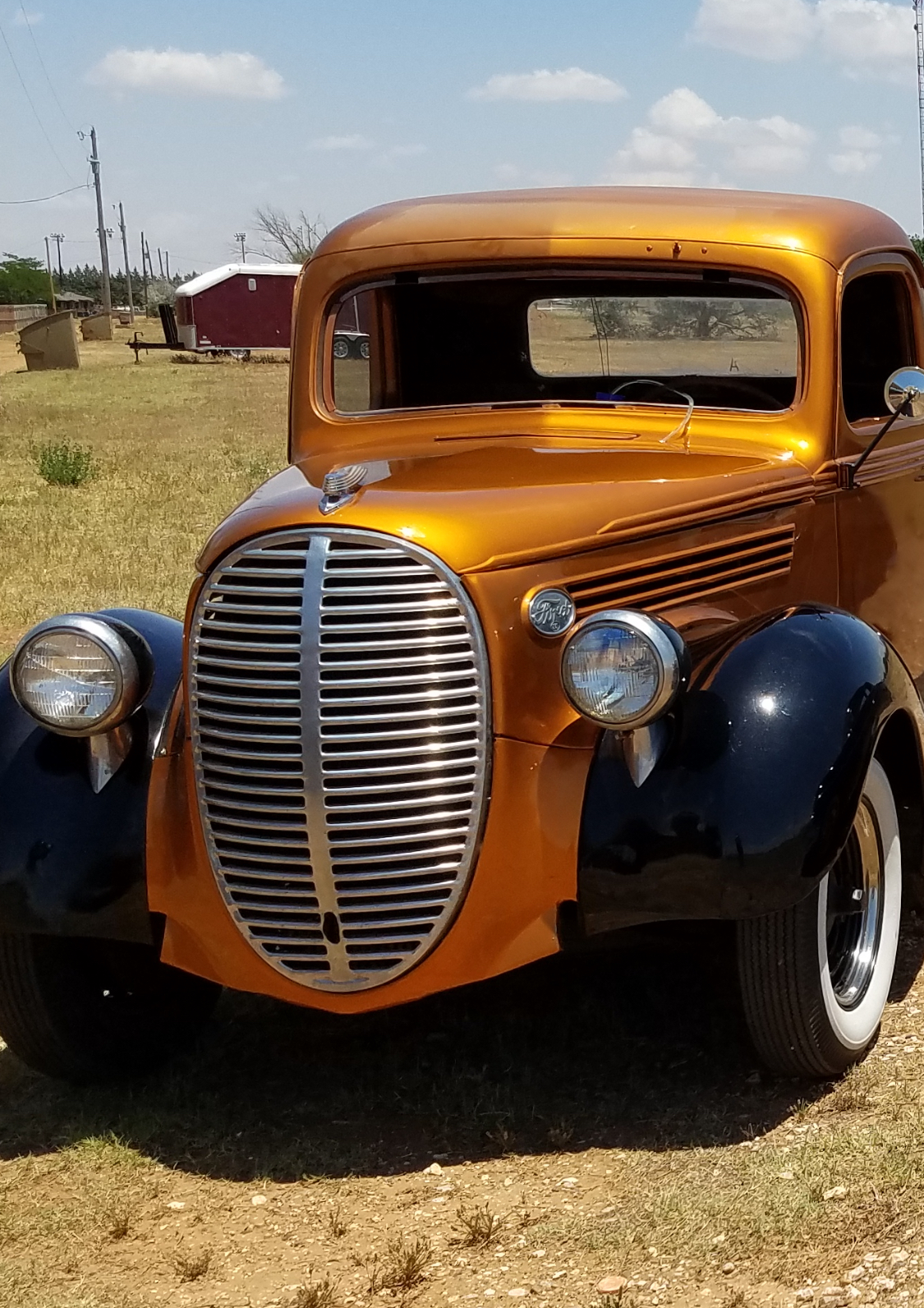

    IMG_5775.jpeg I always thought my grill was chrome. I removed it to replace water pumps and noticed all the overspray on backside. I don’t know what was used but it looked good enough for me.

    Being a hot rodder since 1950 I am well aware of the leading and acid copper deal for repairs. Way way way too many pits for that. The old chrome plating has been striped. Some copper remains. See picture. It will take 5 or more coats of fill primer and lots of sanding. Update. I just ordered a rattle can of chrome paint off the internet. There it looks like chrome. $30.00 shipped. If it fades in a year i will just repaint it.
