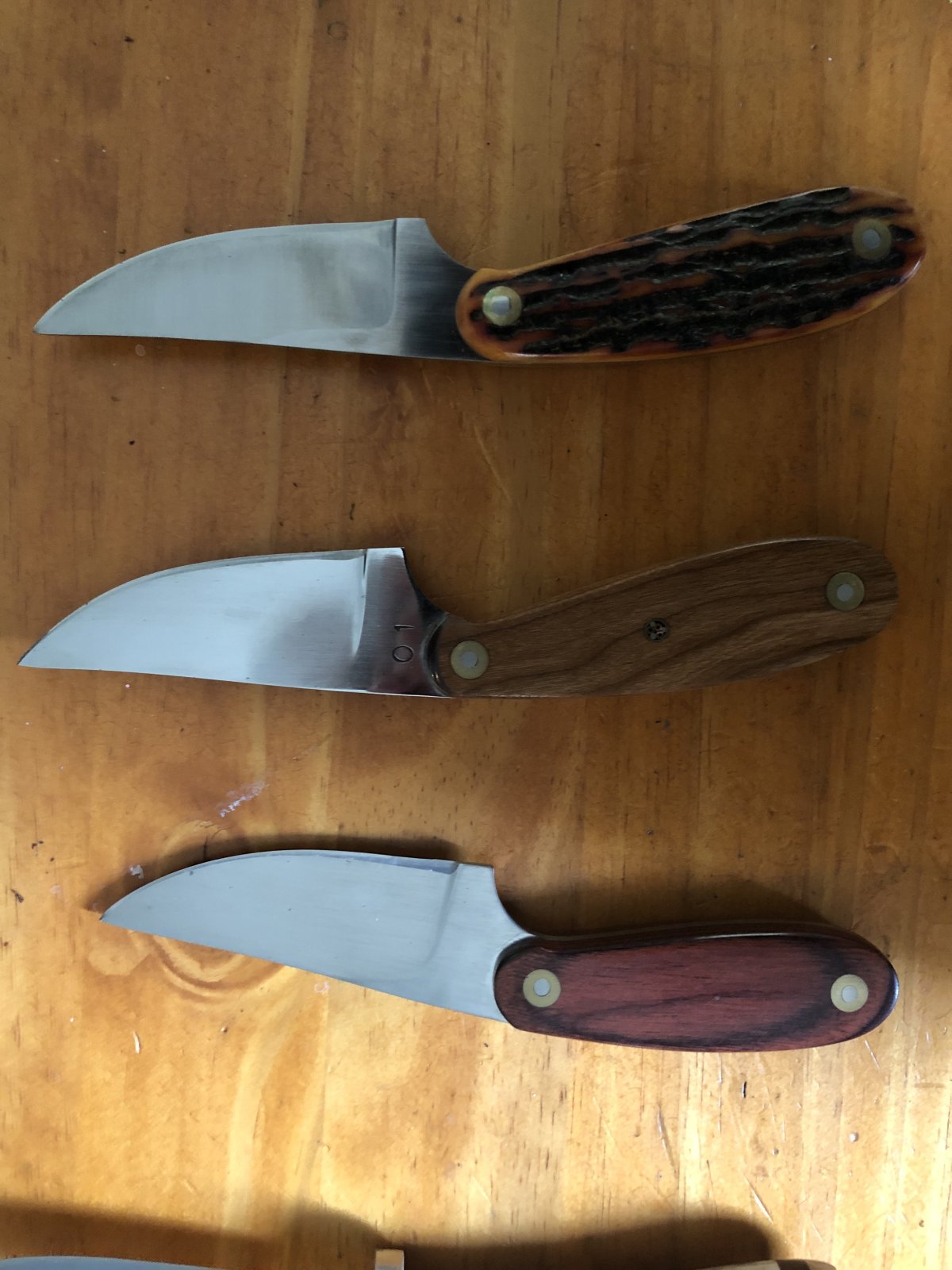

    If you have a smooth surface and can sand and buff out scratches and pits you can buff carbon steel to close to a chrome finish. Depending on how you use the car either a coat of Gibbs oil ( have to revisit and buff frequently) or a clear coat for protection will look really good and is fairly low cost however either process will require maintenance. Some knives I’ve made sanded to 400 to 600 grit and then buffed which white compound. Excuse my photography not the best.
    Dan
