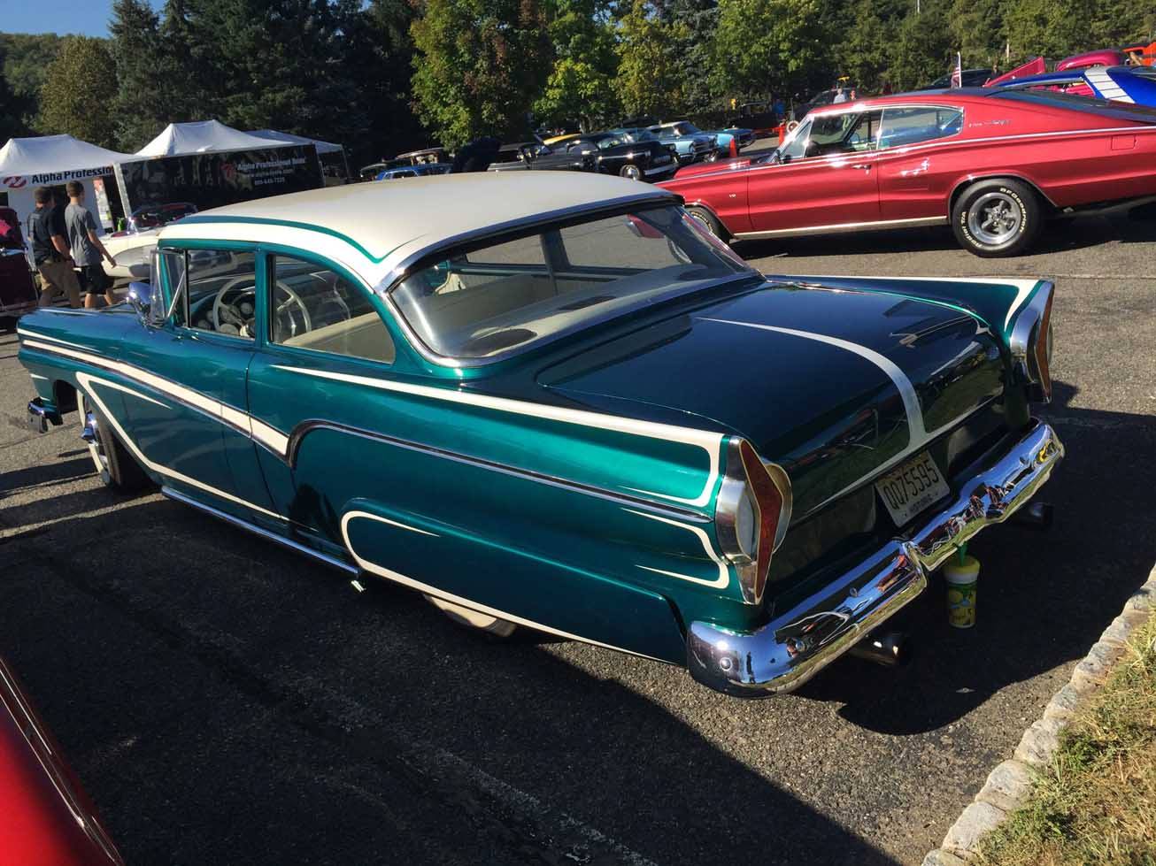

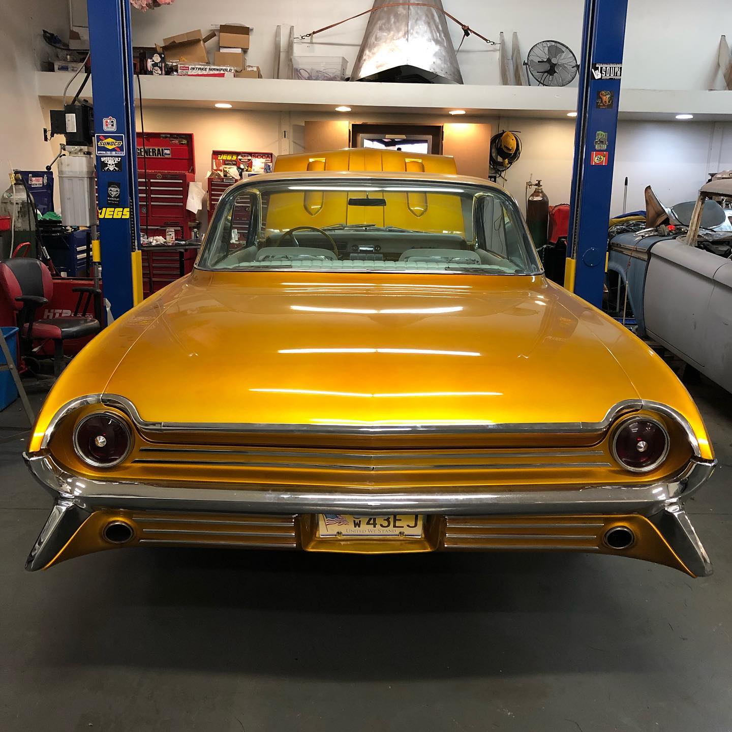

    I'm a bring proponent of spray chroming processes for certain parts but not others. When it's done right it's really more of a mirroring process than paint, per se. It's a great option for smaller parts, especially interior parts that aren't going to be pelted with rocks and pebbles, or very badly pitted parts that are not cost effective to repair to be electroplated. Though there is excellent UV resistance in modern clear coats that help prevent discoloration of the finish, if the parts are left out in the sun, it's been my experience that they will eventually discolor a bit. But even then, if it takes 10 years for the parts to discolor, when you factor in the extreme discrepancy in the price of the spray chroming process and actual pot metal repair and replating, then you can just get them done again and still be way ahead of the game. And while it's true that spray chrome is not as smooth or reflective of a finish as actual chrome, it's significantly better than the alternative of just painting something.
    The tail lights in one of these cars are spray chrome and the others are electroplated.

    It is the last one but it looks good!:D

    You'd be wrong :D
