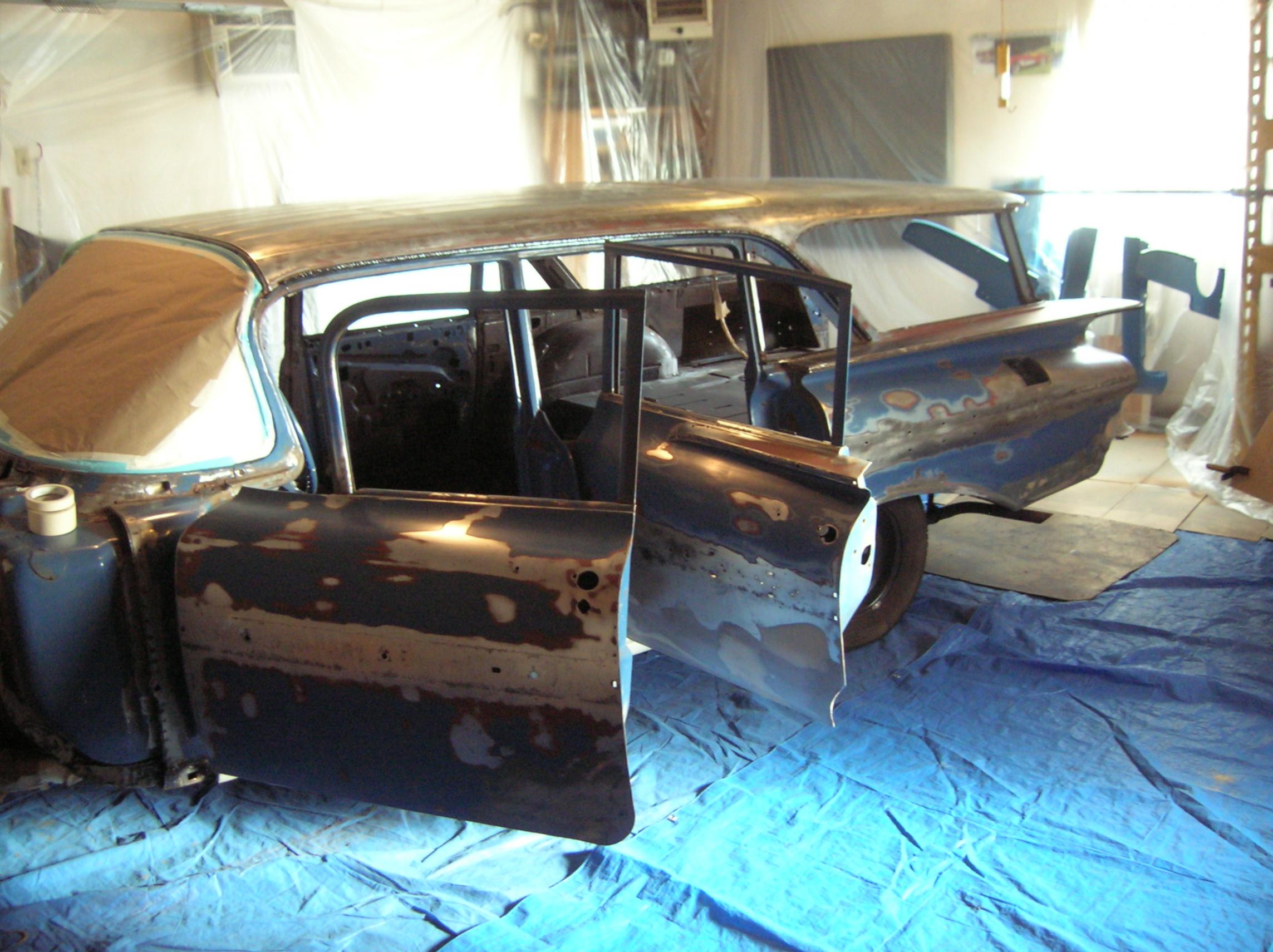

    well, I'm in the process of priming the whole car. here are a few shots of the way i set it up. the DP40LF seems to be doing okay, not real smooth, will try some more adjustments as i start on the main body.
    got it clean, moped the floor, put plastic on the walls and had at it.
    one more part to go, unfortiunalty it is a big one.
    We will see how my plan to keep the car and air warm as the temp has been dropping all day and will be in the 20's in the morning.

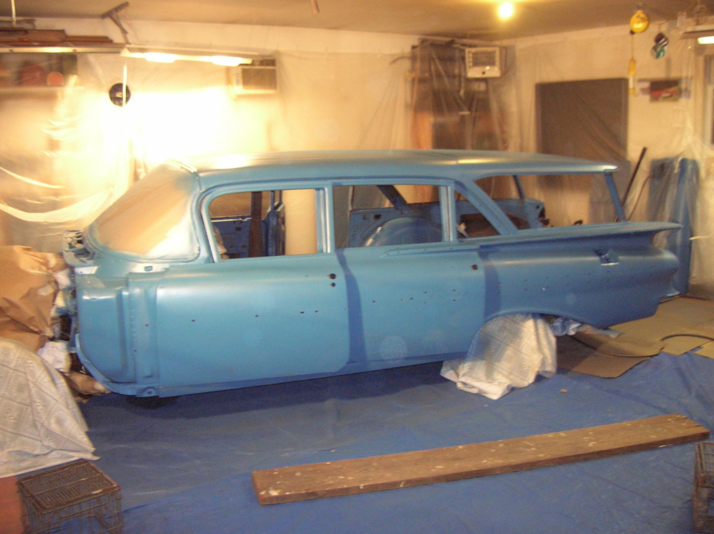

    Bruce A Lyke
    seemed to work fine, will second coat tomorrow.

    Liked it so much I updated my Avatar to the what it looked when the shop was cleaned up after the painting.
