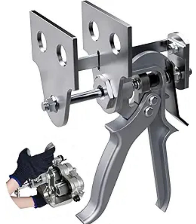

    I'm needing to spread the coils on a '52 Willys Aero just enough to get a pair of hard rubber lift blocks in. Have tried all kinds of knuckle-busting ways to open it wide enough. Have the tire off but not interested in loosening a control arm. I've looked around the shop for something that could wedge or do a jaws-of-life but no luck. Sooo, I've ordered this from azamon (for squeezing a caliper) and hope it has the horsepower to spread my springs just an inch or so. Have you ever had such a dilemma?

  18. That caliper piston tool uses a mechanism similar to a caulk gun, it won't be spreading a suspension coil spring 1", I would either return it or use it for the intended purpose.

    You nailed it, Nick! It didn't have the umph to spread the coils enough. Keeping it, tho, for calipers.
