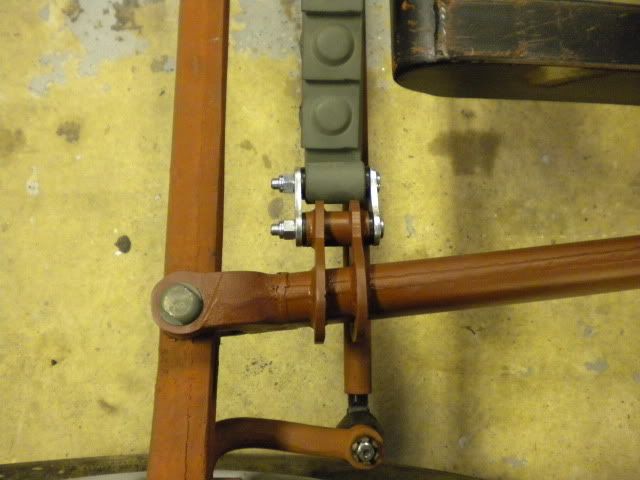

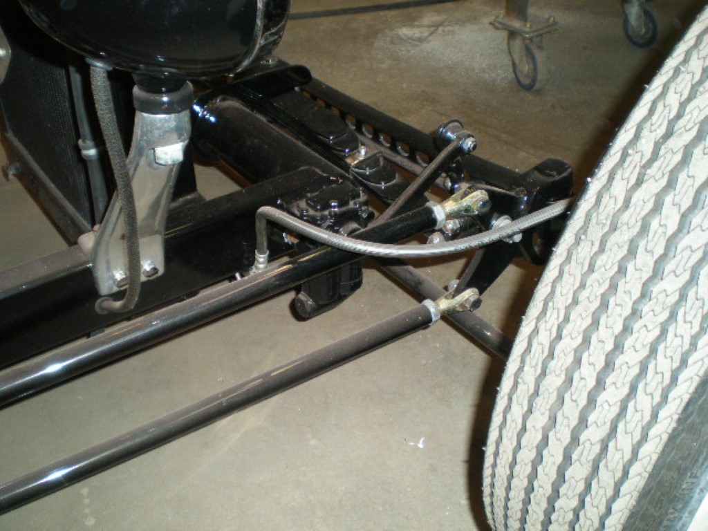

    1. Brackets welded to the wishbone. Can be one or two. I notice RJays sells brackets but as has been pointed out his website clearly states those are for mock up.

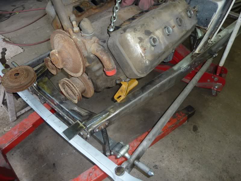

    2. Then there are options for perches bolted through the bones. Some appear to be through the solid part of the front of the bone. On 1st pass that seems like a good idea?

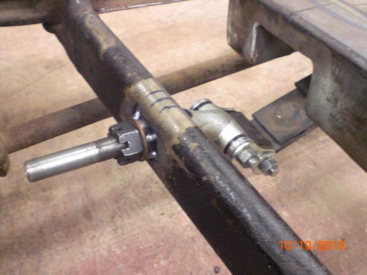

    With perch pins through the bones Ive seen images of that including a sleeve. Im pretty sure Gary from Cornhusker @krylon32 made these sleeves with the taper to match an OEM perch pin. Seems like a very good idea.

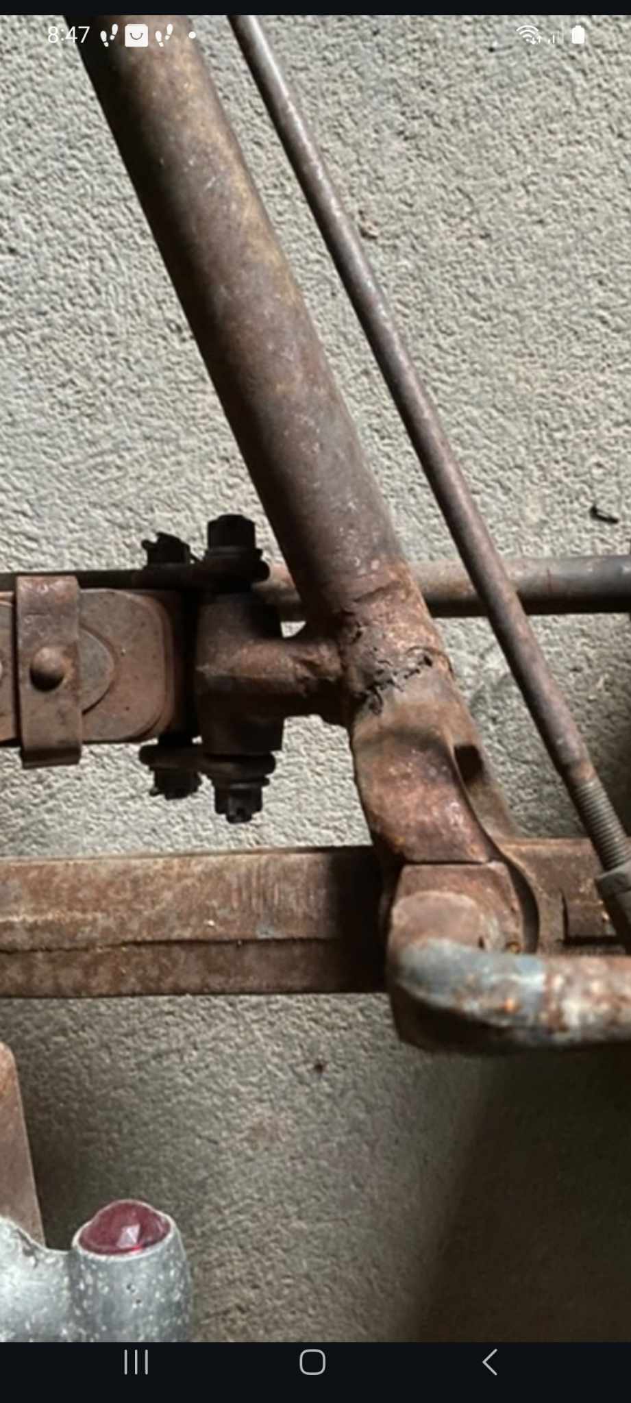

    Not all done well. Whilst it looks like these have been pie cut it sure looks sketchy.

    Keeping the taper and pulling it tight into the taper in the wishbone bung is what gives it it's strength. I've heard of guys machining off the taper but that creates a shear point that is prone to break. I also never weld the perch solid to the wishbone. After it takes a set and is aligned with the spring we use a slotted nut tighten the perch tight and pin it with a cotter key. I did a bones style chassis for my friend Dennis Saum and his deuce 3 window and he has over 50K hard road miles on it with no problems.. One other thing the less shackle angle you have the better it is for the bones. On the spring behind the axle setup I like the shackles to hang almost straight down which takes most of the side thrust off the bones. Spring still works as it was intended. Check hopupmagazine.com and scroll down to Dennis Saum Out Takes to see the finished product. Gary at Cornhusker Rod And Custom

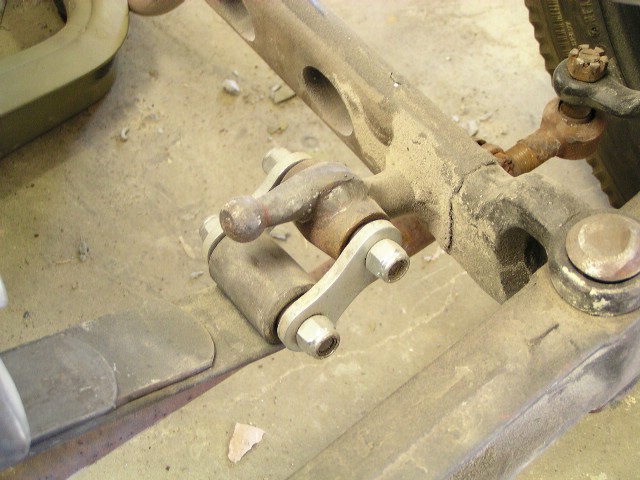

    The double bracket one looks very solid , while the sketchy one looks like you will be in the dirt in no time. !!! I don’t think hanging off the batwing is a great idea with the forces involved and the twisting action on the bat wing, IMG_0166.jpeg IMG_0167.jpeg

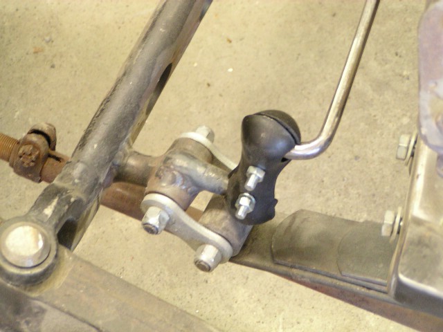

    I've built several spring behind set-ups with hairpins and the spring mounted to batwings I made from Ford axle yokes.
    Never found a problem with them.
    The batwings in the picture were fresh out of my jig and not finish welded.
