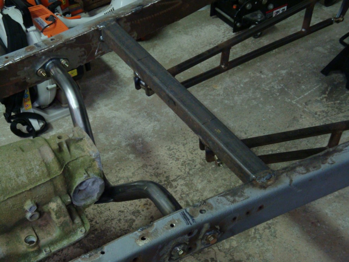

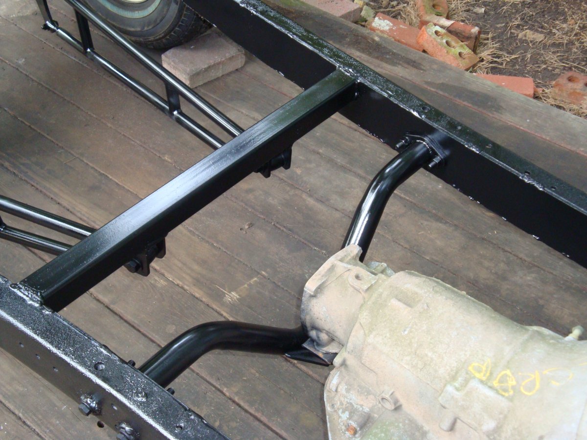

    The dimension for 35-48 Ford rear axles is, 7-1/2" from the axle center line, to the center of the spring. If you go with the A spring, you will give up trunk space, but the quick change option will be there. This is one I did , sorry I didn't have a better picture. I would use the standard 7-1/2" set-back, regardless of the spring or rear axle you choose. IMG_5641.JPG

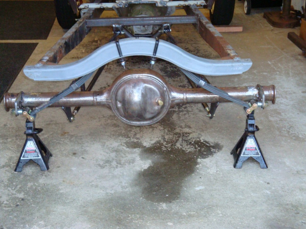

    I extended my A frame to accomadate a Posie 35-40 spring hanger kit to put the spring (a speedway Medium arch spring A type) behind the axle ( a 9" early Bronco, approx 52" from Backing plate flange to flange) It was tight but I made it fit and made my own rear radius rods that wer angled to the center line of the frame (I gusss about 10-12" spacing) I would have "Z"ed the frame if I had thought about it a little longer to gain an additional 3 + inches of drop. See photos DSC00601.JPG DSC00601.JPG DSC00585.JPG DSC00585.JPG DSC00585.JPG DSC00585.JPG

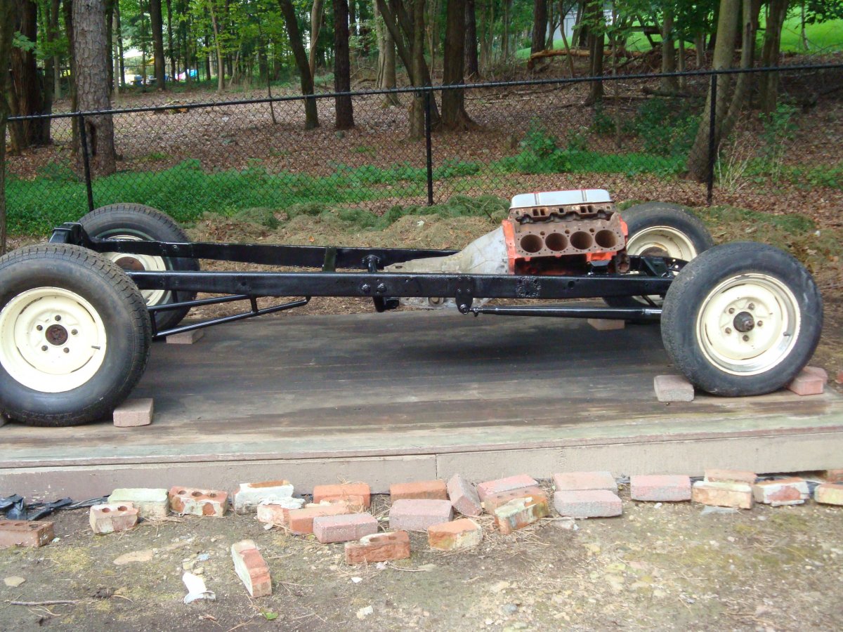

  15. fenderlessA

    Gimpyshotrods, how much of a kick up is that in the rear? That sits nice
  16. gimpyshotrods
    Joined: May 20, 2009
    Posts: 24,629
    gimpyshotrods
    Thanks! I think 12". I would have to dig up the blueprint.

    Isn't the lower arm of a ladder bar supposed to ride parallel to the ground?

    From your picture it appears that your spring hangers are way too close together, spring should be under a fair amount of tension with no weight on it.

  19. geoford41
    Joined: Jul 26, 2011
    Posts: 767
    geoford41
    from Delaware
    car & frame went down the road 4 years ago, the narrow Bronco rear forced me to mount the hangers like that, I believe the radius rods/"traction" bars are pretty close to being parellel also Had I finished the A coupe a shorter main leave could be fitted and with full weight on the frame I would have had a better handle on it. The guy who bought the car has it almost on the road but has not e=mailed me since completion
