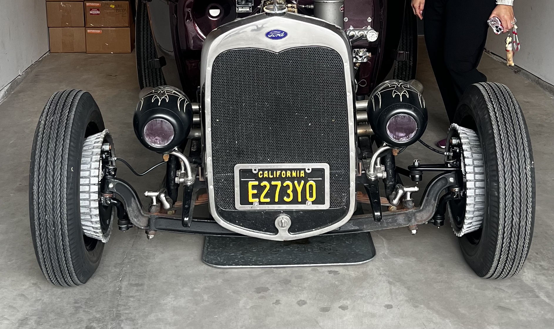

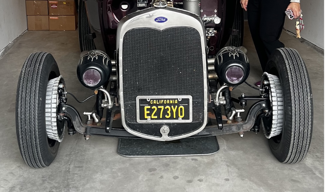

    It doesn't make a damned bit of difference if it was built in 1957 or if it was built last winter as a rat rod. and it doesn't matter how much it was driven crude and suspect work is crude and suspect work that as others said may fail and cause an accident and kill someone. You need to loose the at***ude and decide to repair it correctly rather than ***** and whine because several experienced rodders pointed out that it is not done right.

    Out of curiosity, what are you replacing, and what are you going to do to correct all the mistakes shown in the photos of that front suspension/steering? There's nothing in either of the two you posted that show anything salvageable. A new axle, perches and used crossmember aren't $15K either...

    A used A axle is $50, new forged (not cast) perches are probably $125, and a good used A crossmember is $100. Might be able to reuse the hairpins if you can find a pair of batwings that fit them.

  8. I can't help but notice a little sarcastic hostility in your responses. You came here for help, and you did receive said help. The best course of action is to do what was suggested to have a functional and reliable front suspension.
    I personally cannot give your setup any sort of validation because it was built using bad practices, and survivorship bias because it's been ***embled like this for a long time is not a replacement for sound engineering from the early Ford Motor Co.
    This is not an attack, this is me sharing 21 years of experience of doing this in my garage for myself and others. I learned how to do this by asking questions like you have done and applied that knowledge to my first ground up build back in 2003. I attached a picture of my own vehicle to show what I and others are talking about, nothing is welded to the axle forging, it is all bolted together as intended and all of the dimensions for the perches are where they need to be as a result. I have driven this thing all over the place and it drives as well as any 93 year old car can. You can do what you want but it really is not recommended to continue on the same path. Best of luck getting it sorted out. IMG_2705.jpeg

    Dig out the ole angle grinder and "clearance" the axle itself :eek:
    One other option is to do it right and remove/replace the previous butchery that you are now choosing to work around o_O:rolleyes:

    IMG_2265.jpeg Got a little bit of positive scrub built in there!

    More like a whole bunch ...

    How’s that car turn/ect? Just curious.
    I mean does it feel normal?
    gimpyshotrods likes this.
  15. Turns pretty well even with the wheels pushed out a bit as others have pointed out. Those tires have been on there since 2007, so looks likes its doing alright even being a little less than ideal.

  16. You're going to get the best help and advice on the internet right here on this forum. Don't let thin skin hurt your feelings. Even the toughest rooster in the barnyard has to pick his corn out of the **** the same way as the little peeps. Everybody on here had to p*** some kind of smell test. Respect isn't automatically given. Surely you understand by now that your front setup is a train wreck and you are being judged guilty by ***ociation to some degree. Maybe that's not fair or maybe it is.
    But I ***ure you that the guys who are giving you the most flack also love to see another mess saved and another owner with an at***ude to build it right. That's how heroes are made around here.

  18. Yes they do, thanks for letting them go to me. Now if I could just get the right part number for the wheel studs I can eliminate the wheel spacer thats causing my scrub issue. The part number I procured right here on the HAMB allowed too much of the shoulder to poke through the hub which let the lug nuts bottom out on said shoulder and the wheel was just wobbling around.
