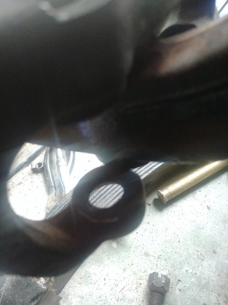

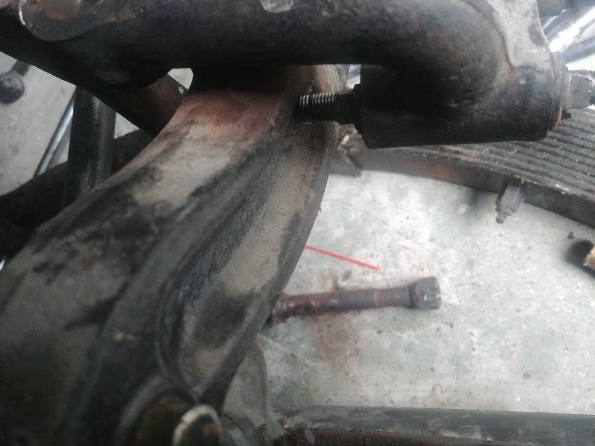

    The axle is free, but it will not fit between the lower wishbone mount, and the pin for the spring shackle. Stand by I will grab a picture.

    20181008_144445_HDR.jpg 20181008_144514_HDR.jpg 20181008_144445_HDR.jpg 20181008_144514_HDR.jpg That should clarify..

    You are probably going to replace the shackles anyway, right? Can you press the shackle pin out?

    Took a seccond approach and got it!

    Ran into another issue now..
    Axle will not physically fit...

    Got the axle out arround the pins. But I have encountered a much larger issue.

    Out comes the shackle pin......
    Most guys using a tube axle would probably replace the shackles with some urethane-bushed kind anyways.

    Once you remove the shackle bolts and bushings and clean the crud off the axle/'bone mating surfaces you should be good to go.

    When i was playing with it. It really didnt look like if i had the pins out the tube axle would fit. But I will give that a shot this weekend.

    There will be a tin sleeve that needs to be removed along with that pin and rubber before you can put new shackle bushing in

    Thanks guys! The kit did come with shackles (D'oh). And the bushings/sleeves came right out with 2 sockets and a C-clamp..
